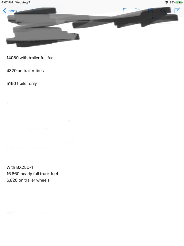

With the GVWR of 14k, I have over 5k payload capacity left, on the truck.
Here痴 some actual weights:
You can see with 10-15% tongue weight, on a sub 9k truck (8,880 lbs with me and tools and full tank of fuel), the truck can easily handle the weight of over 10k trailers, if properly loaded.
Yes, the RPM痴 will go higher, when traveling up hills, but it is an over square engine-made to rev. It痴 louder than when in sixth, going down a hill, but not prohibitive. Fuel mileage does suffer. My main trailer is a low profile dump trailer, there is minimal wind resistance. I知 sure I wouldn稚 be singing my truck the same praises, if I was always towing a large fifth wheel, in the mountains.

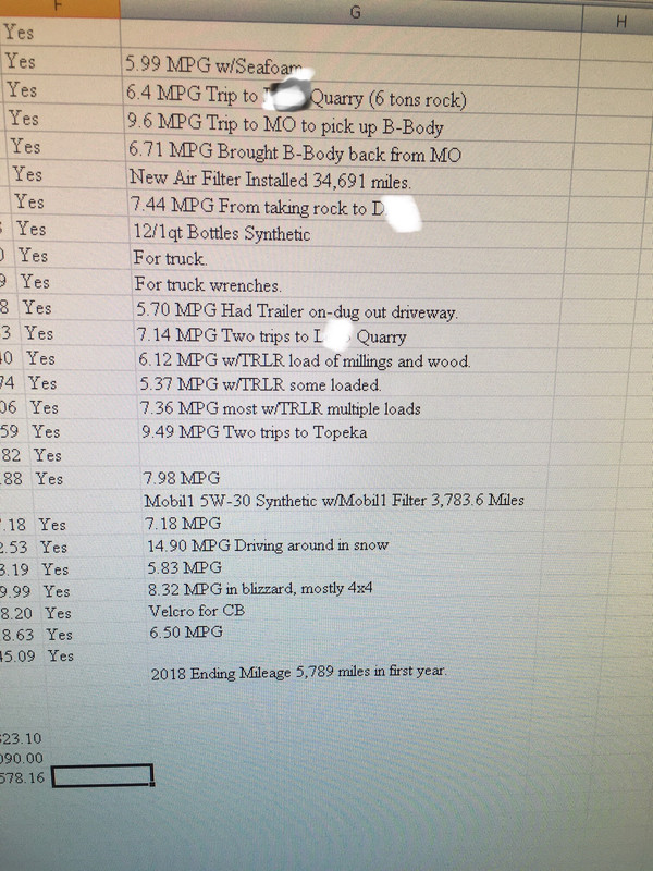

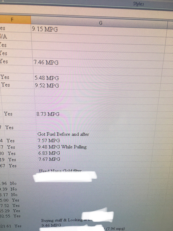

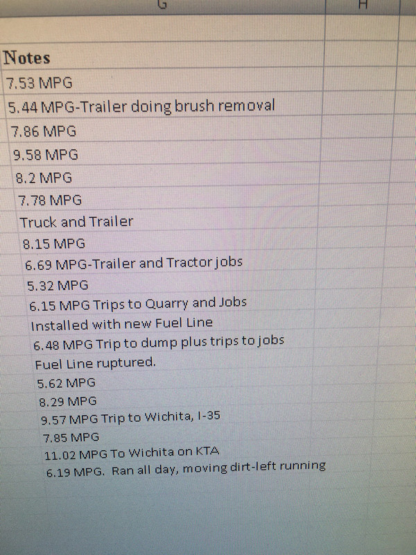

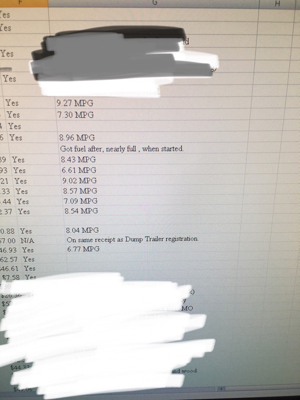

so for the 6.2 what are you getting mpg empty and towing?
Here痴 some pictures of my actual mileage. Anything with the trailer is marked. The B-body to Missouri is With an empty car trailer there and added a 1995 Roadmaster wagon, on the way back.

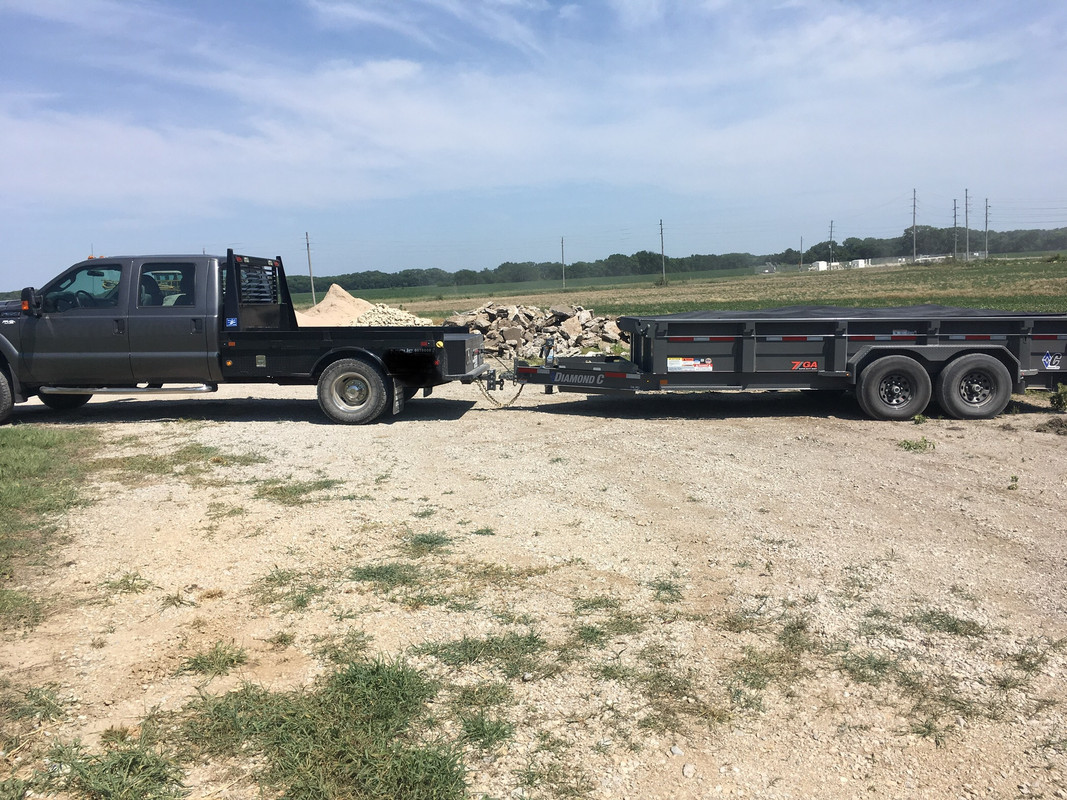

Picture of the truck and trailer:

OUCH on the mileage our old 460 did better than that empty - thats similar to V10 mileage and my old 85 windsor H.O. and those both only had a C6 with no O/D
I dont think i could take it watching my fuel gauge go down like that i would have an anxiety attack
