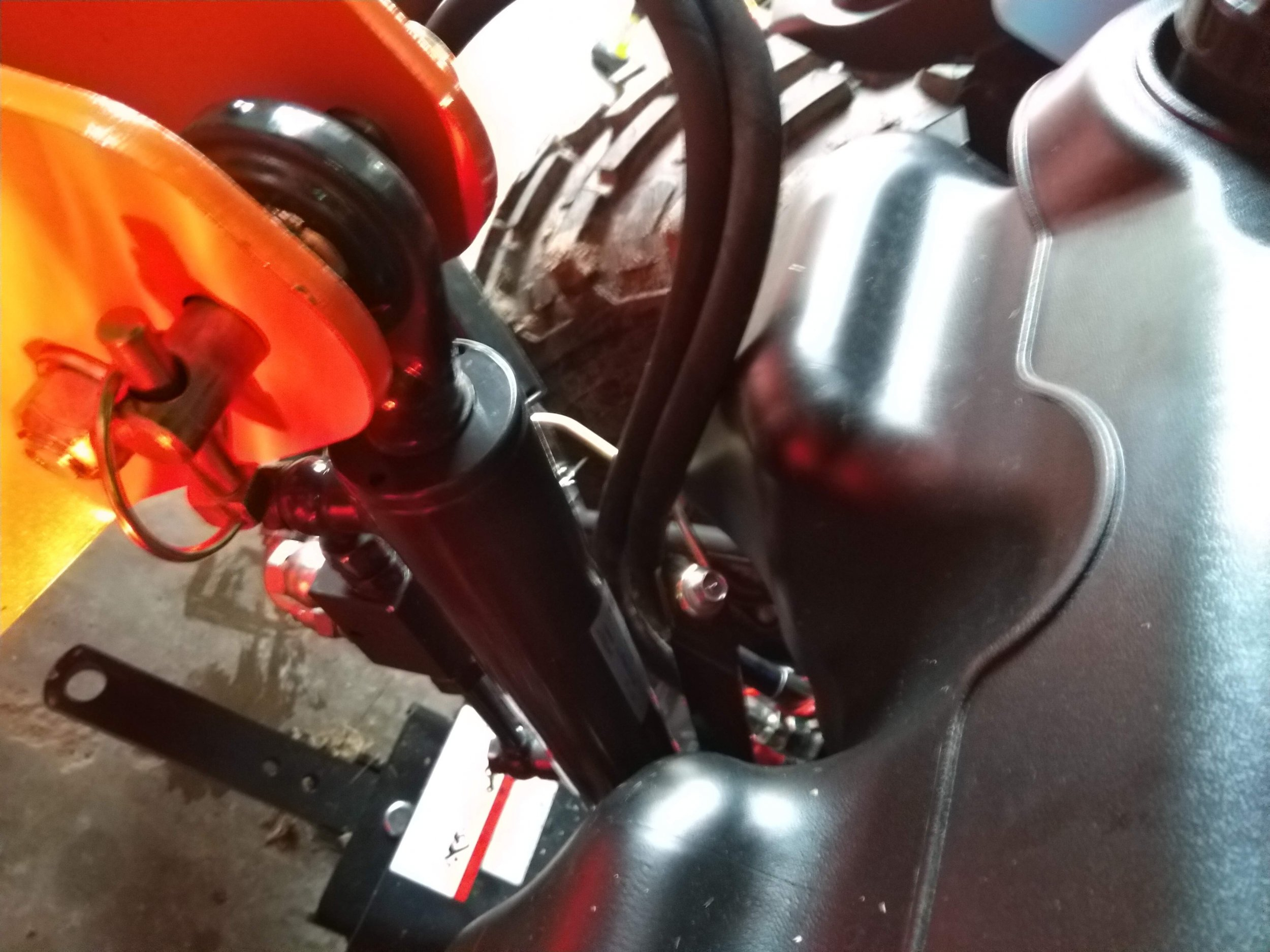

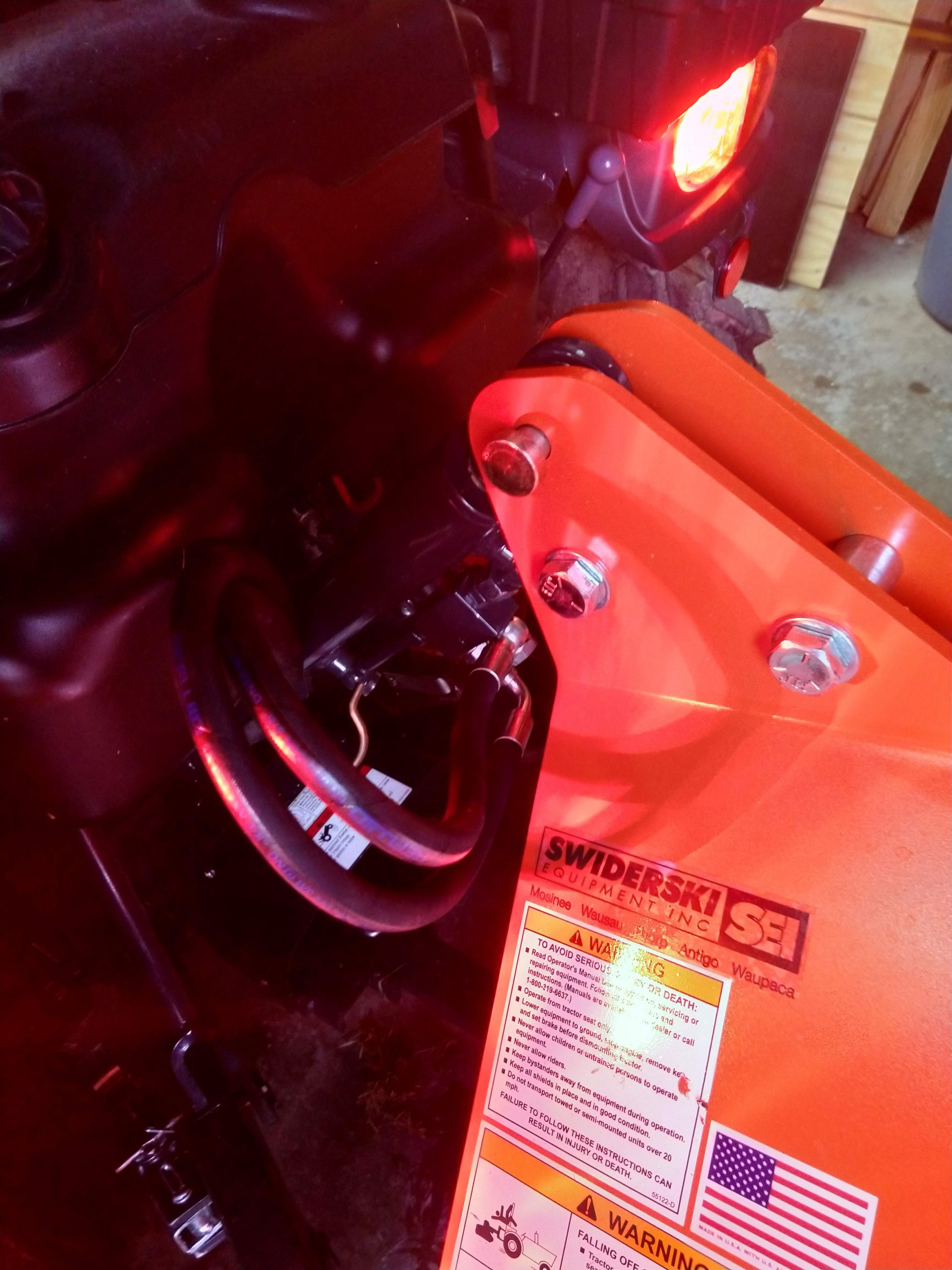

#32
I flipped the top link over and the clearance is much better, also rotated the hoses to come out the side more. Now no matter if it's fully extended in or out with the 3pt fully up or down nothing comes close to touching. Also it isn't anywhere near the pto as a bonus.
   / New CK3510SE-HC #33
Put some .030 flow restrictors in and the jerkiness will go away. ;)
