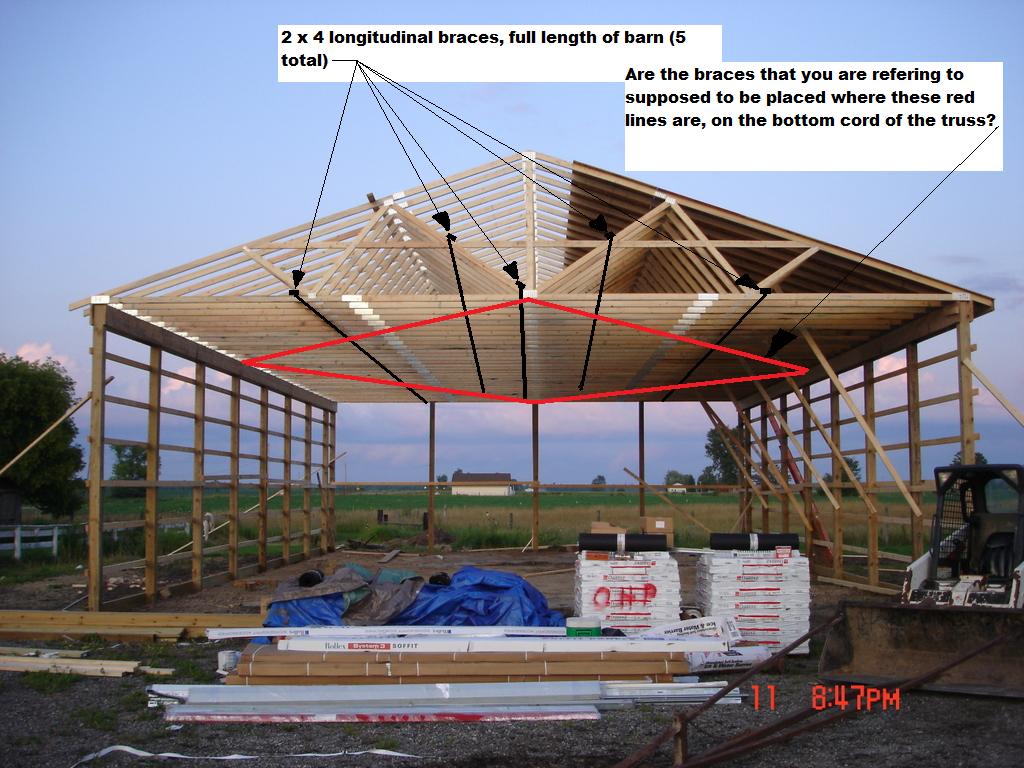

My trusses are on 24 inch centers and the roof deck is sheathed with 1/2" OSB. I have 5 longitudinal braces that run the full length of the barn that feed the horizontal forces directly into the vertical poles at the far end of the barn at the quarter points of the lower chord. The poles are attached to the top of the trusses at the roof sheathing and burried in the ground 4 feet so a horizontal force on the outside wall at the bottom chord of the truss will try to bend the 6 x 6 vertical pole and will have to deform the roof sheathing because the top of the pole will carry that force up to the top chord of the truss, and that is braced with the roof sheathing. Is this strong enough or do I need the braces shown in red on my picture?

Like in the drawings below?

First off your structure is superior for strength to the one I was looking at and discussing. Not that the other isn't fine with a little tweaking, you just have tight truss spacing at 24" and direct applied sheathing so that roof plane has excellent shear capability and superior resistance to uplift. Somewhat unusual for a pole barn. Now I'm going to appear to countermand myself but it's because what I'm seeing is different. You would be OK using just the longitudinals and some gable braces unless you are in a high wind area IMO. That roof has the stength to impart back down to the bottom chord plane in your application and hold the gables. Also your spans aren't too huge. There is another structural benefit to the diagonals though I'll spare us for this post other than to say they add some additional rack strength to the box and your wall height makes me think I'd still do them. Duffster's way is fine on this one though.
Should you want to use the diagonals on the bottom chords for added strength.....The (RED) braces in your photo are in the correct general orientation and can be on top of the bottom chords (where I generally put them). However, they don't need to make the center point on the gable (shouldn't really) and and they sure don't need to run all the way to the center point of the structure. When you top mount them you have to clear compression and tension members in the trusses so your placement will be dictated and limited by that. In your application you could bottom mount too and put them excactly where you choose. Ideally they would tie into the gable near the 2nd and 4th longitudinal braces but even that isn't critical. Generally you want them to break the gable into three near equal spaces and you just angle them back to the exterior long wall at something roughly in the 45 degree range (ain't critical we are just making a triangle). Lets say a 14' diagonal 2 x 4 gets you about 10' over on the gable and 10' back on the long wall. That would be great for spans in the 30' range. Wider just needs a little longer diagonal and you can break the diagonal up into two side by side lengths on very large structures but you need some overlap (they can overlap side by side if well nailed to two or more trusses and to one another at the overlap). By the way, that is one nice looking structure.

Thank you for the information. My barn is 40 x 60 x 14. I am planning to install an OSB ceiling in the future, that should stiffen things up a lot. Meanwhile I think I will add the diagonal on top of the trusses as you suggested. I have some rather long 2x4's that were used as temporary wall bracing that will be ideal for that application.:D:D
They are already paid for and just taking up space in my other barn:cool:
Then I am going to build a 7 foot tall mezzanine and storage deck 12 foot wide and a full 60 foot long along the south wall. so that deck will stiffen that wall considerably.:D:D:D

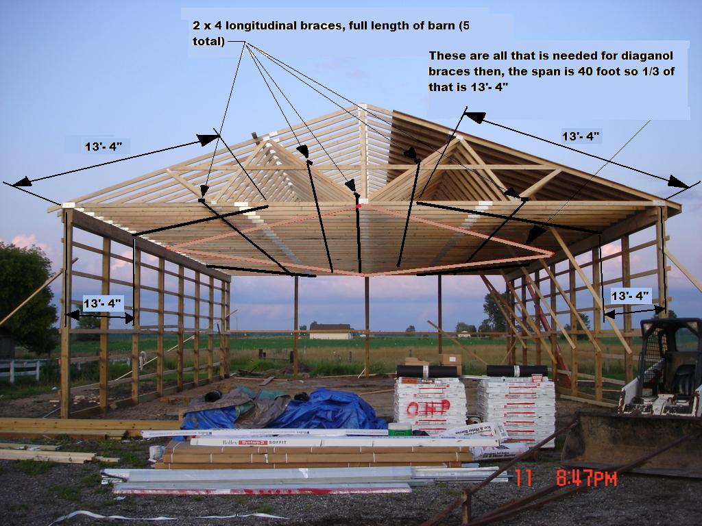

The plans are suppose to be back from the PE today. I know that I am going to add additional bracing if they don't do it. I would imagine you cannot have too much. The picture with the red markings really helped understanding what you guys were saying.

based on what bugstruck said I think this what it wants to look like, breaking the gable into 3 equal parts....:cool: Your dimensions will be different of course if you span is different..not real critical:D:D
