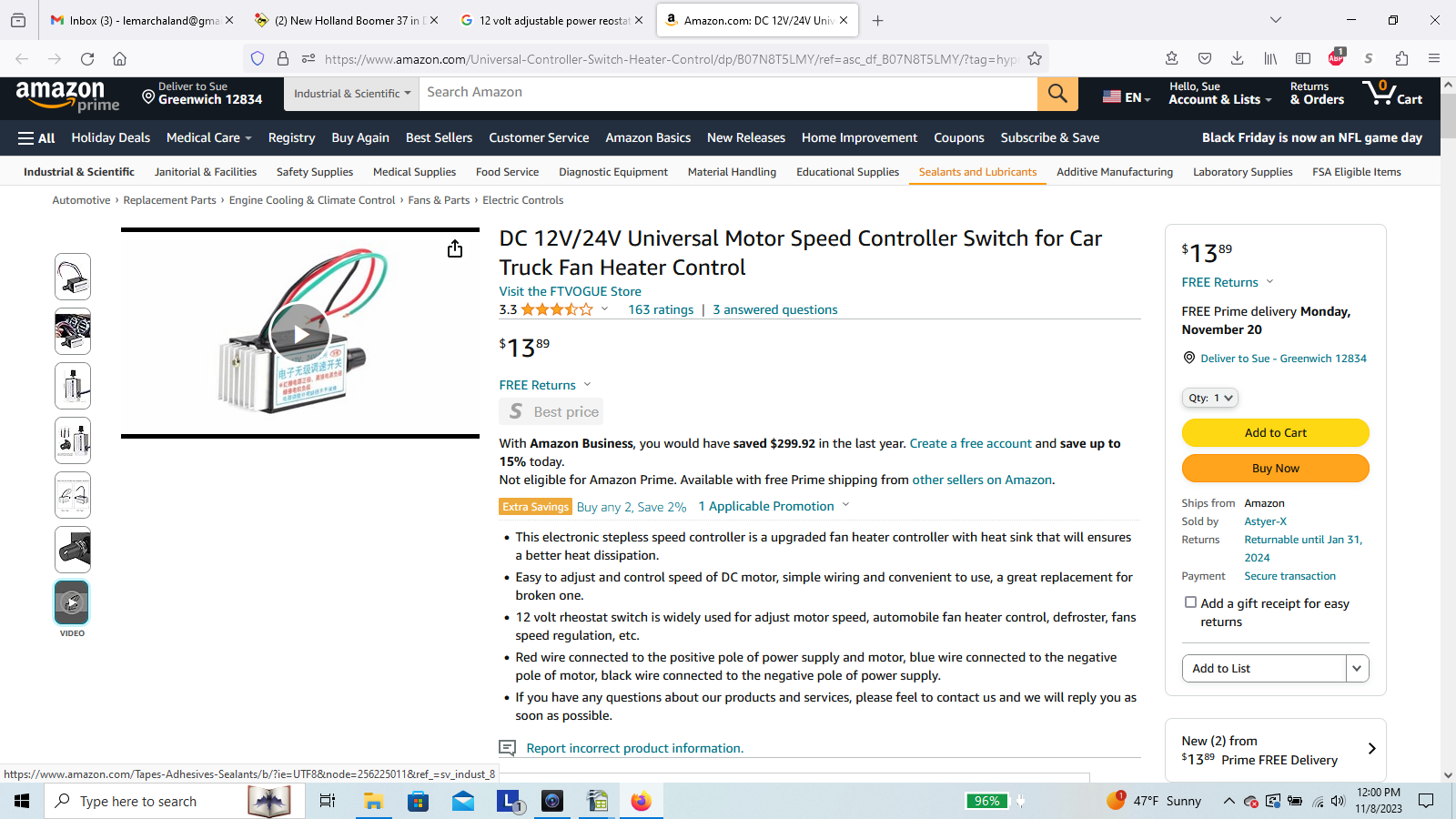

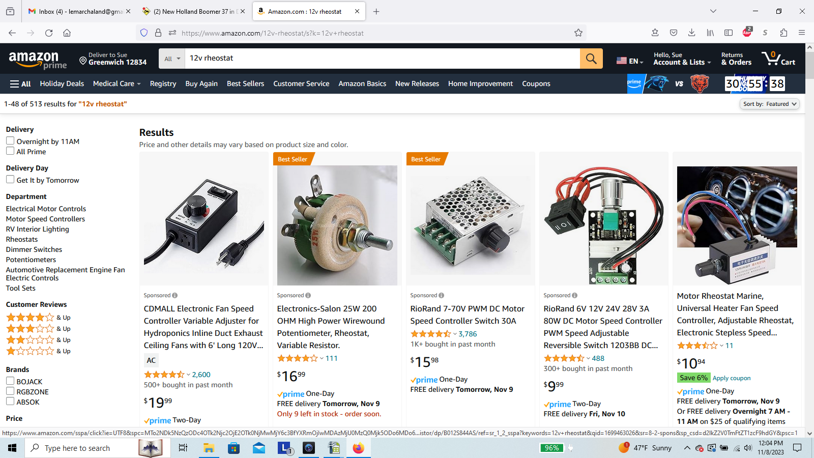

Have you checked the current output of your hand and foot throttle?
It could be a variable 1 to 12 volt, or a 1-5 volt signal.
Also you could use something like this,
lots to choose from;
   / New Holland Boomer 37 in DPF Shutdown Mode #86
LouNY, thanks for the ideas. Maybe before I attempt to make a throttle control in place of the solenoid, I could check the output of the dash throttle trying to find its power source and just wire power to it and then when directly out to the solenoid and see how it reacts, this is because both the dash throttle and the foot throttle are both "potentiometers" almost the same thing as the motor control. It would be nice to leave the solenoid in place and use another electronic controller for throttle instead of making a manual rod or cable control, I will have to check the service manuals wiring diagram. But Ill keep your ideas in mind. Thanks much.
