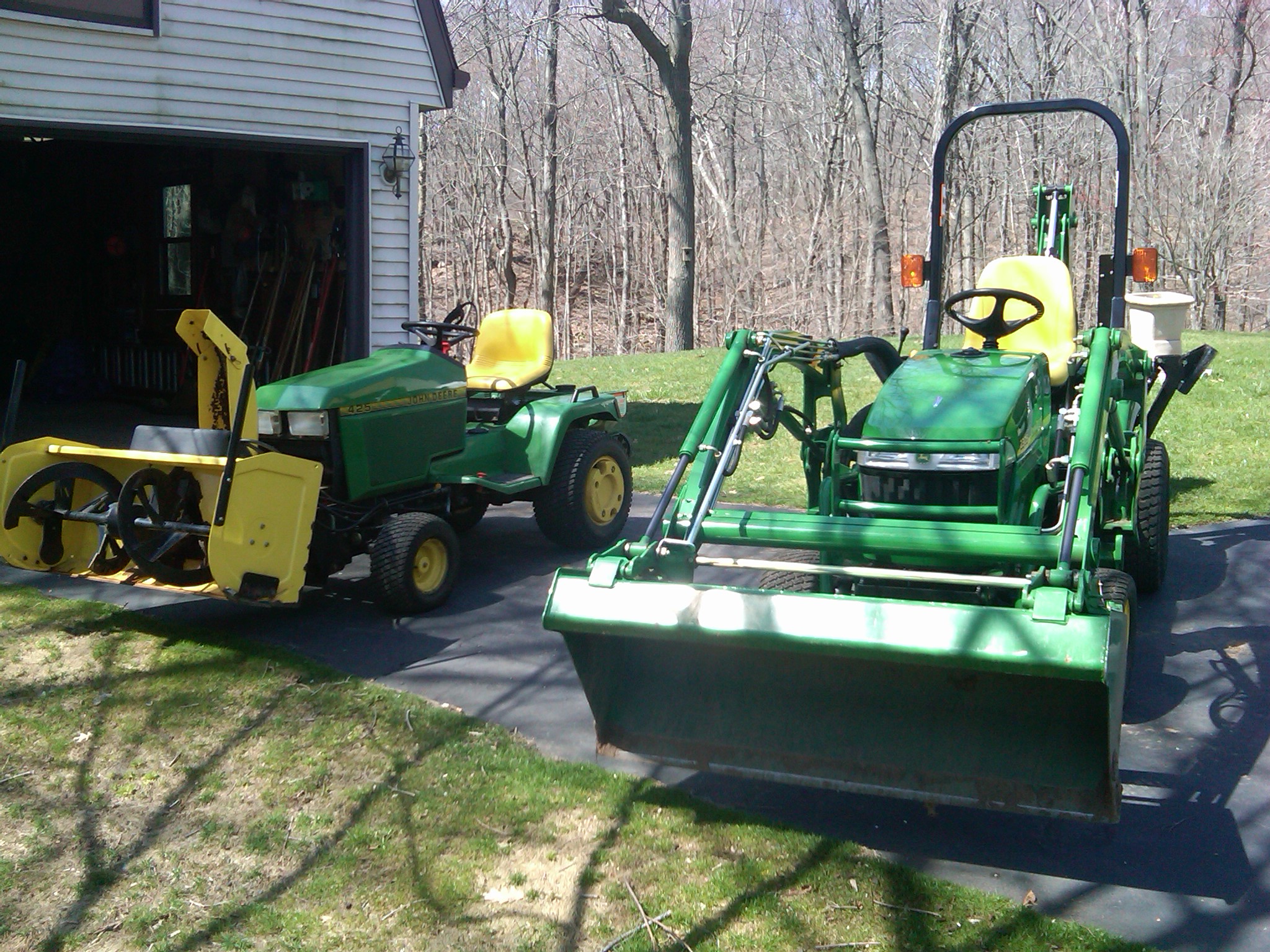

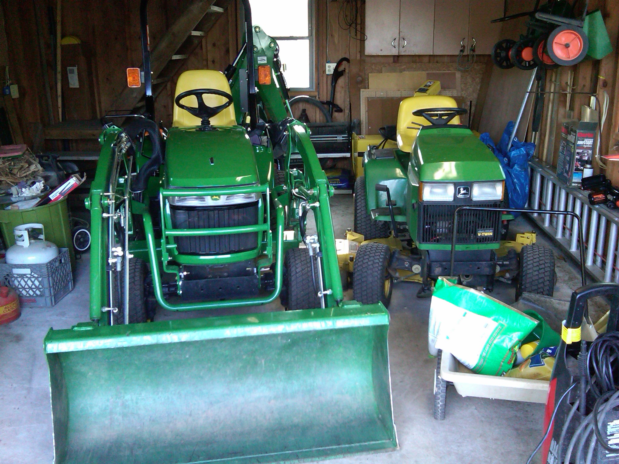

John M. I was able to push the hoses up so they arent nearly so close to the ground. I am a little hesitant to fill the tires with fluid since we plan on mowing with this tractor most of the time. The machine is already too heavy on the lawn (then again we havent taken off the FEL or BH yet which would shave 1,000 lbs). Someone told me that the 425 and 2305 use the same wheel weights. We already have the weights for the 425 and 6 suitcase weights that hang off the back. I just dont like how the ballast box extends so far off the back of the machine on the 2305. Maybe If i got ahold of a 1" or thicker 2'x2' steel plate that I could weld 3 pt mountings right to it, it would give me the ballast without adding 2 feet to the length of the tractor.
Well we finished the stump grinding on Sunday morning. We then headed next door where our neighbor had 7 stumps to be removed. We finished pretty quickly and the neighbor was more than grateful so he paid us more than the half the grinder rental that we agreed to previously. I returned later to earn the difference he gave us and raked up the chips using the 2305 as a power wheelbarrow. I took 3 heaping FEL buckets full of chips back to the house to be rototilled into the garden. After removing the chips I finally got to use the FEL to its full potential when I attacked a long abandoned pile of topsoil to backfill the stump holes. The bucket bit into the old pile with no complaints and no wheel spin. After being somewhat disappointed with the lack of power from the backhoe the previous day, the FEL proved to be worth every cent paid. I just wish that the hydraulics were a bit faster and allowed more than 1 movement at a time (after emptying the bucket I wish that it would allow for the bucket to be lowered and tilted at the same time.) Not a big deal but if I was moving lots of materials the time savings could really add up.
The grinder was loaded back into the bed of the diesel without any of the same hoopla from the previous day.
I cant wait for the modular concrete retaining wall block to arrive so we can utilize the tractor for the main project for which it was purchased... replacement of the 225 LF of PT lumber on my mother's raised garden. Not only will the 2305 come in handy for moving the block around but the plan is to push the high wall side (3' tall) back 6-8 feet which will requre the use of the FEL to remove the raised soil down to the existing grade in that area.

The 425 we have with the 47" snowblower is very impressive. We have 6 x 40 lb suitcase weights and 2 x 45 lb wheel weights on it, and traction is only an issue on our 20%+ grade on our driveway. When I am around I usually stand on the suitcase weights adding another 210lbs, but I dont live at home anymore so I just figured it was time for the old man to invest in something that he doesnt have to work as hard to accomplish) I just figured that with the 4wd of the 2305 that traction wouldnt be much of an issue since we can usually get up the driveway now with the 2wd 425 with a little sand and speed. (Since the house is at the top of the driveway we fortuanately have made a pass down the driveway which we can utilize getting back up).
I might look for a small salt spreader for the back of the 2305 instead of a ballast box. Might as well make it useful weight!
