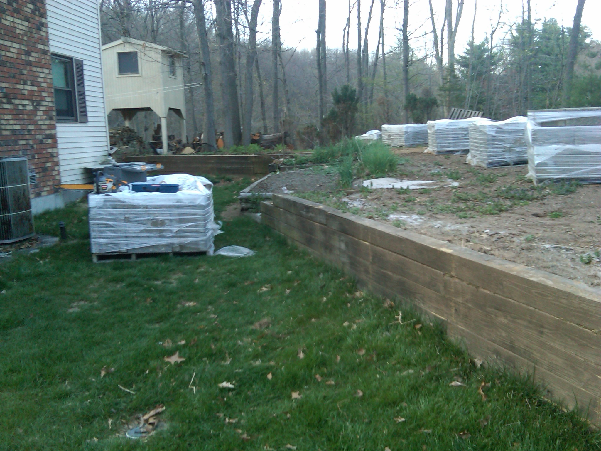

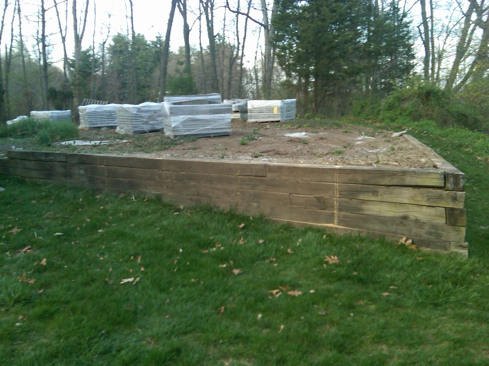

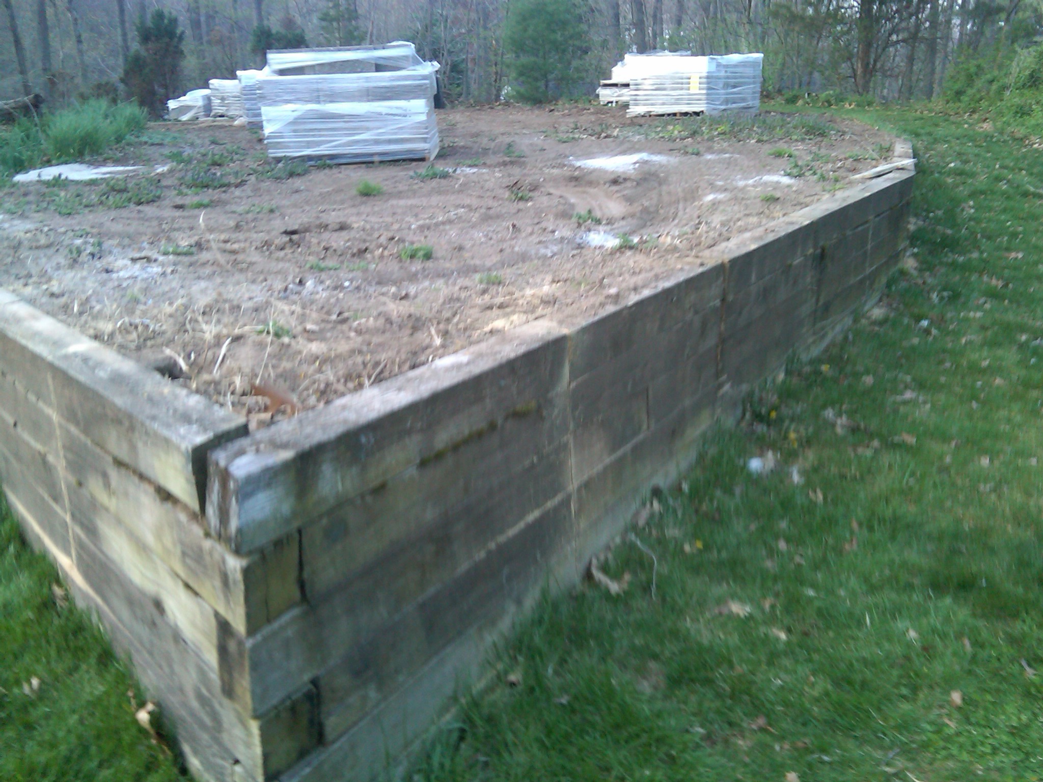

Well we started the destruction...I mean...construction last night. Below are 'Before' pictures. The only thing we did prior to when the pictures were taken was that we cut the #3 rebar that was inserted in the top of the wall every 8' that held up metal garden fencing. I dont know if you can tell but my father precut the wall with a circular saw every 4' (Picture 3). Even though the saw only got about halfway through the wall when the guy delivered the block with the piggyback forklift the weight of the machine near the edge of the inside of the garden wall was causing it to flex worrying my father of a possible premature failure.
When I arrived at the house I took a sawzall and prededed to make the cuts approximately 2/3 of the way through the wall at the narrow point of the wall (foreground in pictures). Since we still felt this wasnt enough my father fired up the chainsaw and preceeded to cut nearly all the way through the wall until the chain was dull (approximately 3 cuts) because we somehow found 2 spikes and a bit of dirt.
I then proceded to fire up the 2305 and head over to the point of the wall. Our plan is to remove the wall as neatly as possible then using the FEL scoop the dirt up and dump it further inside the garden to remove that fairly unusable part of the garden. Backing up I grabbed the point of the wall with the BH and began tugging. That little BH has some serious power for such a small machine! While tugging I was moving a good 12-15 feet of wall on either side of where I was working! Later I was able to carry a 16' 6x6 using the FEL like it was a large cigar by hooking the end of the timber under the top lip of the bucket. The wall, however, did fight back and progress was slower than i expected but we were able to remove 8 feet of the wall facing the house (left side of the point) and 12 feet of wall to the right side of the point by the time we quit at 8:15. It would have progressed faster if we spent more prep time cutting the timber. It was just too dark to work or take any pictures when we quit (sorry). Maybe I'll get some shots before starting work again.
Just before we quit for the evening the left joystick on the BH controls began to stick in all directions and would not return to the neutral position making it very dangerous for my father to be standing close to the rear of the 2305 to give me directions on how to grab the timber. Anyone have any ideas as what was causing this?
