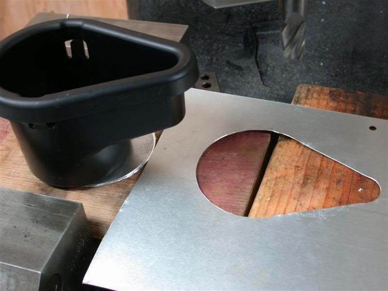

Got back up to 3R and checked the mail box.
Ken sent me the very nice Kubota cup holder like he promised.
So this morning I decided to get Loretta out there to see where she wanted it mounted... Bad idea! I was thinking of cutting a hole in her fender or somewhere but no, she wanted it next to her seat on the left side because she is a lefty. OK swell, so now I had to make a bracket for it too.

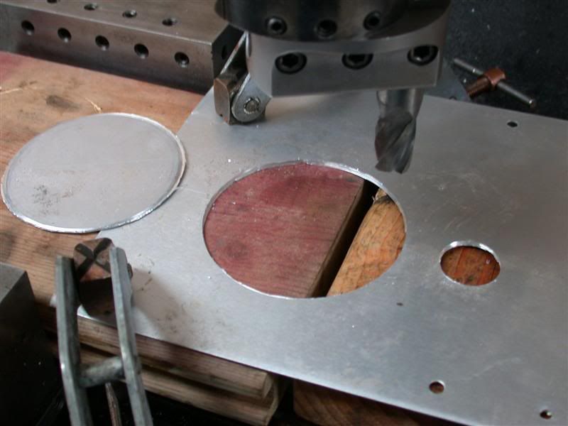

I found some .040" thick aluminum sheet that used to hold the Mate for our solar system.
It's been replaced with a Trimetric which indicates all the functions of how the solar system is doing. So the aluminum was a scrap piece now. I needed to cut a 3-1/2" hole tapering down to a 1" hole at the other end. I used a 1" hole saw for the small diameter and set my boring head with a pointed cutter to cut the larger diameter. Below are some photos of the Kubota cup holder and the metal bracket being started.
Rob-

It just so happens that on the left inside fender there is an existing mount.
It is shown in the manual to be for a tool box or something. Anyway, we didn't get the one that slides on that mount, so I made her cup holder bracket so that IT slides onto that mount.
After cutting out and connecting the 2 circles, I bent it around to fit those slideways. Then I spray painted it and popped in the new cup holder. Now she can slide the entire mount off if she wants to. Anyway, it's done and installed.
Here are a couple photos of it finished.
