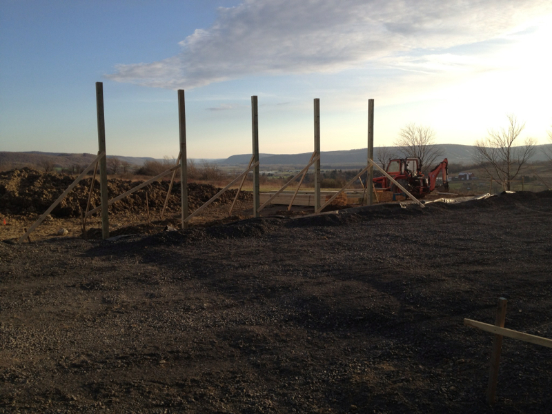

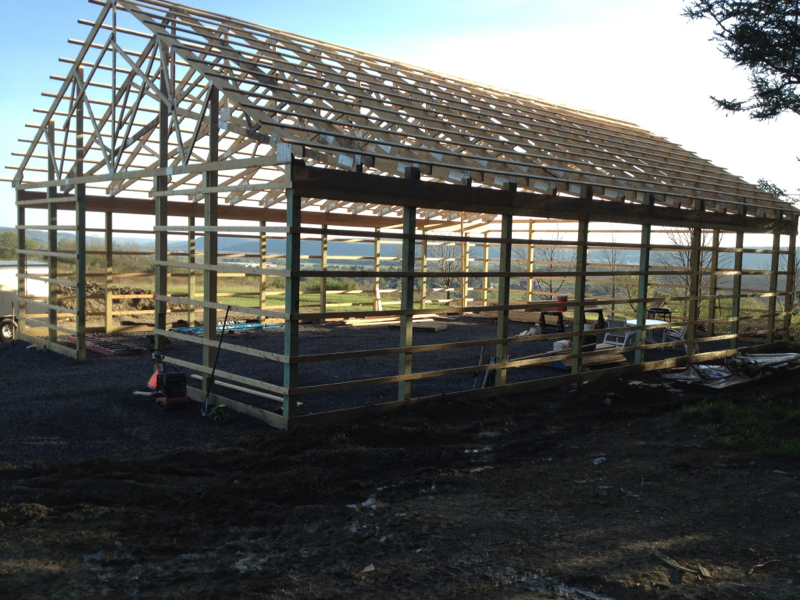

Darrenone, Looks great! FWIW I would add quite a few diagonal braces to the underside of the trusses to keep them from folding over in high winds. It looks like you have a few in place but the more the better. The diagonal braces will really tighten the trusses up and make it a lot safer, and only costs a few bucks for the 2 X 4's. Just my 2 cents of course!!
/ New Pole Barn project getting started.
#64
Thanks srs. Before we left for the day we added quite a few diagonal braces to the trusses for just the reasons you mentioned. Last summer a huge pole barn 10 miles from me had all the trusses blown over and it was a disaster. I want to get all the permanent purlins on and all the bracing on as quick as possible. Just not as young as I once was and climbing the trusses is a much slower process now. I do appreciate the input as I appreciate all the help I can get.

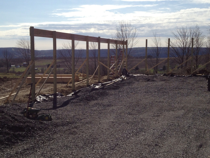

Ok, I worked both Saturday and Sunday and only managed to get the purlins up. Frustrating but at the same time it is progress.

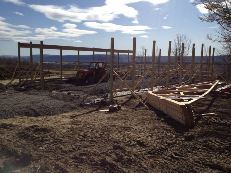

#67
Progress is frustratingly so but we are gaining.

/ New Pole Barn project getting started. #68
With that big tractor you have there you could have easily made a jib and set those trusses by yourself and saved even more $$$.
That's what we did: Strapped a long 4x4 alongside 1 of the long teeth on my grapple-bottom bucket, attached trusses to it 1 at a time, & lifted & set them in place. Worked very well. Poles are 16' tall (above ground) & trusses are 4/12 slope which equated to 4' tall in the middle, so total height jib had to reach was ~20'. That was about the extent of what my jib concoction could reach, but if it needed to be higher we would've just made a longer jib. Trusses don't weigh much individually, not mine anyway (24' long trusses span + 2' overhang) .. I could carry 1 by myself ... just couldn't lift it 16' high :)
Hey beppington, I seriously consider doing this but didn't want to find out it wouldn't work when I had help standing around. My trusses where 42' long with a 6 1/2/12 pitch on top and a 3/12 underneath . They were heavy enough that two people couldn't pick one up and carry it. Plus, the building was 12' and the trusses another 12' for a total of 24'. I just wasn't sure if the tractor would handle it. The truss company didn't do me any favors when they dropped the trusses as they put them on the side of the building. It just seemed easier and safer to lift them up over the wall and them swing them in place.

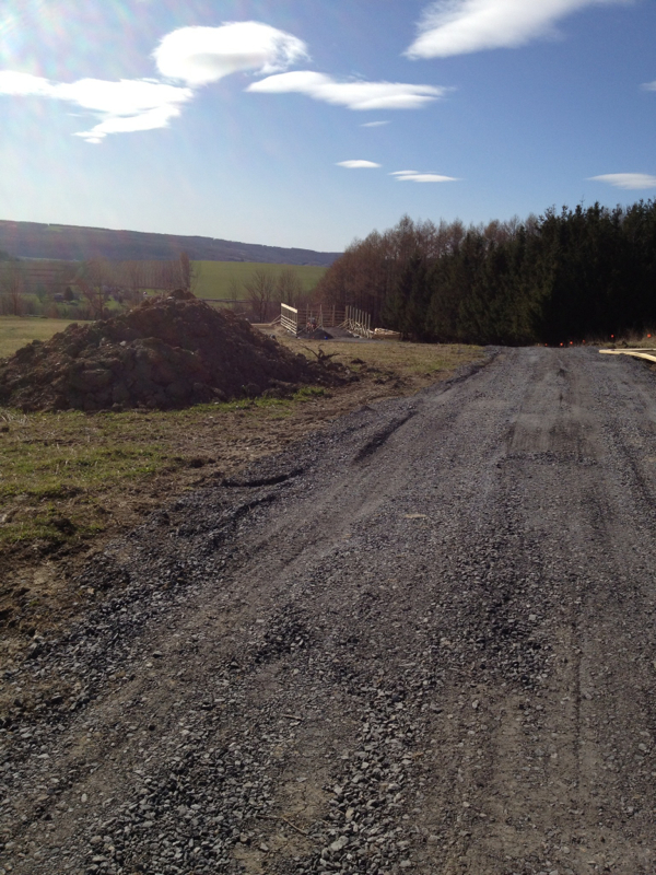

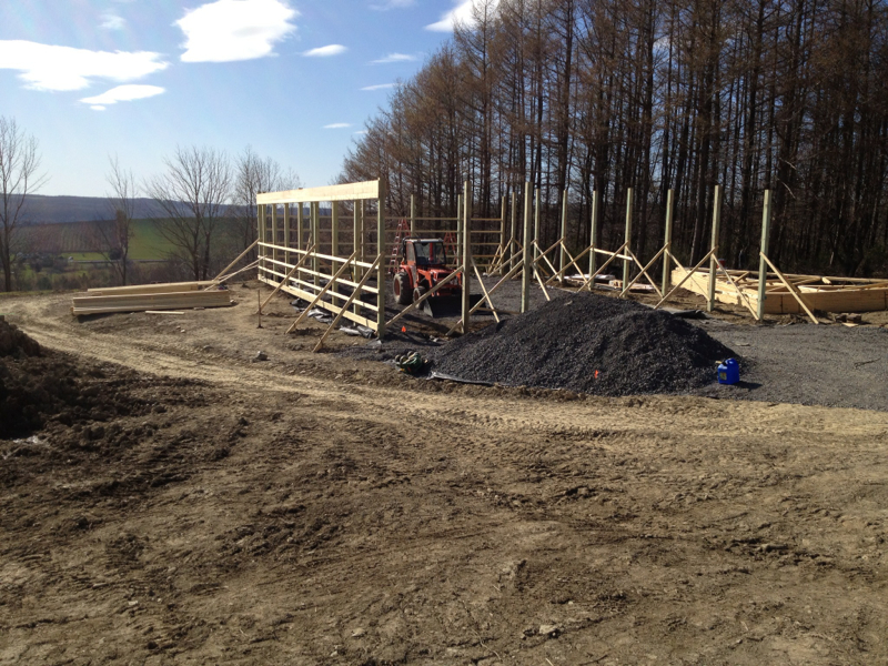

#74
Decided it was best to do the concrete floor before all the walls were up because the concrete trucks will not fit under my door opening. I was going to hold off because of money but it will be so much harder later. So, I've been preparing the floor trying to level it up with stone.

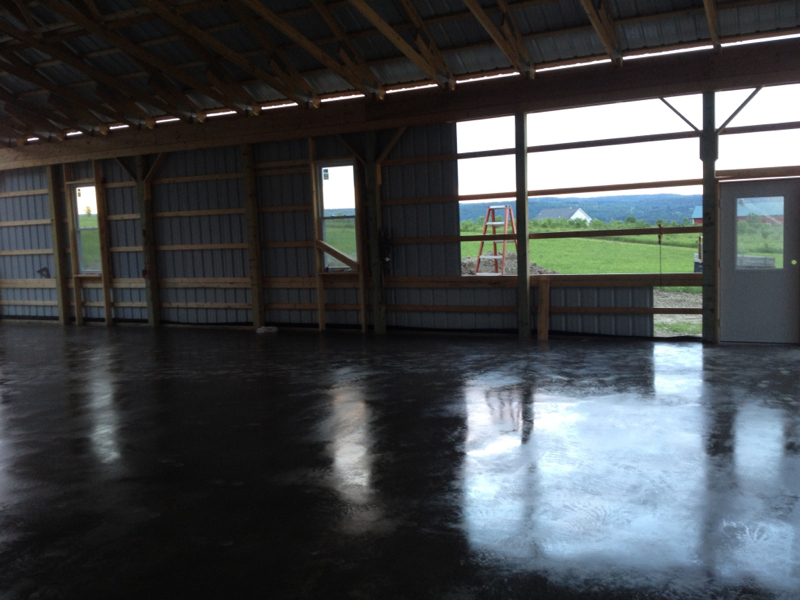

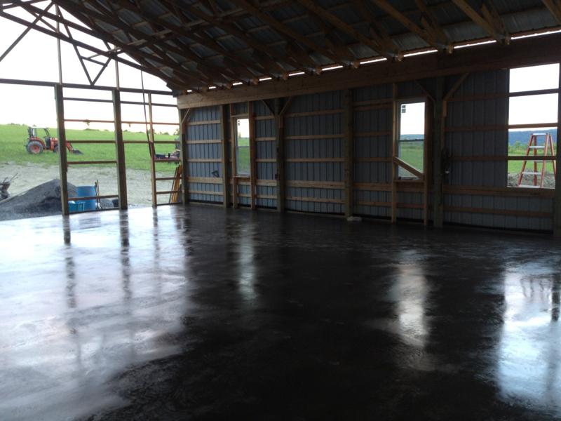

#78
Ok, now I have a concrete floor which makes it much nicer. Alot of work but it came out good. The concrete guy busted there butts. That's my son sitting in one of the trucks. 32 yards to do the floor about 4 inches. I sealed it right after they finished it. Needs one more coat which I will mix with the fine sand material so it won't be so slick when wet. Happy that part is done.
