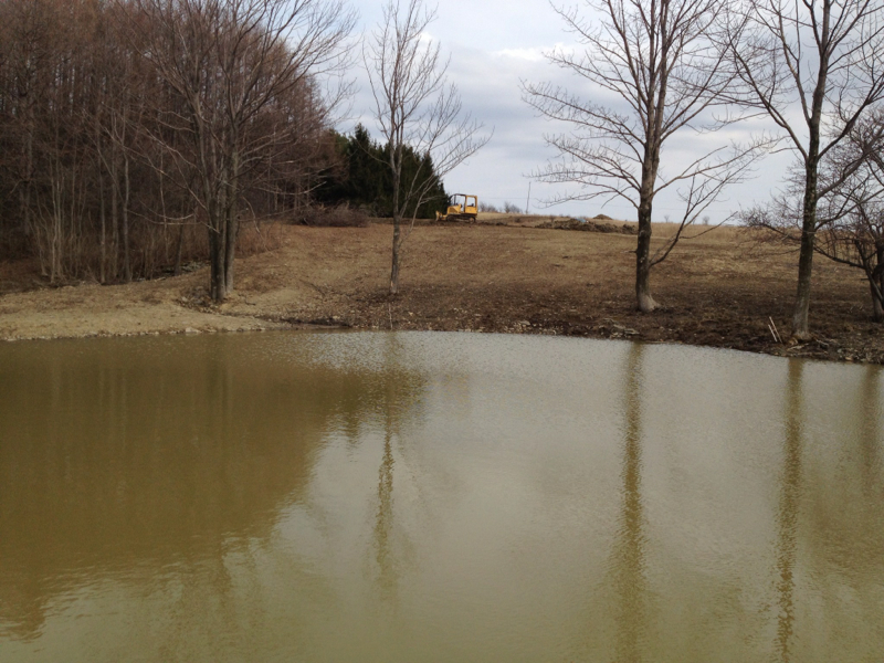

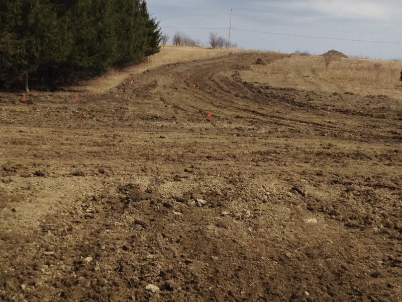

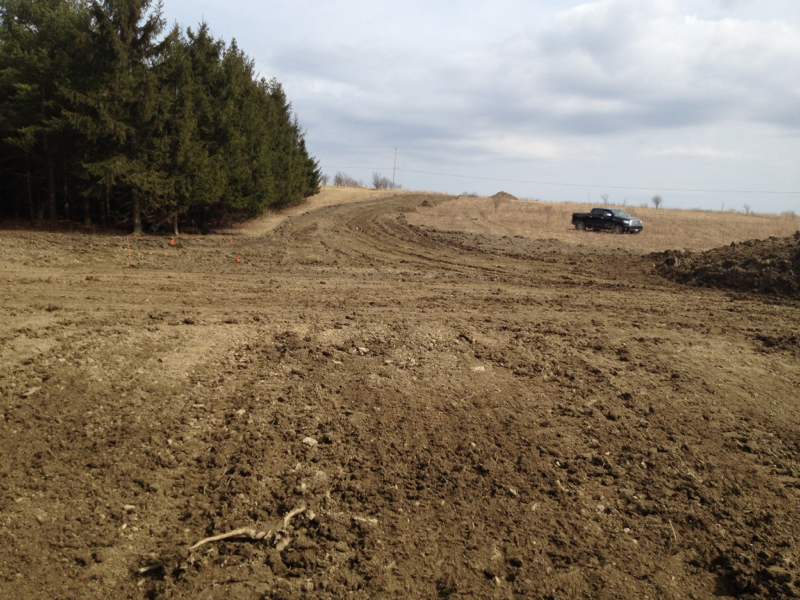

Preparing the drive way and then the gravel. The crusher run was more difficult then I thought it would be. They could only back up to where the stone ended and then dump the whole load. Trying to spread the pile was a pain as the stone wanted to get wider and wider as you push. The stone went out wider then the driveway fabric which is all mud and soft. So when the next truck came and got off to the side a little, he just sank in and got stuck. Had to pull at least three trucks out with the dozer. About 300 tons of crusher run in all and that included the pole barn. Alot of money for a driveway. This time of year is not the best for drives as the ground is so soft. I hope this driveway will hold up. The fabric will help alot but how much? Anyway, the trusses came and are now down next to the site of the barn. Hopefully this weekend I can get some post in the ground.

For the driveway and barn, I just dug off the topsoil ( top 6 - 8" ), laid down driveway fabric and then about 6-8" of crusher run. I needed the driveway fabric because of the soil conditions. Why the ground is dry here, it is very hard, but when wet, it is very soft. I didn't want all my stone sinking every time it rained and creating pot holes. The fabric works great for keeping everything solid. Inside the barn, to level it up, I had to dig down about 2' at one end and build the other end up about 2'. I used the driveway fabric in there also. Then put down the crusher run. I will have to compact the barn gravel before pouring concrete. I am going to have an electric overhead door and as I don't know a whole lot about them ( quality wise), I will probably get a door from Wayne- dalton or some such place and get a commercial grade opener. Still open for suggestions on the overhead door though.

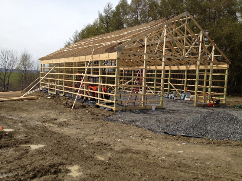

Well after two weekends of bad weather to postpone the trusses, I finally was able to get them up. Four and a half hours for the operator was $450.00 but worth every penny. He could obviously get them up faster but we could not brace them any faster. Anyways, another big step done. Now I need to get the purlins up on 2' centers so I can then get the steel roof on. I hope all the money I'm saving by doing it myself is worth it. Considering a pole barn company is in and out in 5 days. Well, it will be worth it when I'm done.

Your location in NY, I assume you get quite a bit of lake effect snow? Are those rafters 5 or 6/12 pitch?, and on 4' centers - WOW. Should be heck for stout. Mine are 42' freespan on 8' centers.

Hey Depmandog. Yes, we get quite a bit of snow normally( not so much this winter) so the trusses had to be made to handle the snow load. They are 6 1/2/ 12 because they are a scissor truss. The inside is a 3/12 to get more head rm for storage above an area where I will build my shop (wood working ). They are also on 4 ft centers. Seemed a bit much to me but had it engineered by a pole barn company not far from me. The scenery is beautiful and thanks.

Well I thought hard about trying to set them myself with the tractor but thought with them being 42' long and heavy enough that two people could barely stand one up that maybe it wouldn't be such a good ideal. The top of the walls are 12' and the trusses are another 12' so I would have to have rig a long jib. Also, the truss people drop the trusses on the side of the building so it was easiest to lift them over the side wall to put them in place. With a jib, I think I would have had to carry each truss inside the building and then try the lift them in place. I just thought that was going to be too hard and didn't want to risk it not working while all my free help just stood around. Good advice on getting the walls up as quick as possible as I wouldn't want to show up there to work and find out my building was laying in a heap.
