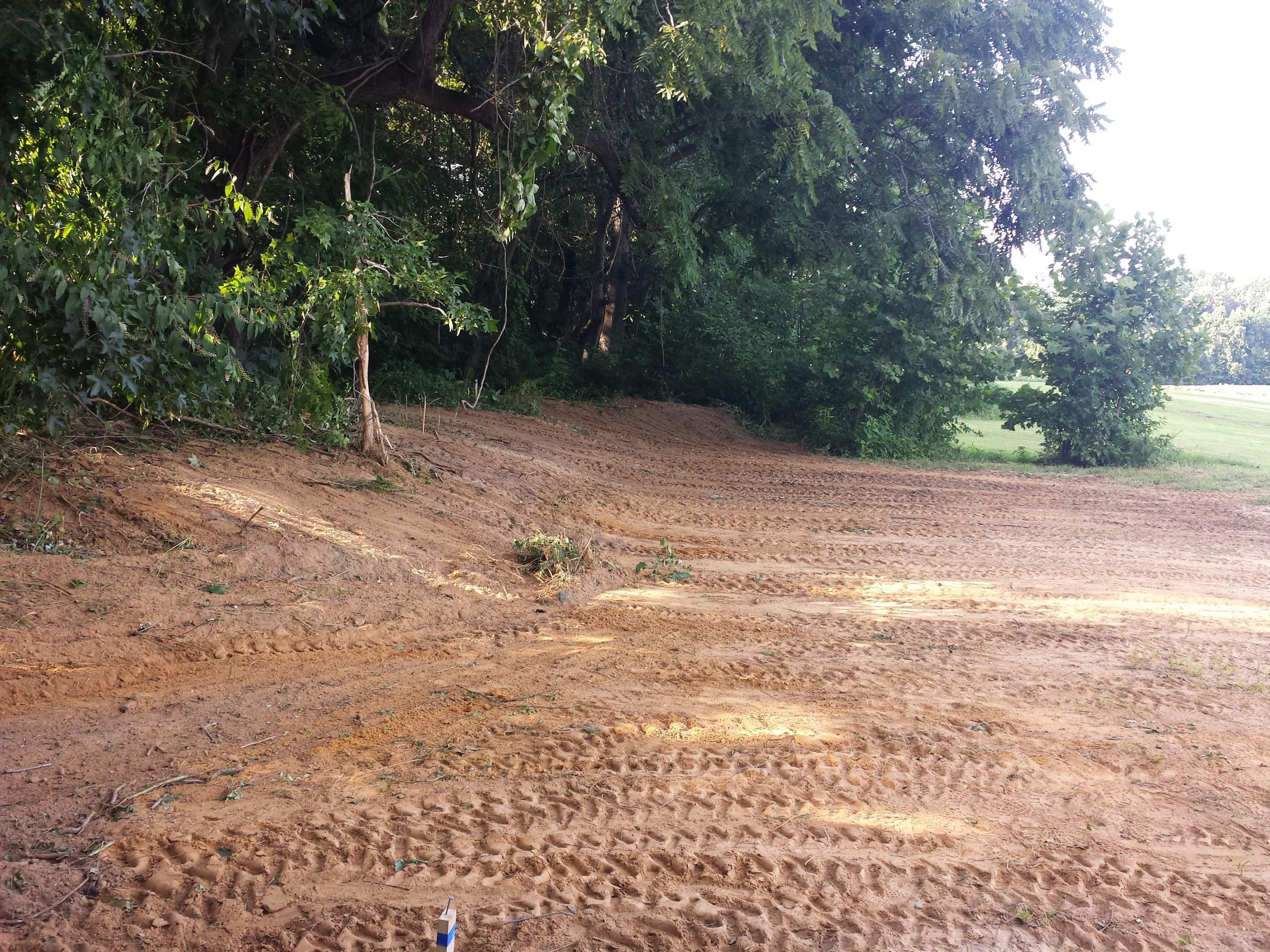

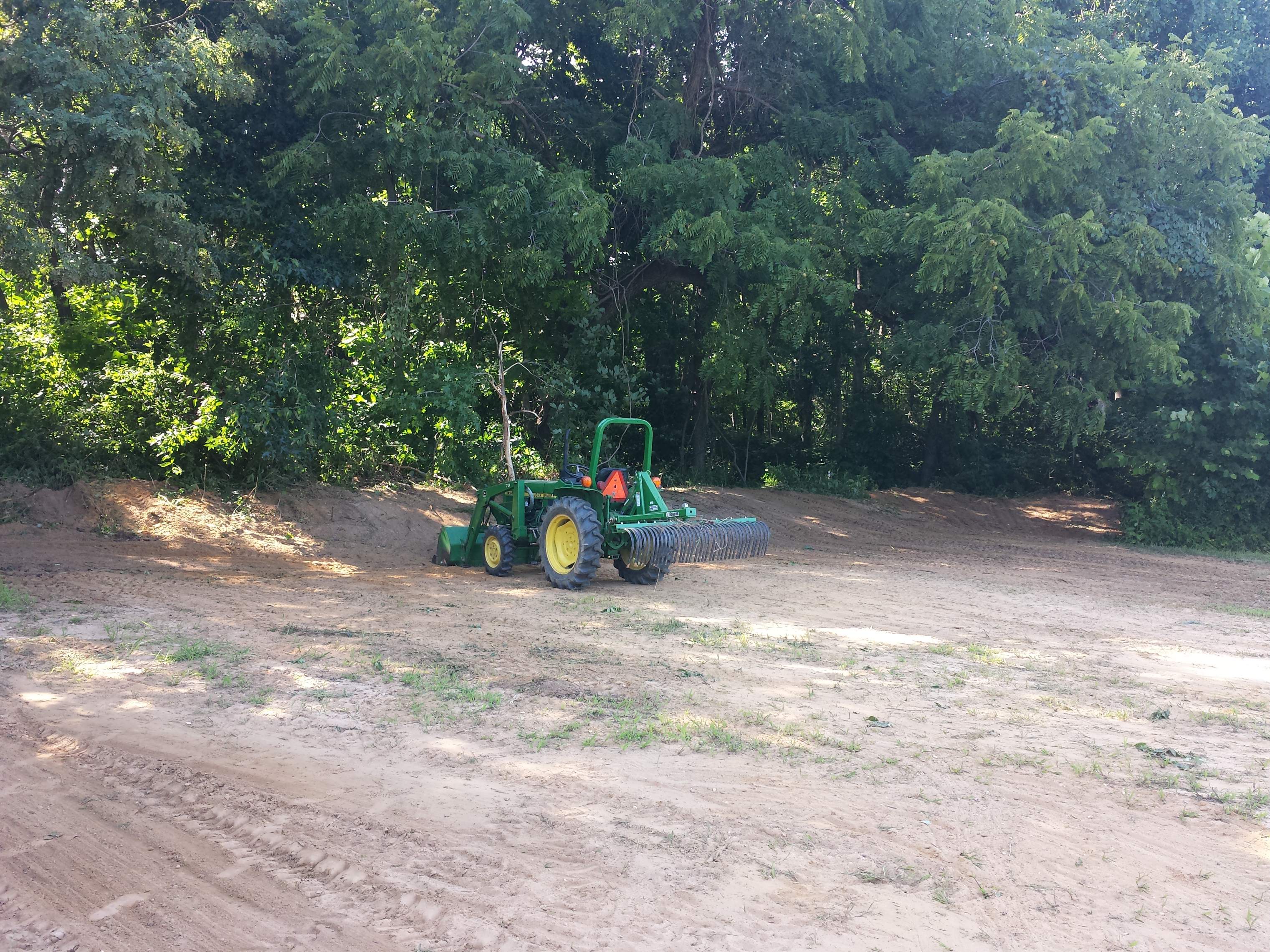

Hello,
I am in dire need of an experienced excavator/engineer that's familiar with monolithic concrete slabs and soils in southern MD. Could anyone recommend someone?
A surveyor came out and took some measurements which showed me two things.
1. I need to move building forward to avoid a walnut tree and 2. the subgrade needs to be cut 2' in order to level out with the lowest existing grade.
I was told that once the soil is removed, which is a sandy/clay consistency, that 6" layers of #57 stone should be brought in and compacted to the height you want.
Can anyone add anything further?

Finally found an excavator that will cut out the existing clay and replace it with "bank run". The bank run will be built up in 8" lifts then compacted. The total height will be 1' over existing subgrade and then tapered on the ends with one foot overhang all the way around.

make sure water drains away from the shed location. and does not collect around or near it. but rather runs away from the shed.
the 2 photos... are showing what looks like a pretty good hill there. and all the water will be running right into one side of the shed.
bring the shed out further, so you can create a ditch per say and if needed a french drain setup in it. to help direct water around the one side of shed that is against the hill.
make sure you plan on "gutters" on the shed. and direct the gutters to a spot that will allow water to run away from the shed including the driveway going to the shed.
*points up* water drainage.... get it sorted out now. while you can run larger machinery here there and every were. and if need be re-landscape / move dirt / put in ditches / etc...

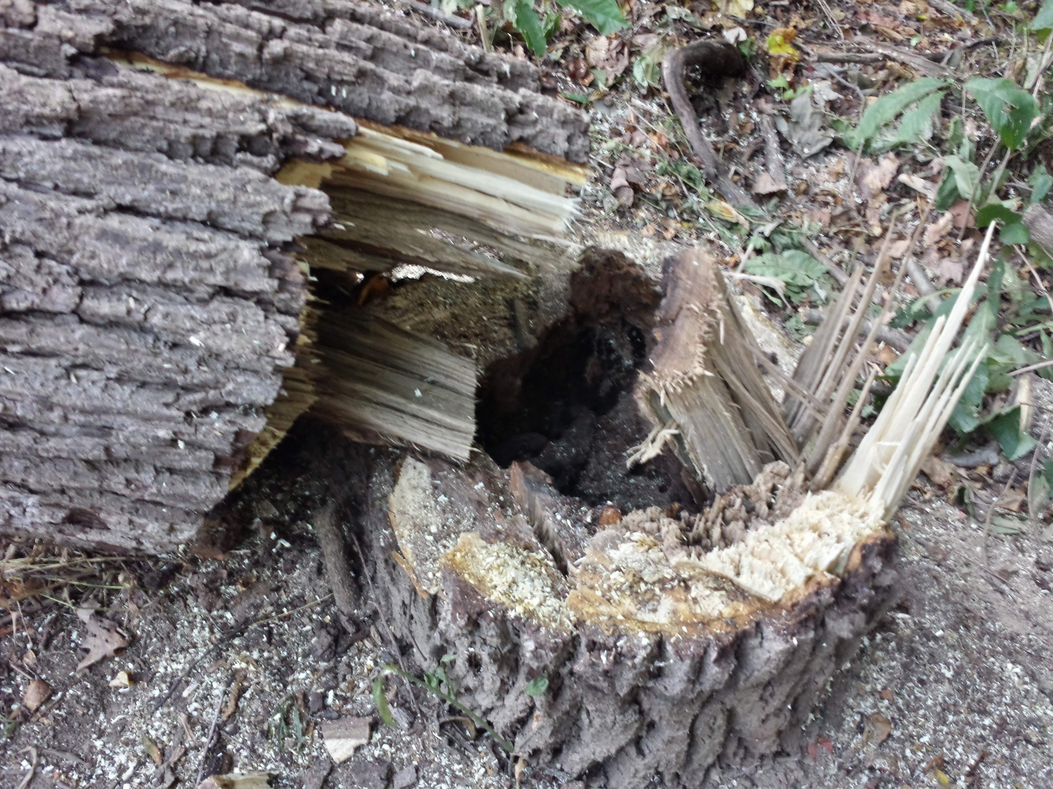

Every time I've moved a building location due to a tree, or built around an existing tree, the tree always ends up dying on me. I've come to realize that no matter how nice a tree it is, I never miss it once it's gone and I'm able to build what I want, where I want it.
Actually your post did me a great service, thanks! The walnut tree was rotten inside!
I ended up cutting and limbing the tree and using the tractor to push everything into the rear of the woods.
