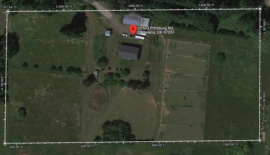

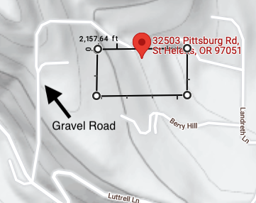

I need a tractor, no question since I don't want to use wheelbarrow and shovel to move gravel. That's the biggest must have, but even the ability to move a single wheelbarrow worth in the bucket at a time is plenty of capacity there. (500lbs or so). I think it'll be more cost effective to maintain the driveway myself instead of hiring that out since I already need a tractor for gravel. I need a mower for sure, and bundling that with the tractor seems to make sense given I've got about 2 acres worth of mowing to do. Something like 4 acres worth of pasture.
I am interested in stability on the hillside and making sure I have enough power going uphill. That was the main reason I decided the BX series was likely not the right choice.
Some pictures below to show size and slope. Even more detail here: https://www.redfin.com/OR/St-Helens/32503-Pittsburg-Rd-97051/home/25965190

That's a nice looking place, yeah I'm not seeing 200' elevation change in those six acres but always hard to tell from pictures.
Yeah, it doesn't really show in the Redfin pictures but it's definitely on a slope. The contour map I posted probably does a better job of showing it.
