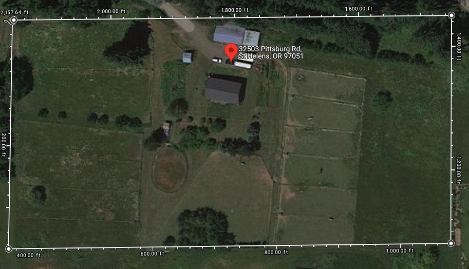

We have 210 acres - none of it flat. We operate with a 2005 Massey 1533 Compact tractor. The tires are not loaded. It has a FEL and we mow 25 acres give or take with a rotary brush mower. The mower is a 60" light duty, good for cutting up to an inch - inch and a half - requires 25hp from the PTO.. the 1533 has 28PTO Hp.
Tractor by itself is right around 3000#. The FEL adds another thousand. Wheel spacing is set at 63". We could go wider but then our trail work would be more problematic.
Slopes are max at 20 degrees... which gave me quite a bit of seat pucker my first time out on the big meadow. We do not cut across the slopes. Up and down only. Some places it is backing up and down, no turning up top. When up slope, you want to keep the tractor in gear... a mistake at the top can have you flying down the hill at a crazy rate of speed with no or little ability to stop. Learn to use the FEL to help hold if changing gears up top. (Lesson learned the hard way.)

You can't be the only family on that hill. What are others doing to maintain their property? Perhaps talking with them would give a better feel for how to manage you 6 acres?
We have a neighbor who has 15-20 head of cattle, does a lot of haying, lifts big rounds in the winter for the cattle. He has a full size JD tractor for much of that work. He has a skid steer and heavy duty front loader/back hoe - which I have never seen him run. He produces hay on 100 acres give or take.. If I have a tractor question about operating on the slopes of the mountain we share, Larry is my go to. My recommendation: talk to a neighbor and see what they have to say.
