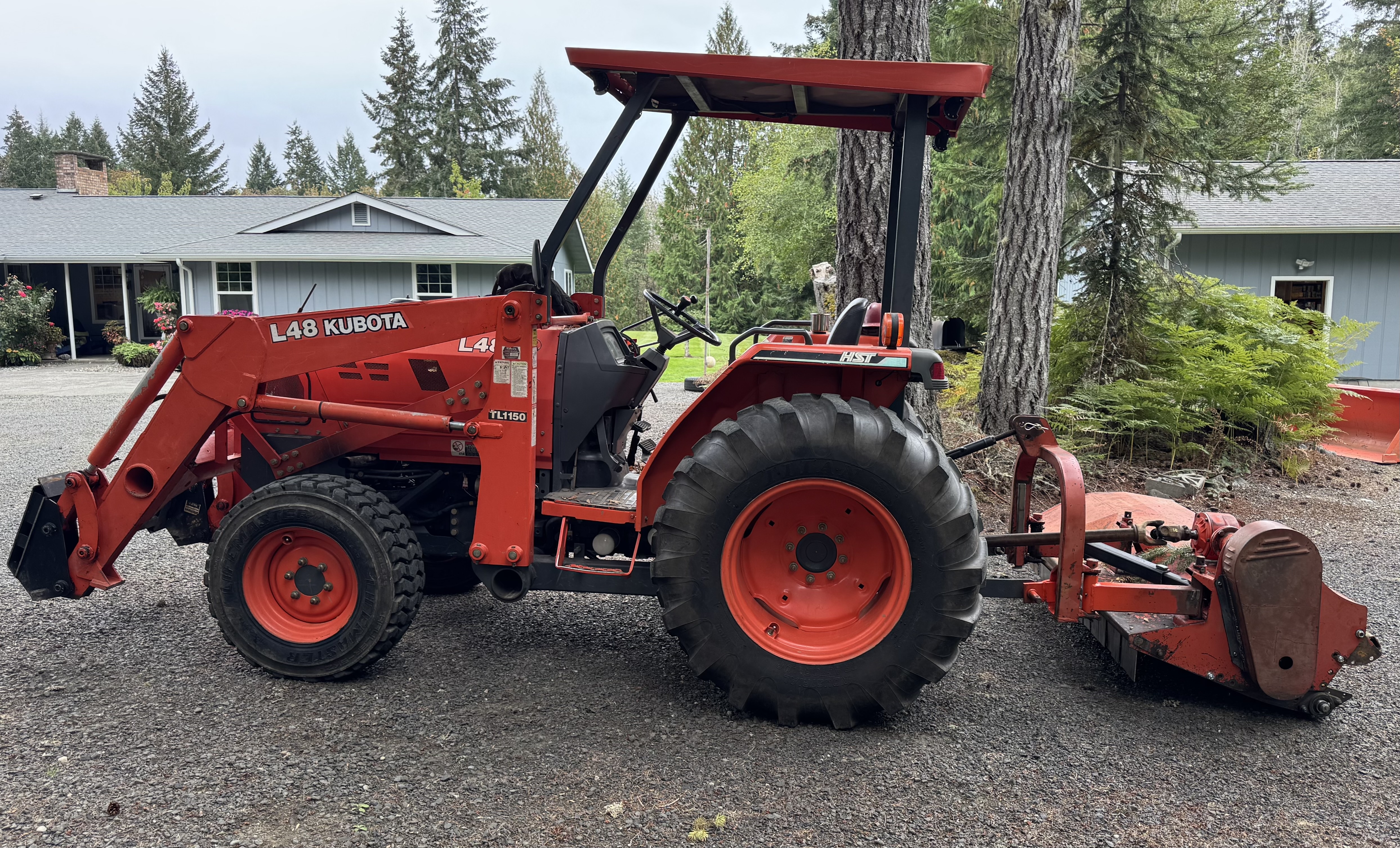

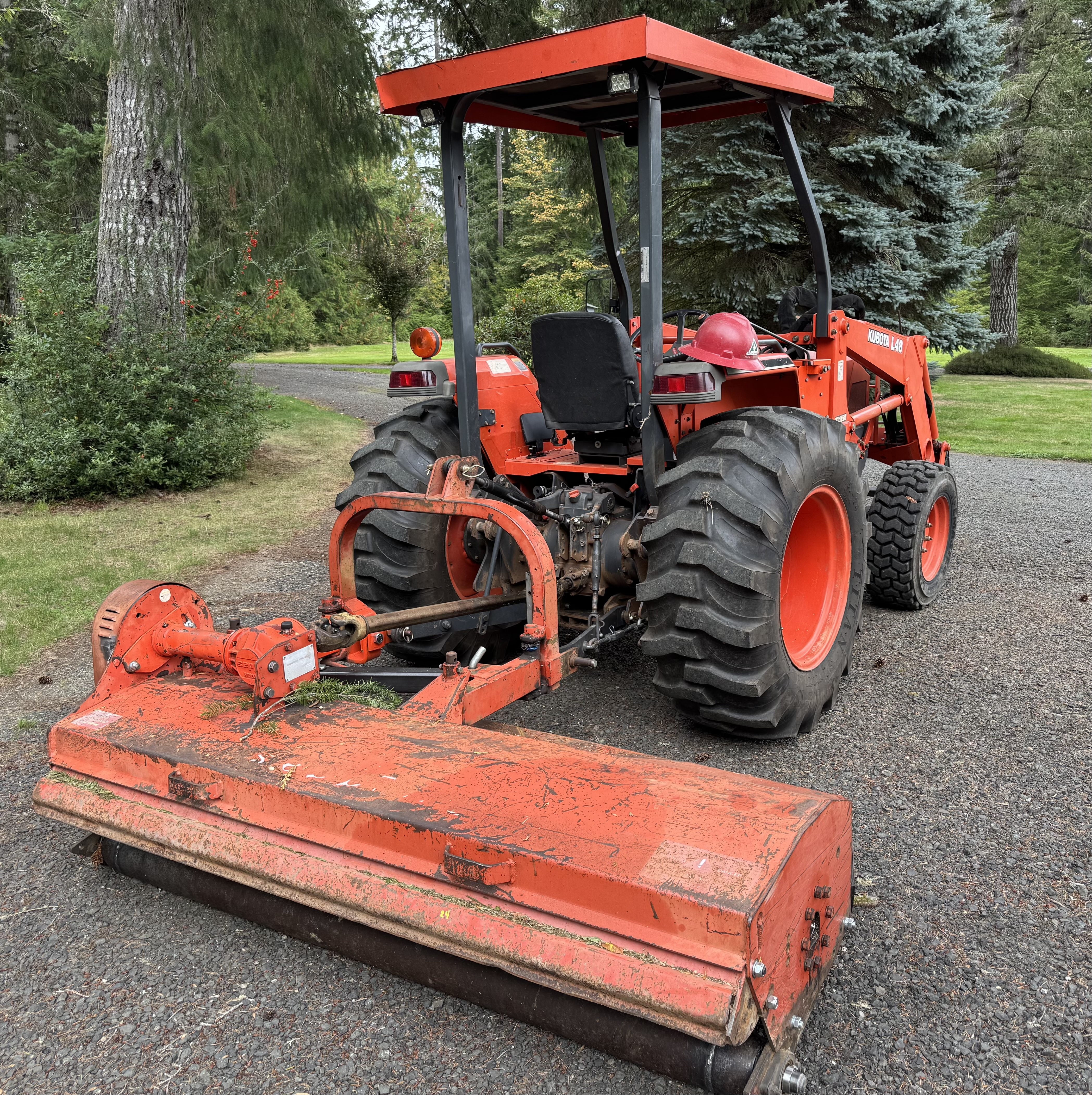

It has been a while, but I have an update on the Seppi flail mower.
Monday I finished tightening the hammers on the mower, greased it and test ran the mower. I was concerned that there may be an imbalance problem. I was pleasantly surprised to note that the machine ran very smoothly. There is an ever so slight vibration that you cannot even feel while in the field mowing.
After confirming that the mower ran smooth, I locked all the hammer nuts to the bolts and took it out to do the fall hay field mow down. The mower works really well. I am sure the hammers are not the best for grass, but I was very happy with the results.
I checked the gearbox after about an hour and half, and it was just barely warm, and the input seal was dry as a bone. I will finish up the field today and chalk up this mower as a decent acquisition.
The next project is to pursue rear remotes for the L48. I built an adjustable connector between the two parallel arms to be a "placeholder" for the offset cylinder until I can get the remote circuits in place.
Pictures below.

Congrats on your mower. Looks good. I have been impressed when using on autumn olive and other woody materials. I back up and over the target subject while running at a reduced rpm and then drop the mower increasing rpm's and pull forward--no more autumn olive.

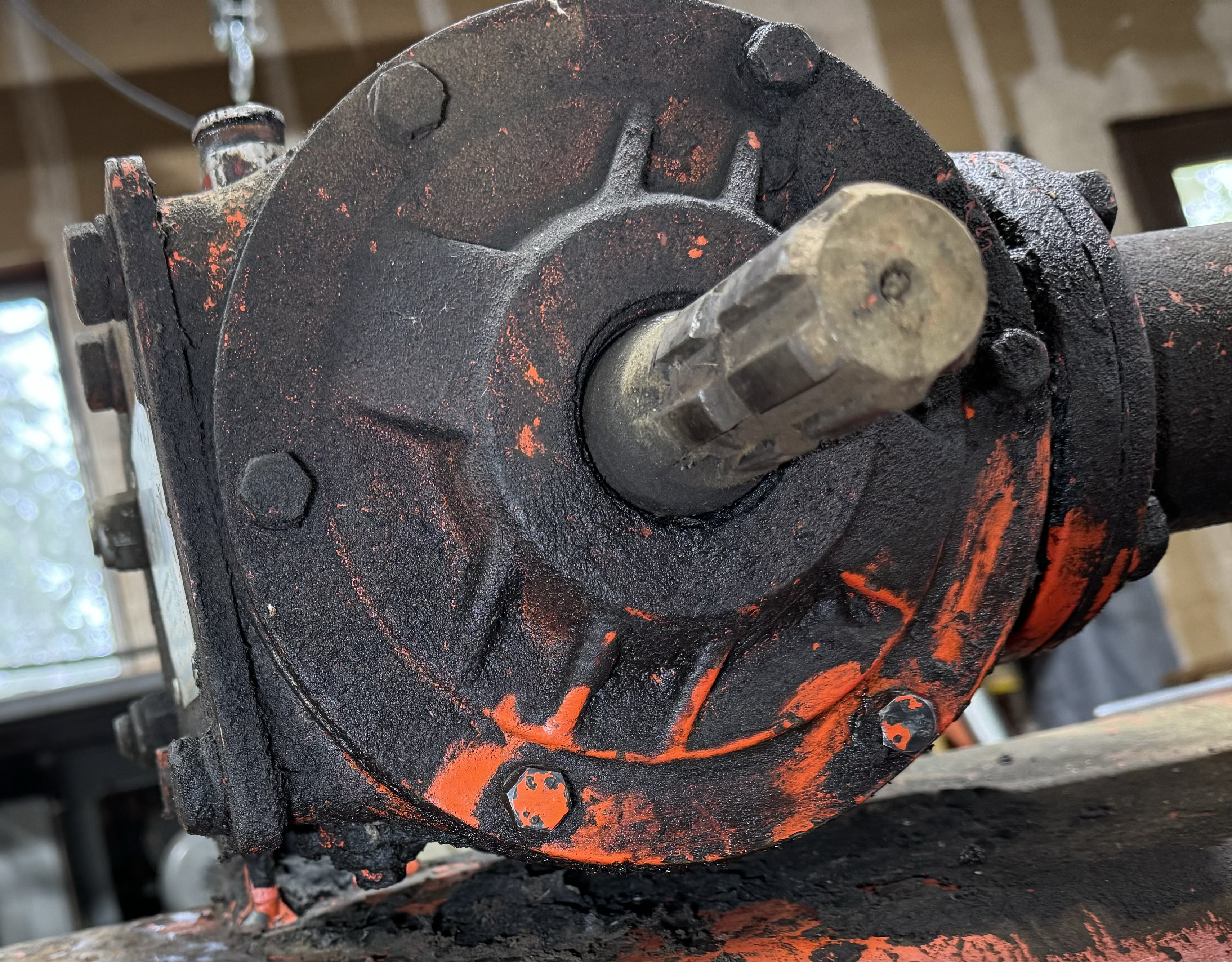

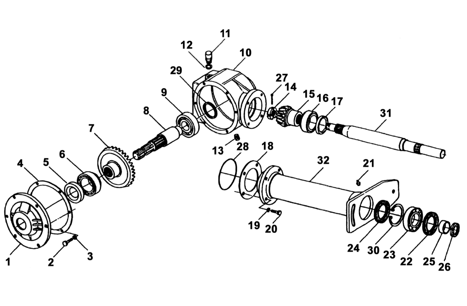

It looks like a spoke too soon concerning the gearbox input shaft seal. It is leaking. Not terribly bad, but it is leaking. This is a pic of the front of the gearbox right after I bought the machine:
Has anyone here ever changed a seal on a gearbox such as this?
It looks like once the front cover is removed, parts 5-29 will come out of the housing. Then slide the seal (part #5) off the shaft and then slide the new seal back on. Am I seeing this right?
Thanks for your time,
Doug

Hello Doug,
I would prefer that you used corn picker grease for now as the shaft will be worn as well
and by using the corn picker grease you will not have leakage and dirt collecting on the
gearbox. There is no point in replacing the seal and not the shaft at the same time.

Hello Doug,
Leon,
Thank you for your reply. I will check into the corn picker grease. What is its consistency compared to 80-90 gear oil? I assume thicker, but will it pour into the gearbox?
Thanks again,
Doug
