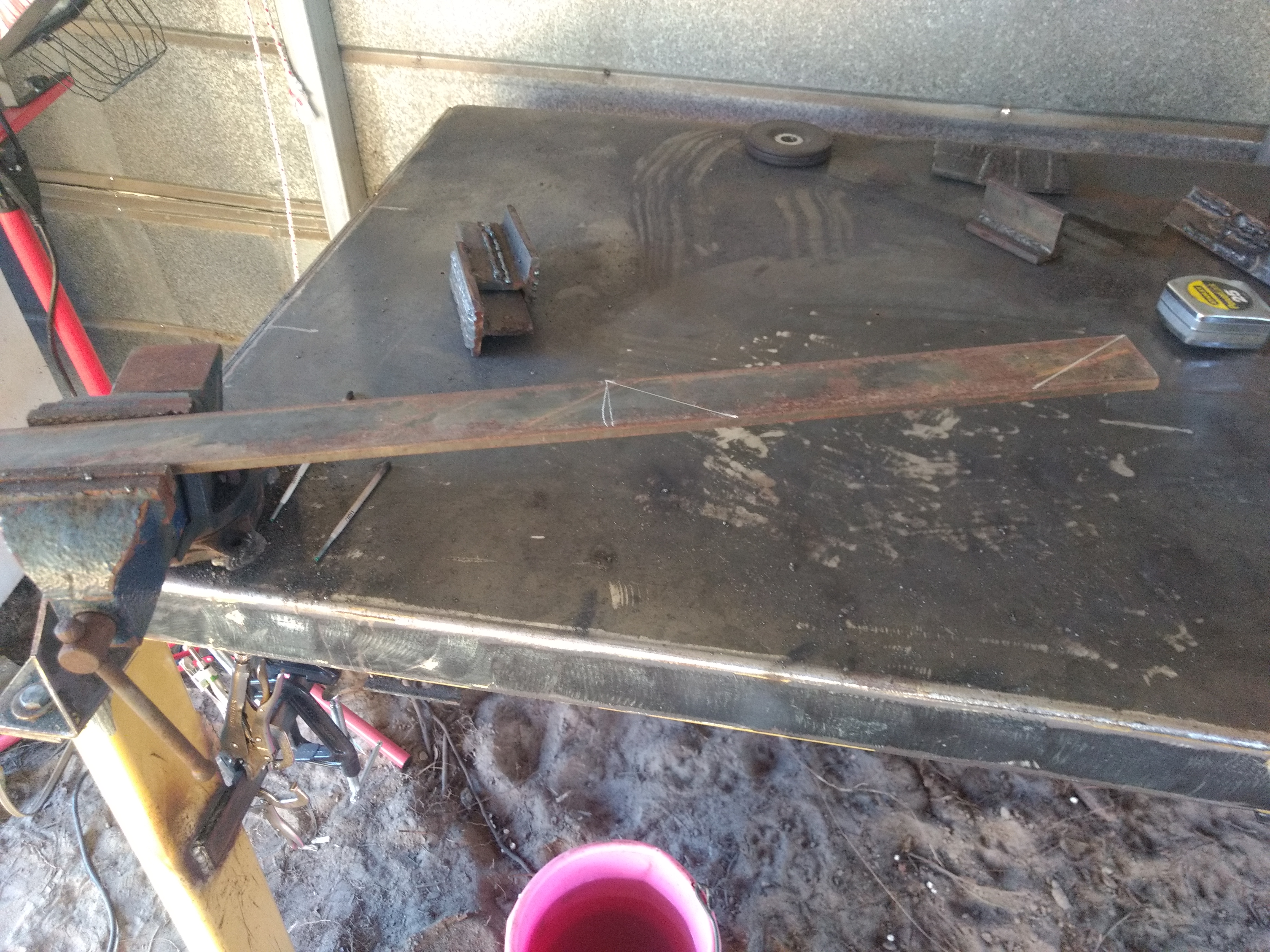

Good to know SA. I stacked some tonight after I did my first pass on all my coupons I cut for Fillet & Lap welds tonight. Be nice to just get a huge bucket of those from somewhere, lol.
Here's my last two welds of each way. I think these look better than last night's but rather hear it from y'all.?

Oh, those look really good! You catch on very fast! :thumbsup::thumbsup:

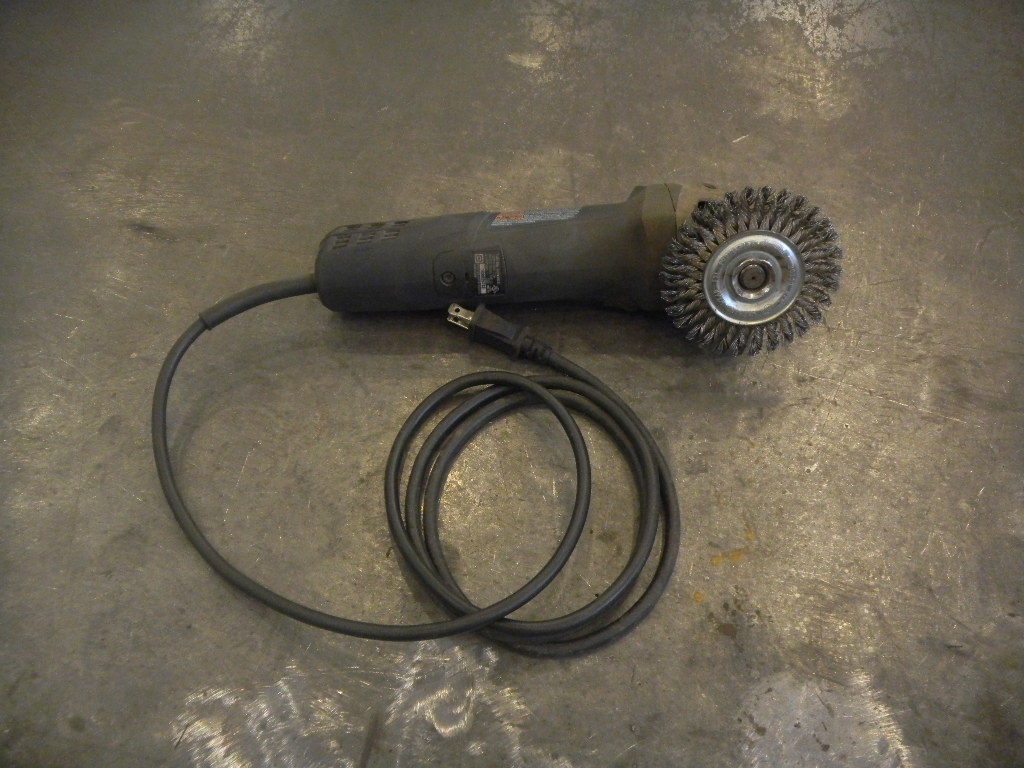

If you're going to run a lot of 6011, or 6010. A wire wheel on a small grinder really cleans the slag off nice.

Appreciate the heads up, it's a bear trying to really clean these.
I'll keep working on this a bit to get more consistent then what next, vertical uphill with the same lap & fillet weld?
   / New to welding #155
That's what I would do. When going vertical up hill in a V-groove. With 6010, or 6011 I run a U motion, same with a fillet weld. Now when running vertical up hill on a lap joint. I run a J motion. I run the long part of the J on the flat plate. And let the curl of the J onto the thinner plate. Just a suggestion for you to try. You have to find what works best for you.

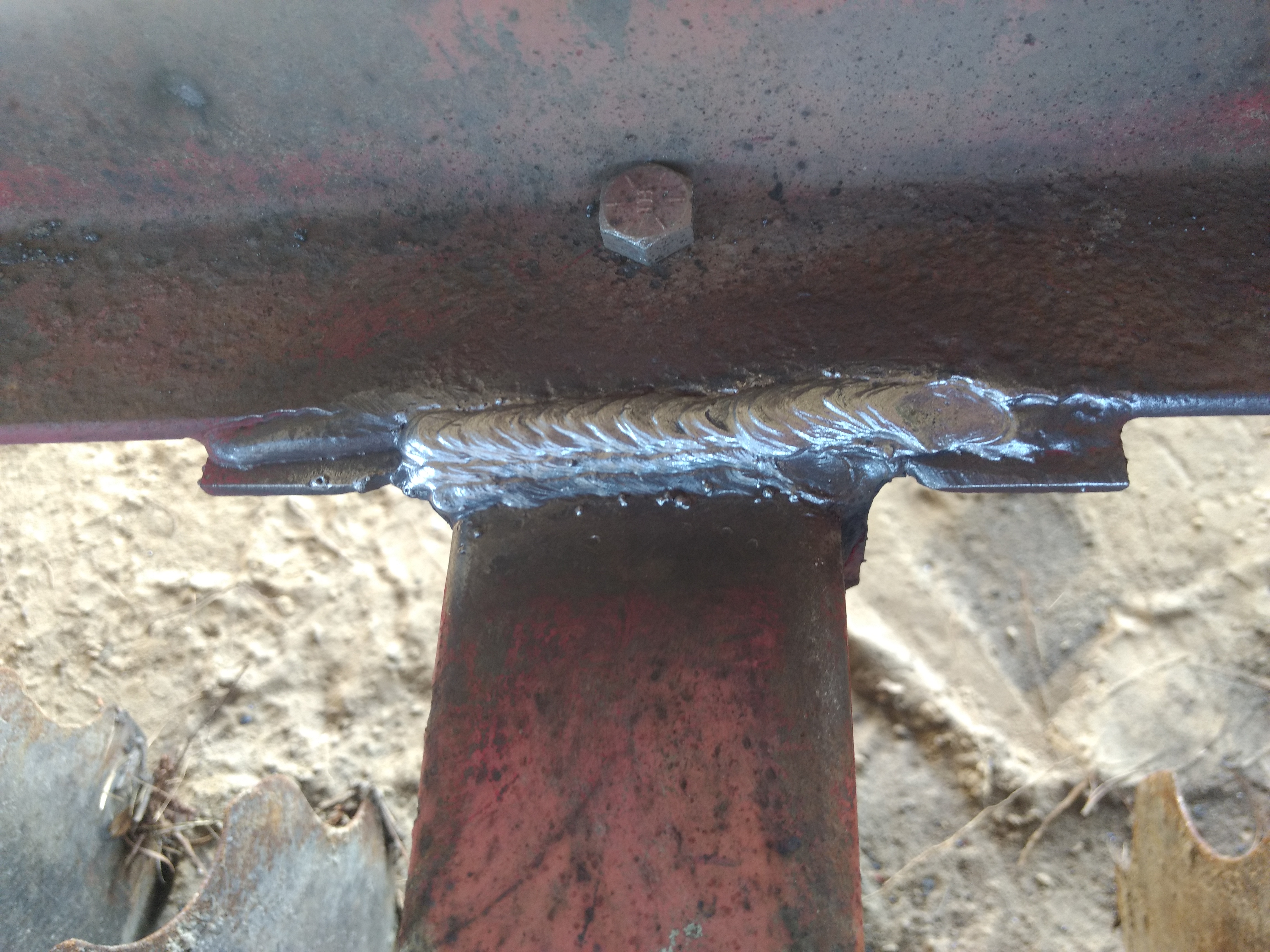

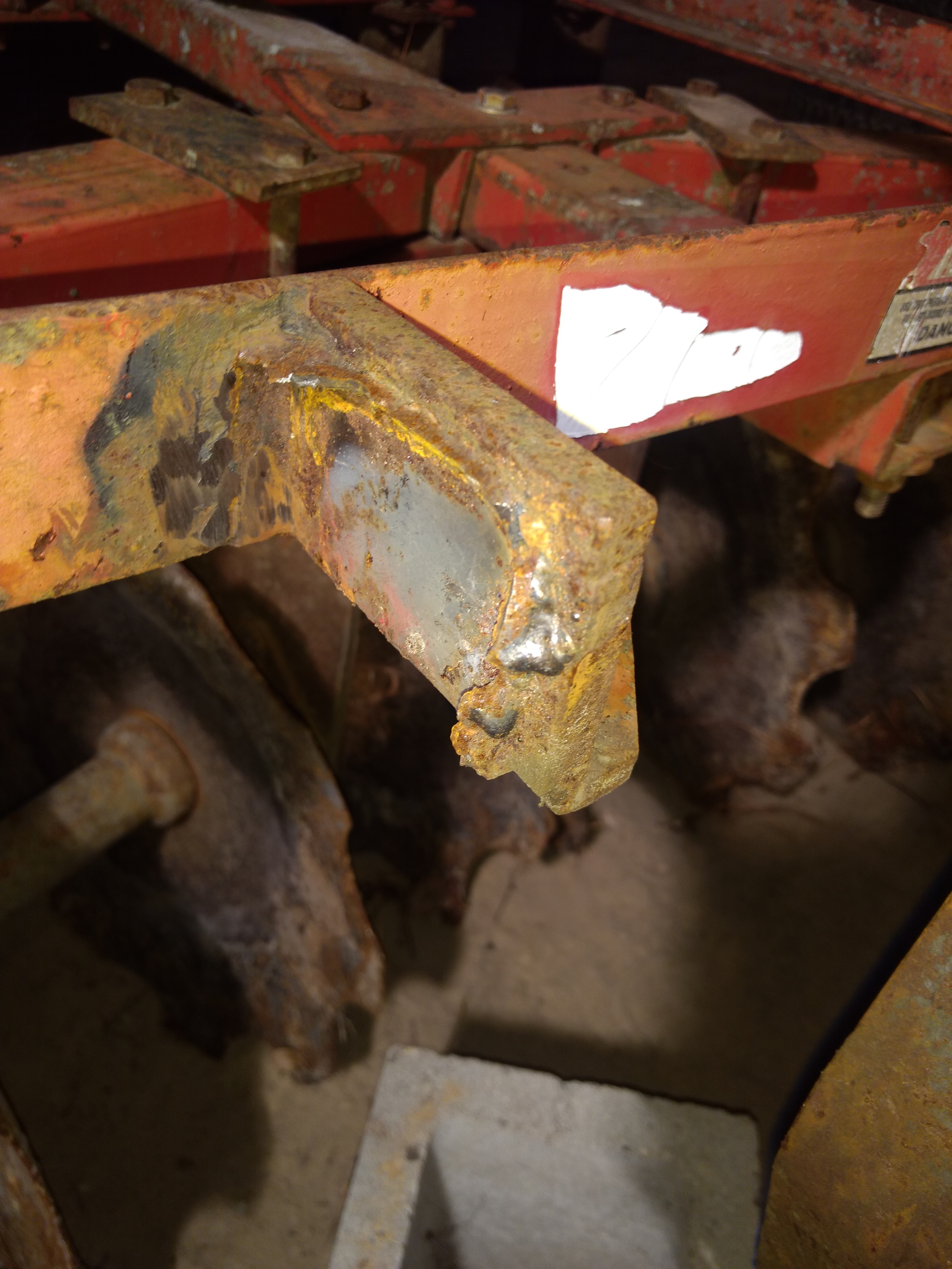

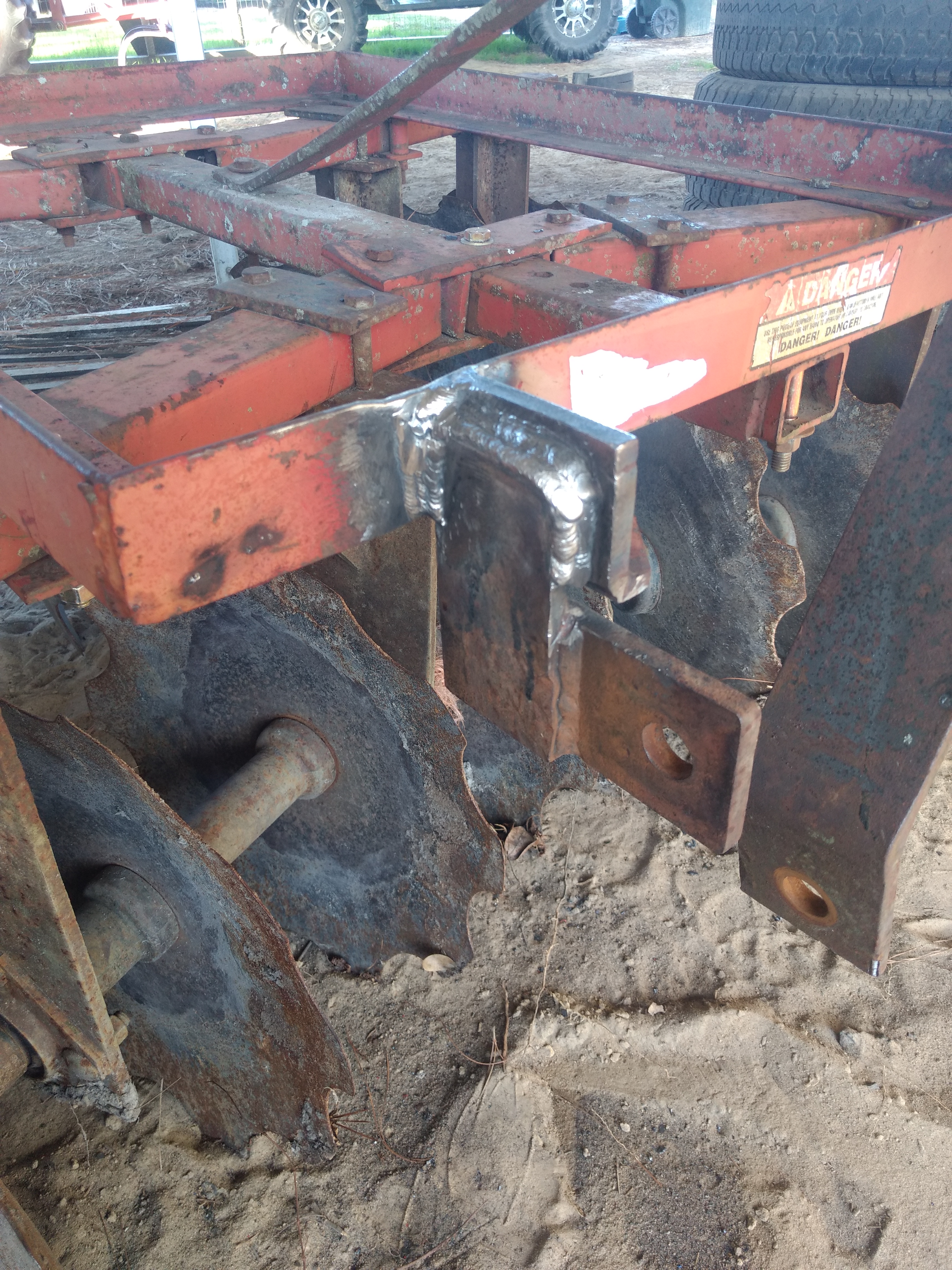

Sharing a set of disk harrows I repaired over the weekend that go on our 32hp Kubota. Friend repaired it a few yes ago and the weld cracked down the center. Cut all the old weld out and grinded back smooth. The plate was bent slightly and didn't fit exactly smooth so I beveled the back side where it wasn't sitting flush and filled in with 6011 for about 1". Also the reason I put multiple welds stacked and spread out so maybe it'll hold the pressure now being only about a 500lbs set of disk. Not the prettiest by far, but I think I'm getting better. More practice more practice!
Also repaired a brace in the frame of the harrows, that one was flat and easy! Wish everything could be flat.

Thanks man

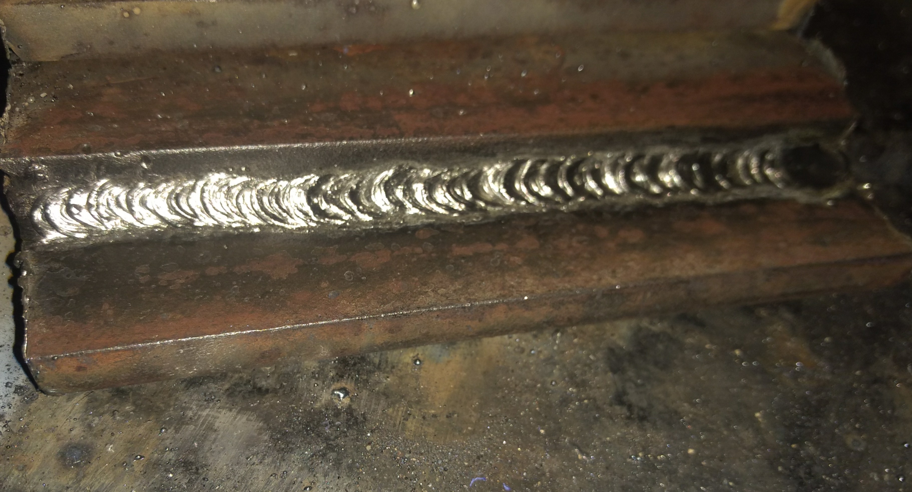

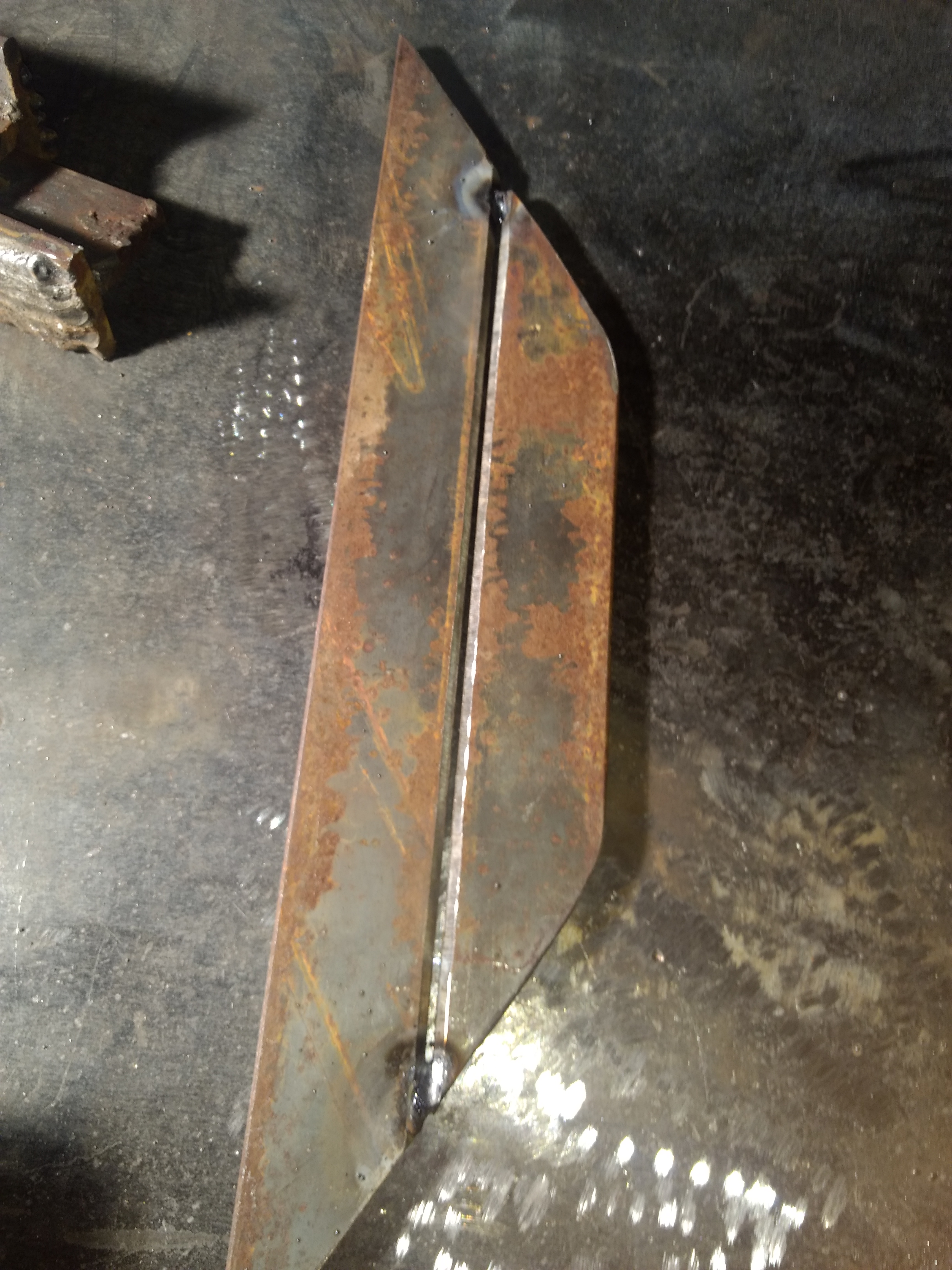

Next project is building support for the inside of the front 3pt hitch on my 9ft Taylor way disk harrows. Original owner had already repaired it in a way but his repair cracked and spread to the 1" 3pt arm. Going to weld 3 3/8x2" pieces of flat stock for the center tonight I hope I can finish that part. Here's where I made it so far, run a root pass with 6011 and finish up with 7014 for a cap to grind smooth. I could have done it all with 1 rod but I wanted to work with both especially to get more familiar with 6011. Metal surface will will be clean before next pass with 7014.
Added in the wire cup brush just for you Shield Arc, thanks for the recommendation!

Man oh man, that last picture of the weld with the cup brush beside it. You are doing great!:thumbsup::thumbsup: What a fast learner you are! :cool2::cool2::cool2:
