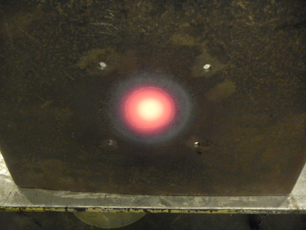

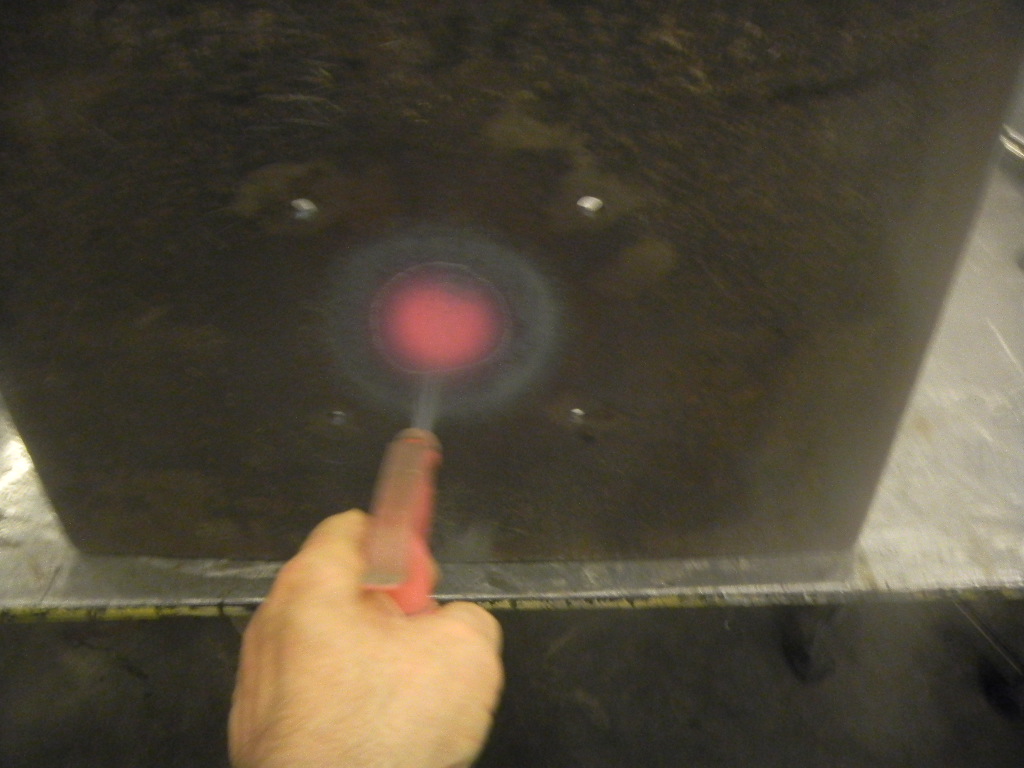

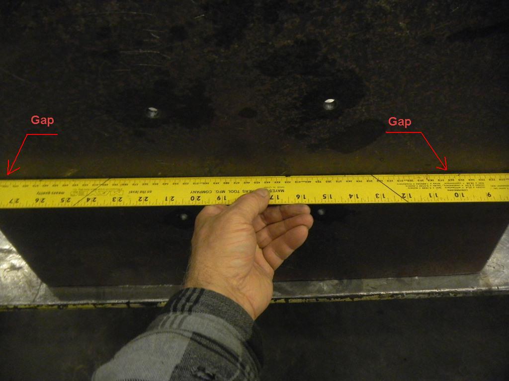

Question for you guys, I grinded and re welded my welds 2-3 times per side, 3/8" steel. I can notice a very very slight bow in the plate. Is the steel still good to use for a inner brace? Or has rewelding it to my satisfaction possibly weakened the steel?
   / New to welding #165
Its draw it up. It will happen. Weld on the back side, and it is likely to draw it back in line. Keep in mind this stresses the metal.
   / New to welding #166
As Mark said, you can weld on the back side. And let it cool, to draw it back. Or if you have a torch, you can heat the back side, and spray water on it. To draw it back straight.
