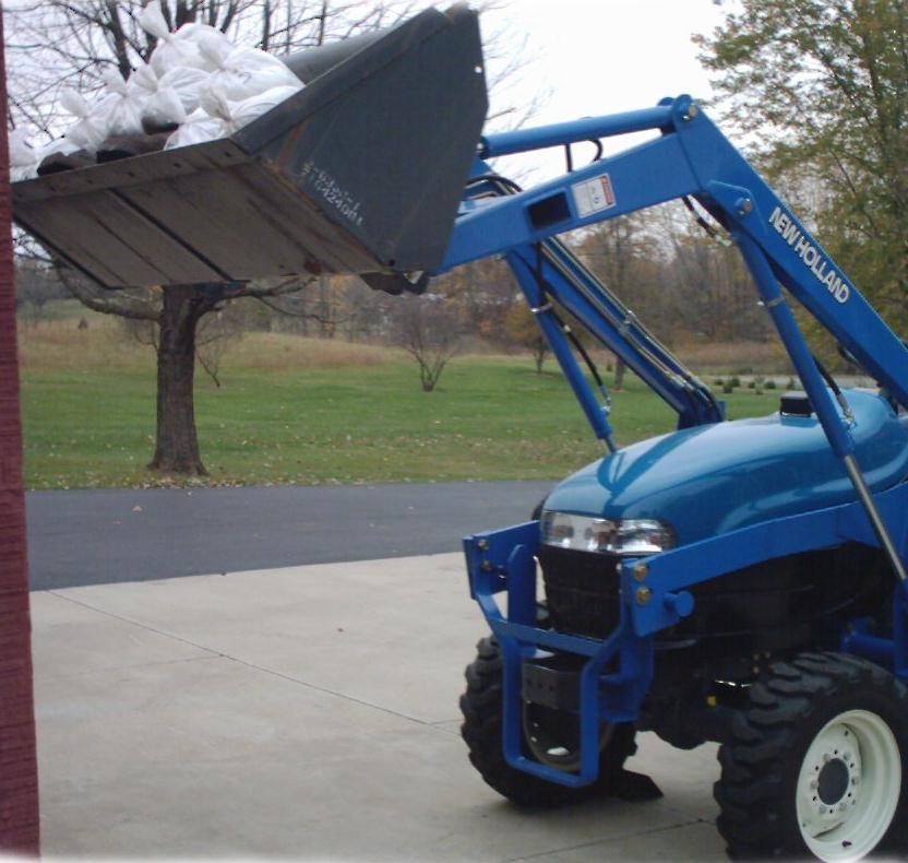

OK, here are my numbers (added to the end of the list):
Who , Before , After
Spencer , 1775 , 1850
Mrwurm , ? , 2000
DanCT , 1750 , 1750
thcri , 1600 , 1850
bnixon , 1750 , 1850
cdcole , 1600 , 1775
MikePA , 1700 , 1825
Roto , 2150 , 2150
stumpman , 2000 , 2000
SteveInMD , 1675 , 1850
Mosey , 1800 , 1800
Before I even hooked up the gauge, I did some testing to see how much it would lift. I have 8 62lb weights, 9 55lb sandbags and 2 30lb weights. That's a total of 1050lbs (rounded down). I put all that weight in the bucket and had my 640lb finish mower hooked to the back for ballast. A picture is attached.
   / NH 7308 Loader Owners #136
Did it lift it? (drumroll please),
Yes, it was able to lift the bucket to 66" high (to the bottom of the bucket). I tried to post a picture, but couldn't get it trimmed down to get below the 100k byte limit. I'll mess around with it some and see if I can get it.
Anyway, since the pressure is already at 1800lbs and it will lift 1050lbs, which is plenty for me, then I didn't adjust the valve.
   / NH 7308 Loader Owners #137
Kevin, Send me PM with your address and I'll send the gauge to you next.
   / NH 7308 Loader Owners #138
Here's the picture of lifting 1050 lbs. The finish mower was barely enough ballast for that much weight. When I lowed it back down, I (unintentionally) jerked it when I stopped lowering it and the rear tires bounced off the gound a little.
