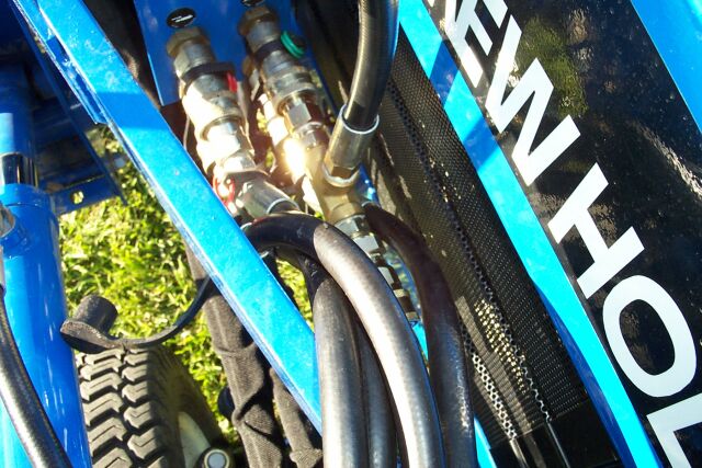

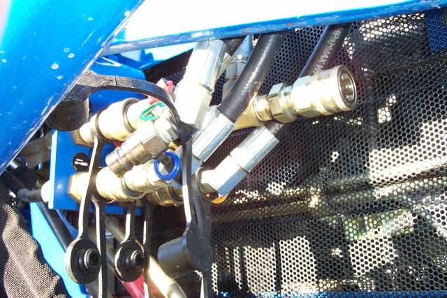

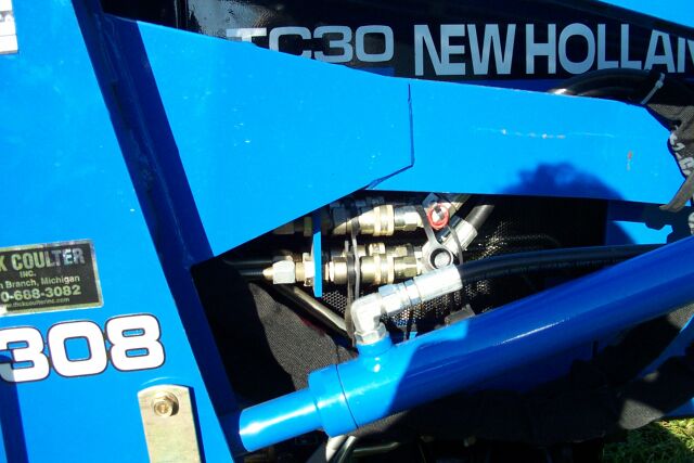

Ok, here is some info.
SV of tractor showing valve and hose connections (TC30)
   / NH 7308 Loader Owners #23
Closer up view
   / NH 7308 Loader Owners #24
TV (top view) of valve

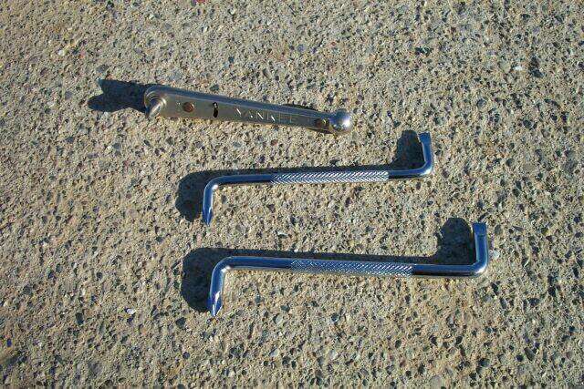

   / NH 7308 Loader Owners #25
If you are really talented you can adjust the setting without taking off the metal valve cover. if not, you will need some bendy tools to get at the screw on the side of the cover.

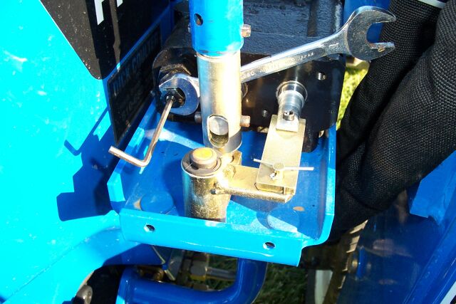

   / NH 7308 Loader Owners #26
Using a 1/2 in wrench and allen wrench at adjustment point.

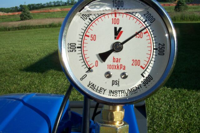

   / NH 7308 Loader Owners #29
First reading. Note, the instructions call for running the engine at a high rpm (2600 I believe). I found that running and testing at this rpm produced a spike in pressure of an additonal 300 psi which then bled down quickly to the relief pressure. I tested mine at my usual operating speed of 1500 rpm and got the same reading without the spike. Test yours as you see fit.
