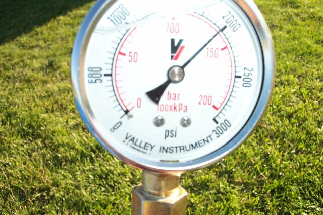

Ok, this is the happy place I have stopped at. 2000 psi will still just barely lift my wheels off the ground and I am now triggering the valve relief before the system relief (was not before). More comments tomorrow /forums/images/graemlins/grin.gif

Ok, some thoughts.
1) When testing at 2600 rpm, the gauge would read 2500 psi and then quickly drop to 2100. Testing at lower rpm produced the same reading without the spike.
2) At the 2100 psi setting, the system main relief was the only one being triggered. With my new adjustment, I still have additional power (over factory spec) but I am triggering the loader valve relief now.
I'll be shipping the gauge setup out today.

<font color="blue"> 2) At the 2100 psi setting, the system main relief was the only one being triggered. With my new adjustment, I still have additional power (over factory spec) but I am triggering the loader valve relief now. </font>
Warning...rookie question ahead. /forums/images/graemlins/grin.gif
How do you tell the difference between the system relief and loader relief valve? Perhaps I've never tried to do too much and triggered either one.
What would I notice or hear if one of these valve reliefs were triggered?
   / NH 7308 Loader Owners #36
Sorry MIke, perhaps I should explain myself more clearly. The loader valve relief makes a different kind of sound than the system relief. The reliefs are physically about 3 ft apart. On your TC25 you should hear a low hissing kind of sound next to your right hip when the loader valve is in relief. The other relief (main) is near the front of the engine block. I think there is another relief for the 3-pt and another for the hydro trans (just guessing here). Hope this helps.
   / NH 7308 Loader Owners #37
<font color="blue">Hope this helps. </font>
Yep, thanks!
