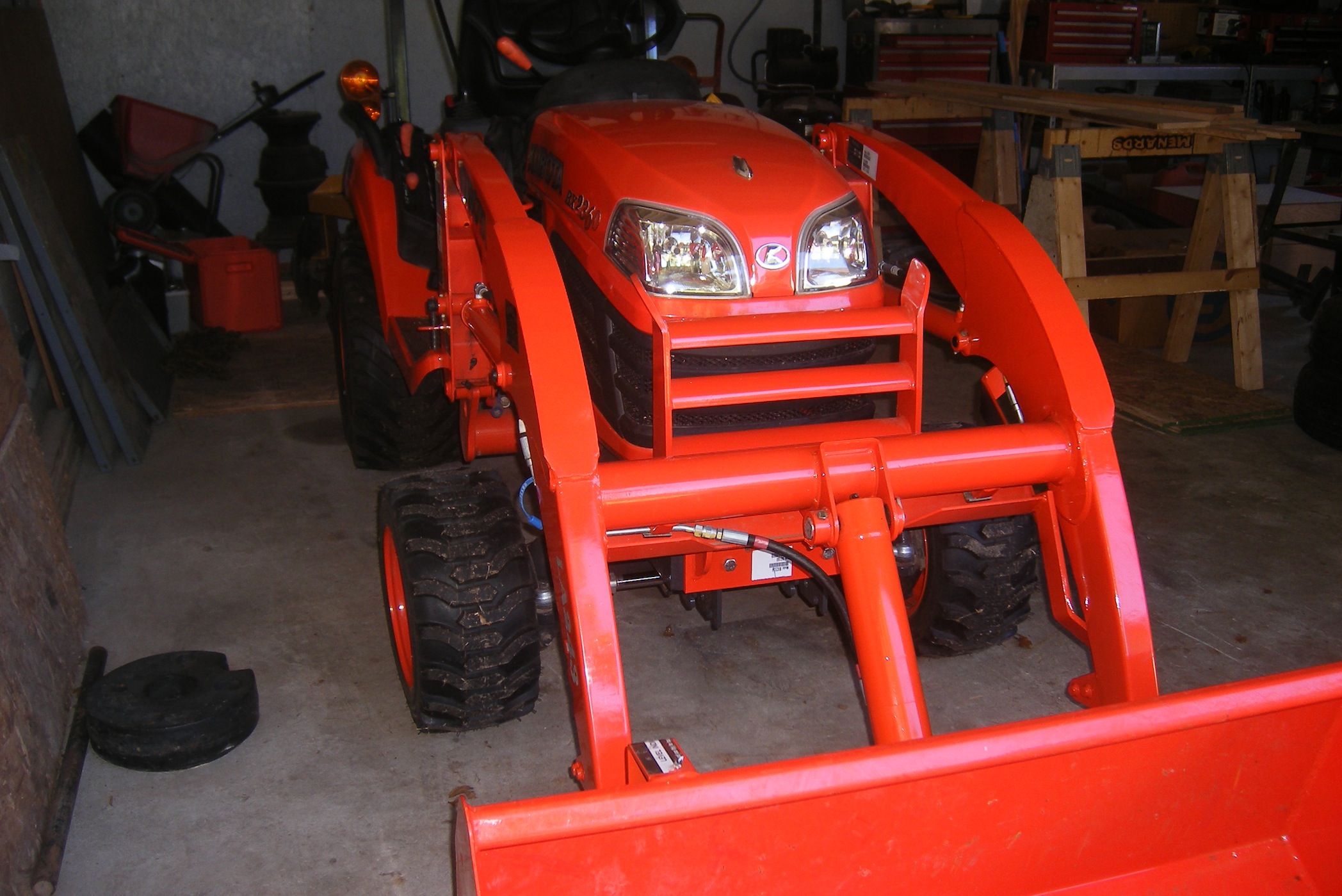

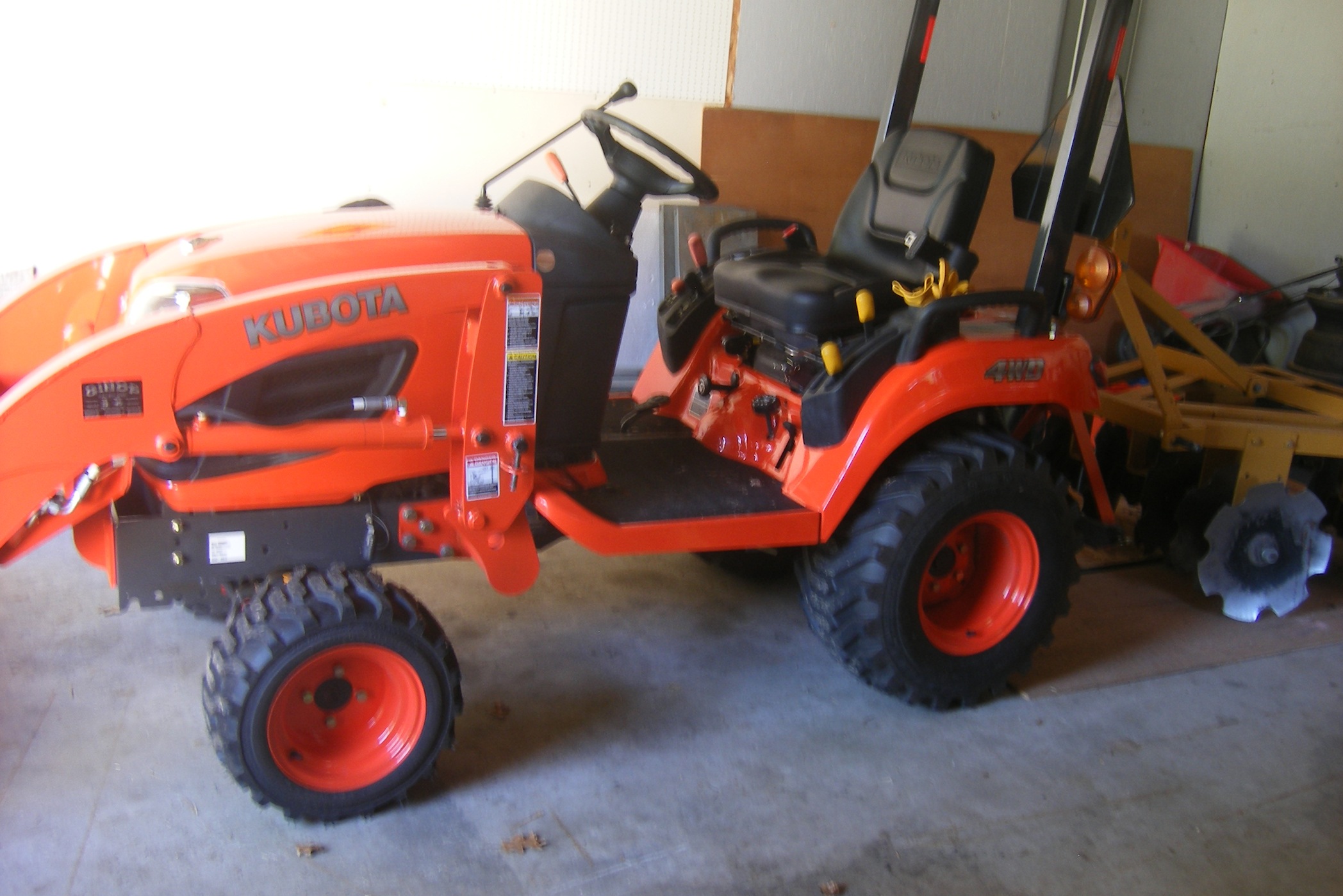

40 hours later and 6 months of flawless work.
Still lovin' it. Really, really am enjoying it. Know you all love photos, so I shot a few today as I had the camera in my hands.

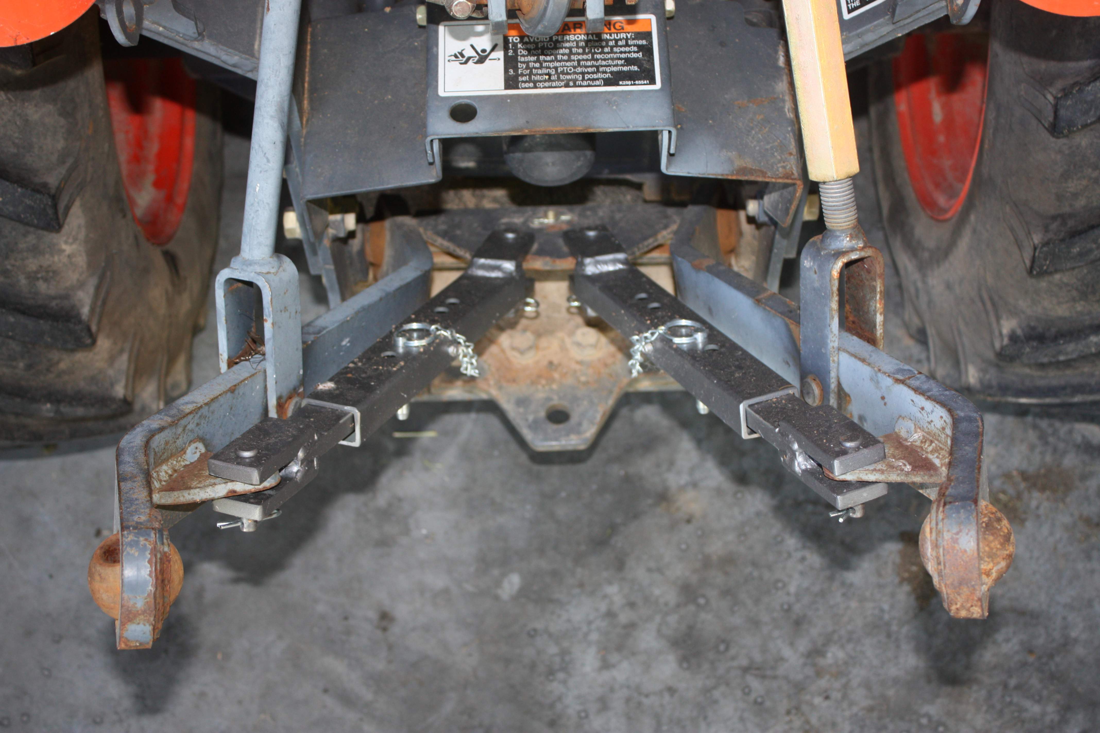

You can see those Mark Hodge lower 3 pt stabilizers on that one photo. Best addition ever.
   / One Of The Last - Back To A BX #47
bp, can you give a little more detail on the value of the 3pt stabilizers you added? What do they do for you more than the standard links that come with the Kubota hitch kit?

Glad it's working out so well for you, I am a big fan of the BX and also love the Hodge links.

The standard B Kubotas also have the turn buckle style stabilizers. The BX version is particularly cumbersome to adjust. It is very time consuming to loosen the turnbuckles to left go off an implement. Then, after mounting a different implement, what a pain to tighten again. The purpose of a the stabilizers is to "lock" the implement in place, in the center, between the tires of the tractor. If the implement is sloppy and swings from side to side, the stabilizers WILL get bent and the 3 pt arms can run on the tires. Plus, the implement isn't locked into an accurate position for accurate work.
The stabilizers shown above are a HUGE improvement. Simply pull the pin and the two parts slide. Opening the lower arms to their widest position takes just a second or two.. Done. Same with locking them down, once the implement is on.
Incredibly easier than the turnbuckle system. Hope that helps.

Thanks for the explanation. Yes, the turnbuckles are a pain and they work loose on me. I want to look into a quick hitch system but not sure how effective that will be as I find myself changing between my BH, rake, and back blade.
