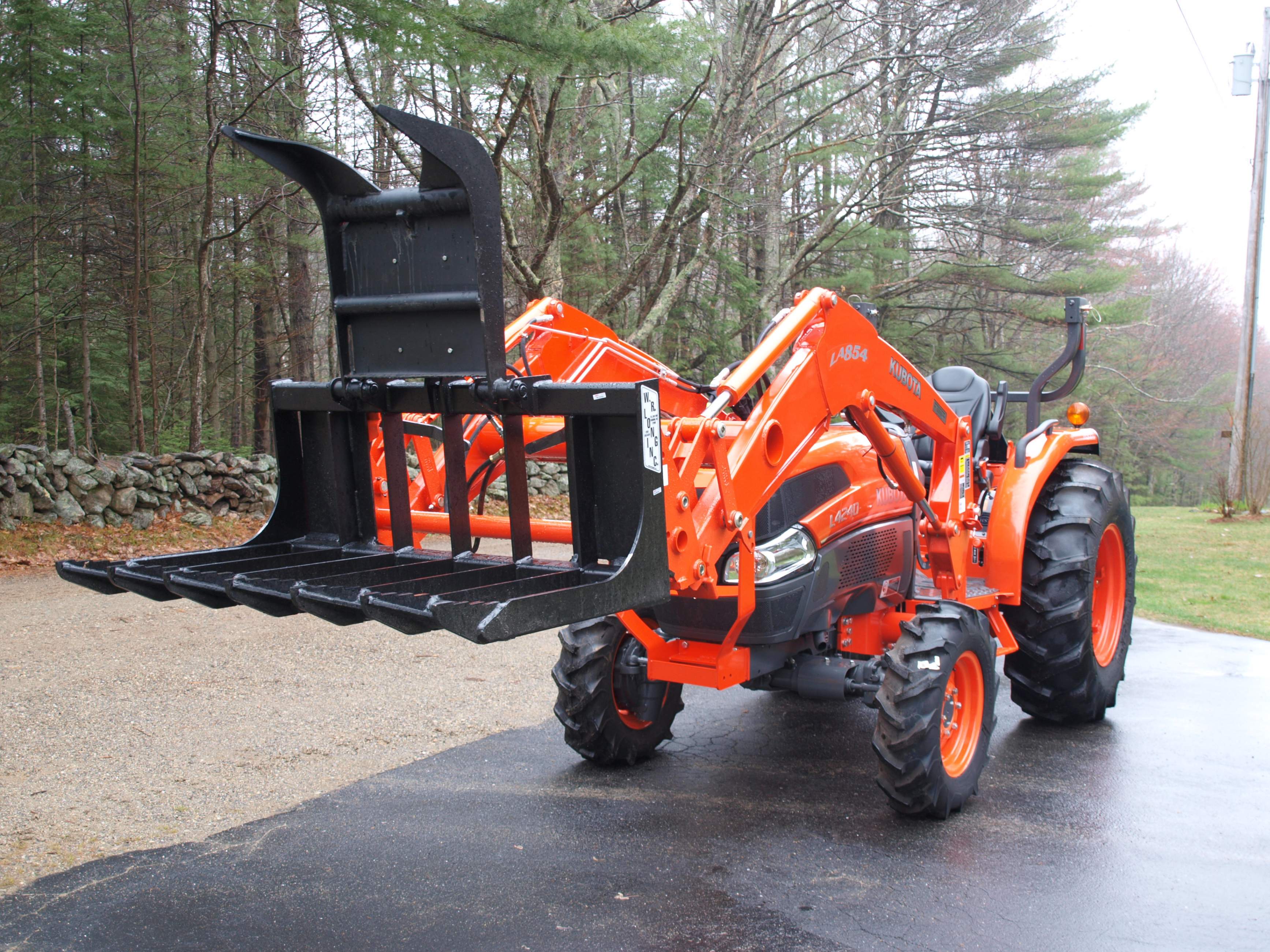

Good choice, I'm pleased with my WR Long OBG2-48 on my L4240 and it should be a good match for your B3200. Here's some pictures to look at while you wait for delivery & to maybe give you some ideas for a brush guard design. I haven't added one to mine yet either but can see why it would be a good idea.

CB...Nice set-up you have, thanks for the pictures. They have me anxious for mine to be done. I dropped it off on Sat and should have it back this coming weekend.
