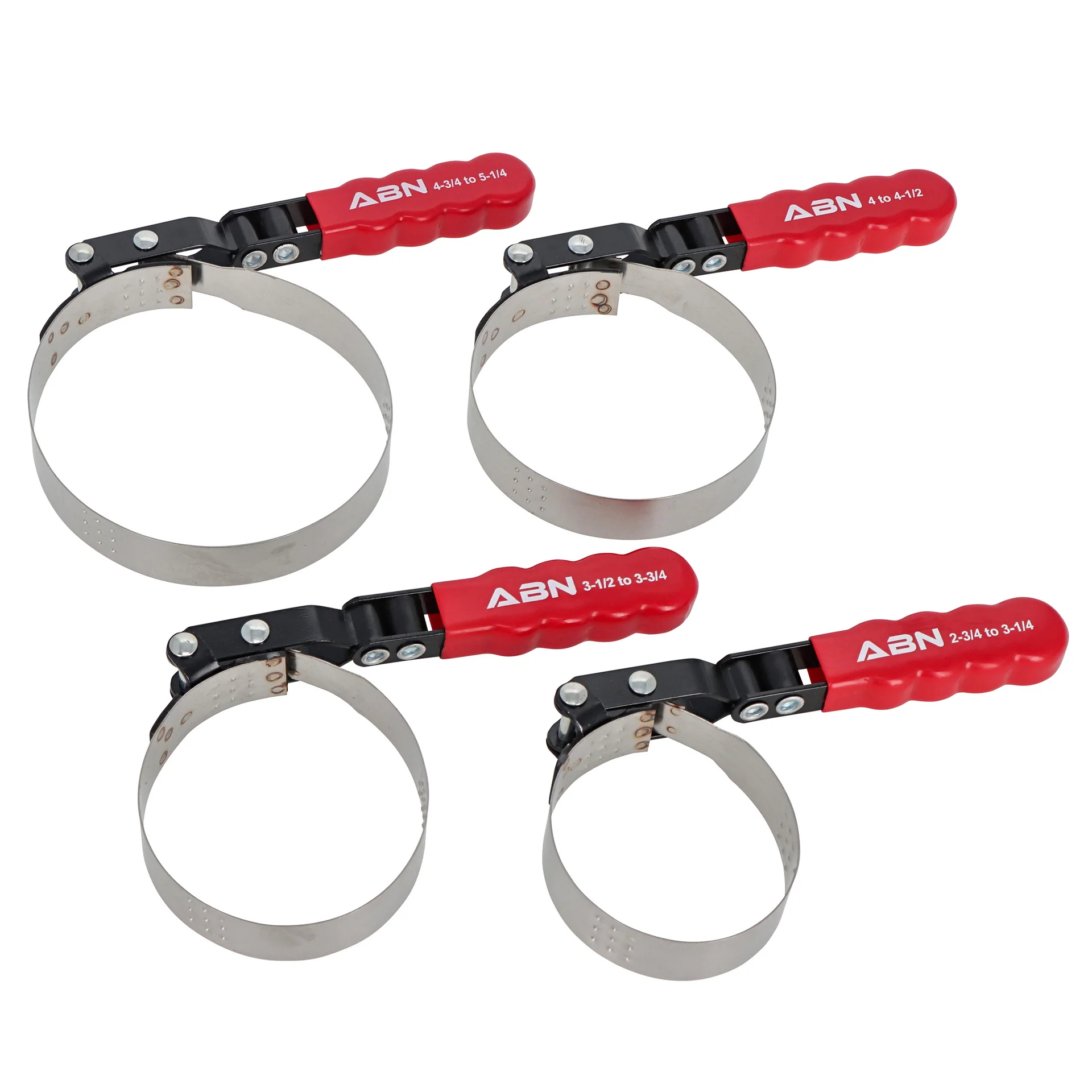

I have yet to fail removing a filter when using a simple band type filter wrench in the correct size, and it's been hundreds of them.
But no, not the strap kind, but the all metal versions. No idea why more people don't use that kind since they're so effective. I must have a dozen different filter wrenches, but rarely use any of the other ones.
   / original hydraulic filters wont come off. #58
Same. I have two in different sizes, which must be 50 years old, and they always work. They're great for mowers and tractors, where you can usually access the filter from the side, but not so much on modern cars.
They're pretty much identical to these, for anyone who hasn't seen one, and the handles pivot to get into tigher spaces:
In the case of OEM-overtight filters, I've had my metal strap wrenches crush the fitler can, but they never lose grip!
