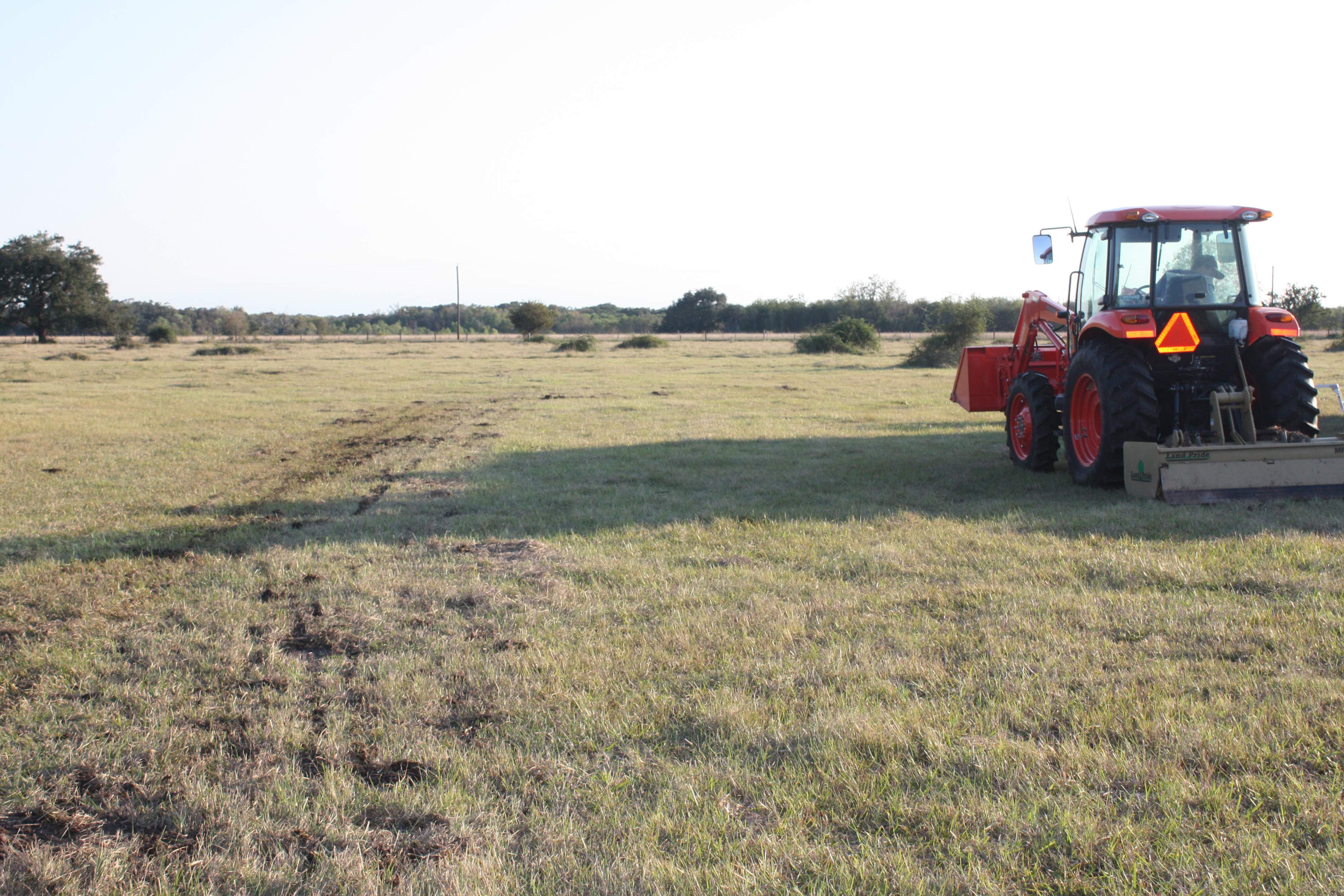

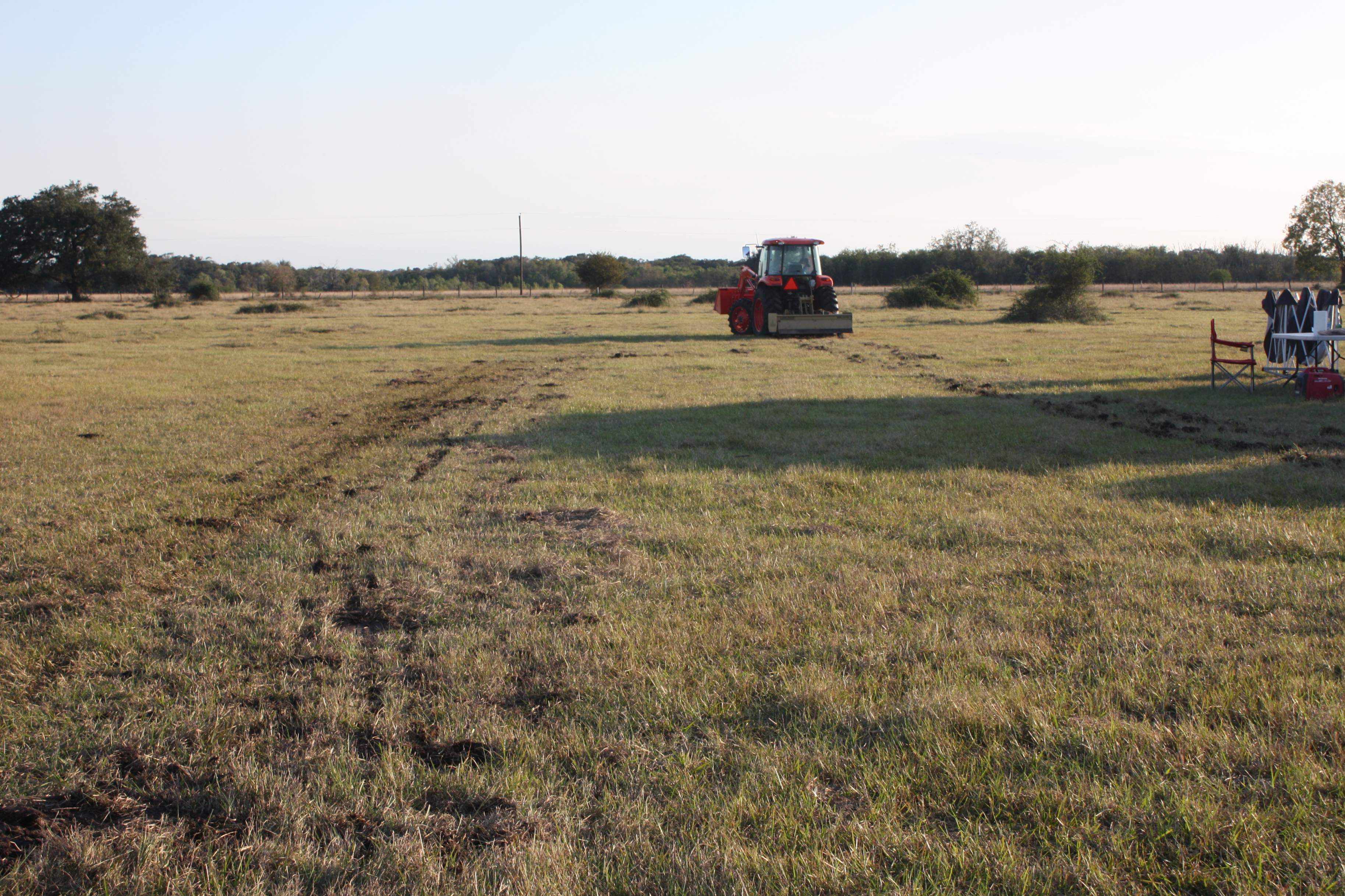

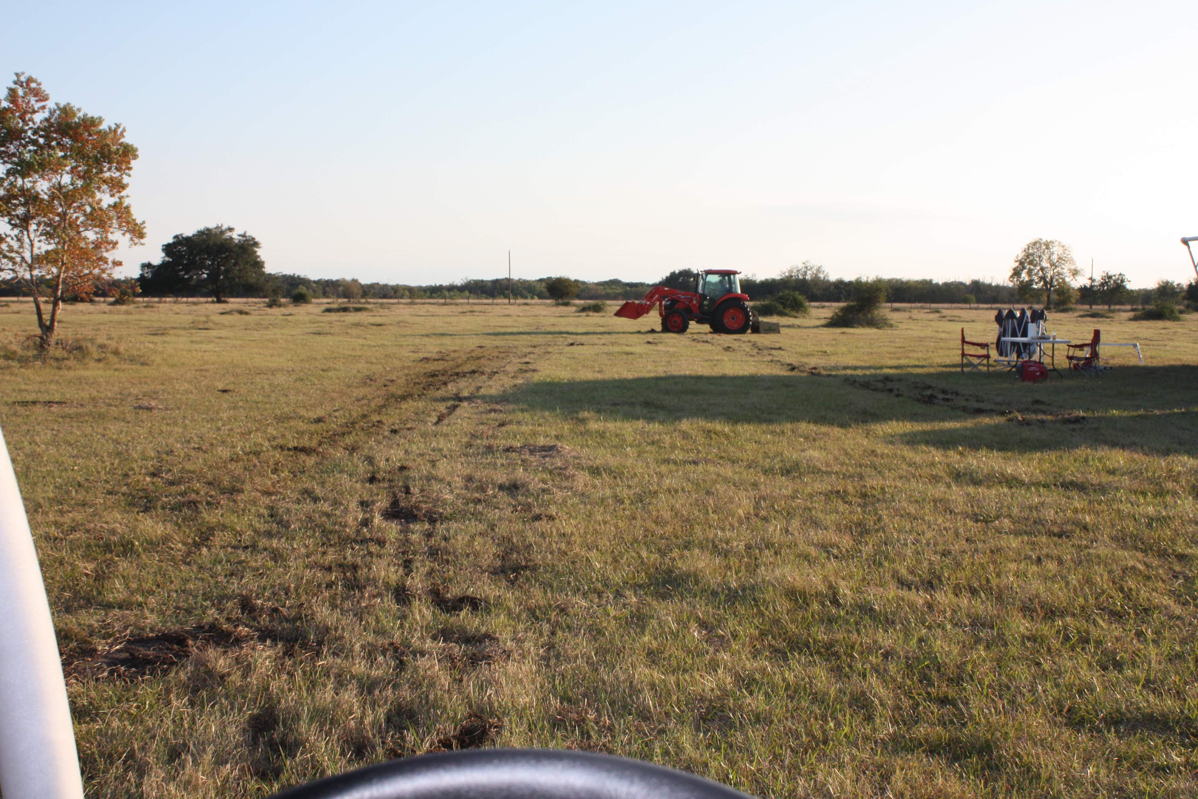

Here are pictures from this last weekend. Once the vegetation (grass) was dead - the blade worked much better

This was Sunday morning - I did a little more that day - I'm pretty much done with clearing the site - I might do a little more this weekend - then I'm going to spray the crap out of it with Roundup - then I'll order the select fill.

Don't feel too bad about not penetrating with the box blade. If you're trying to remove the grass, it's going to take several passes with the rippers until the grass gets all pulverized into smaller clumps. Until that happens the blade will just skim over the top. Put the rippers all the way down and make several passes perpendicular to each other. Once you tear the grass up and remove it you'll start moving some dirt. Also don't know how heavy you box blade is but if you can get some weight on it it will also work better. (I have two elevator counterweights strapped to mine, about 150 lbs each. Helps quite a bit).
