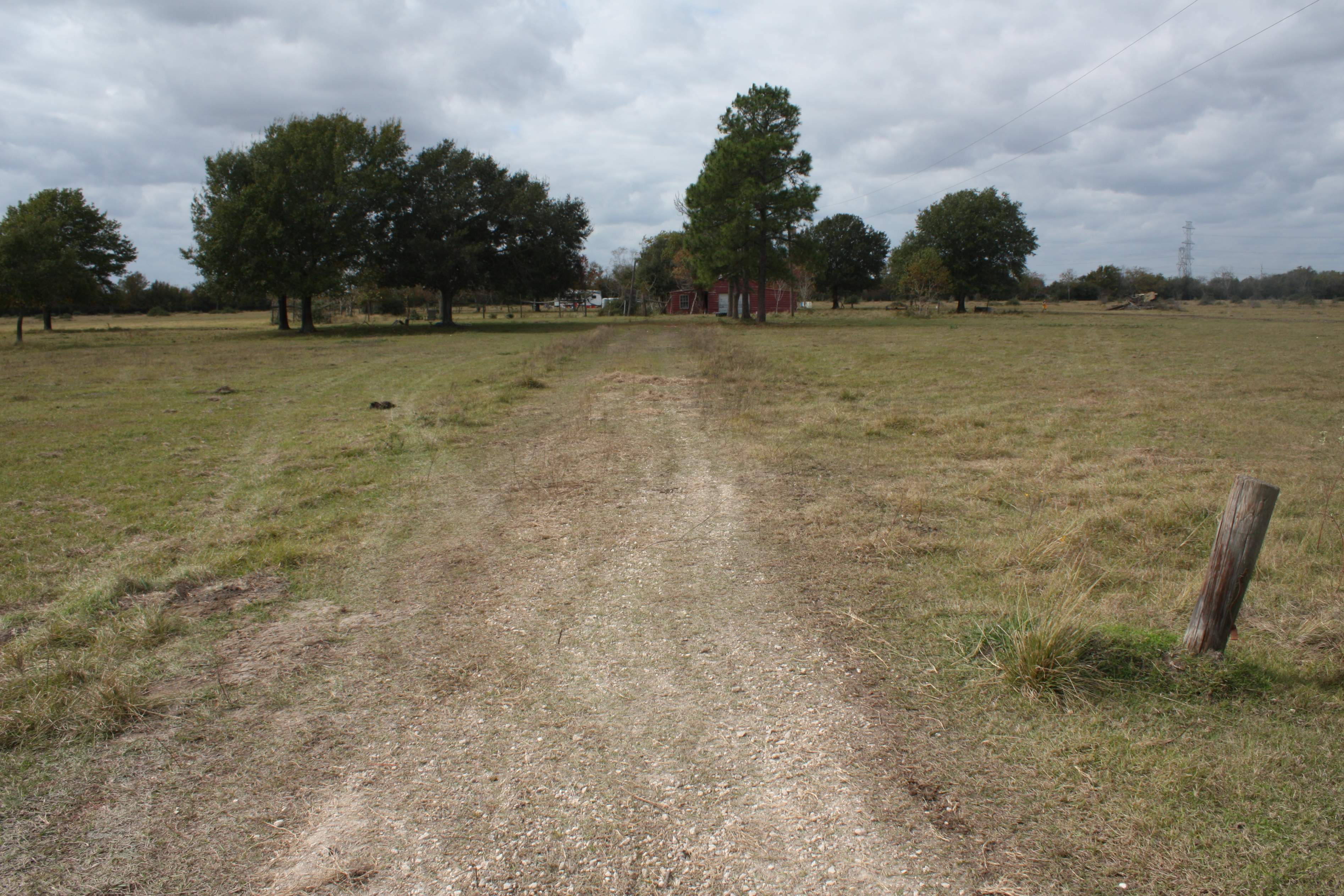

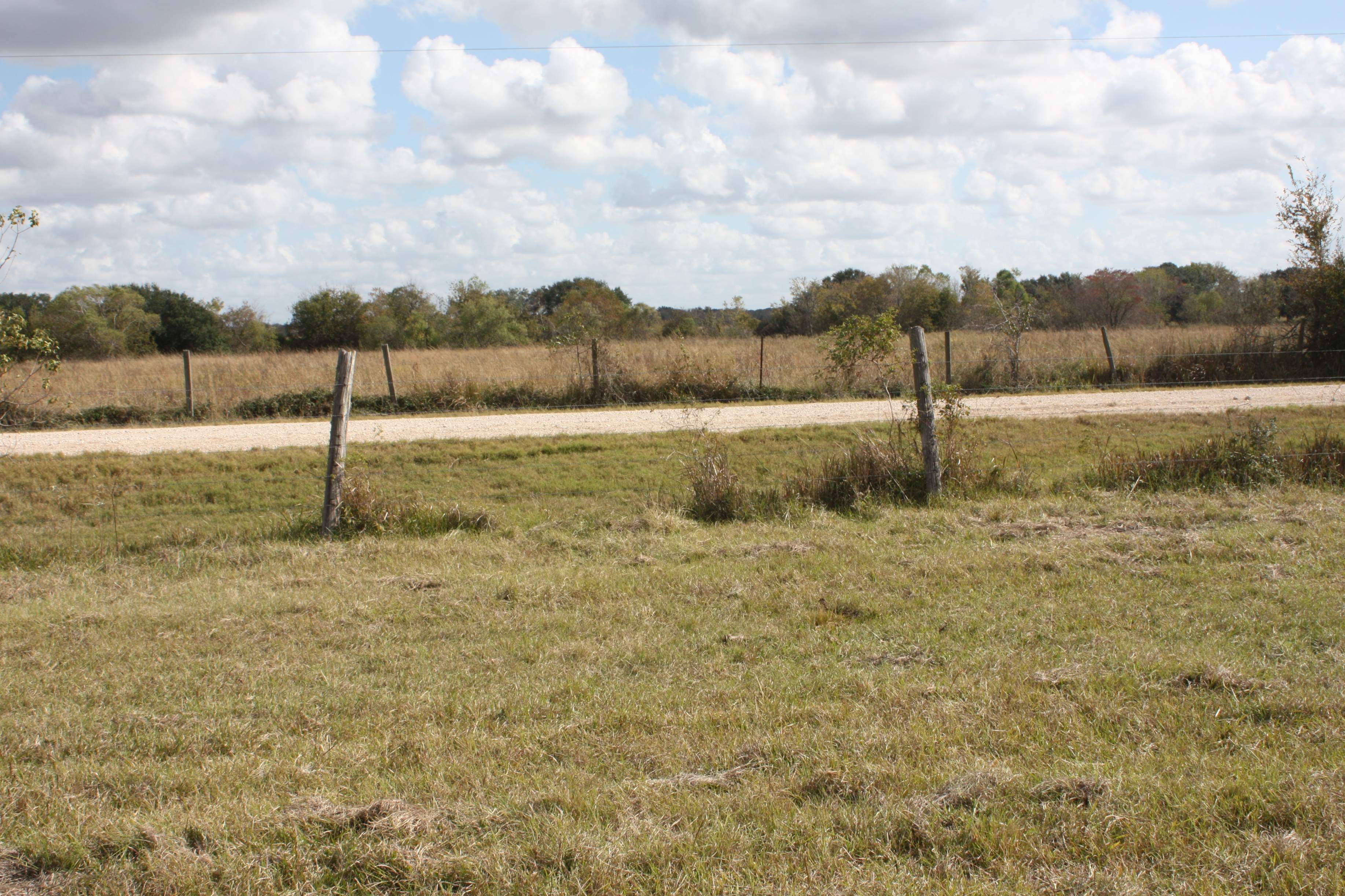

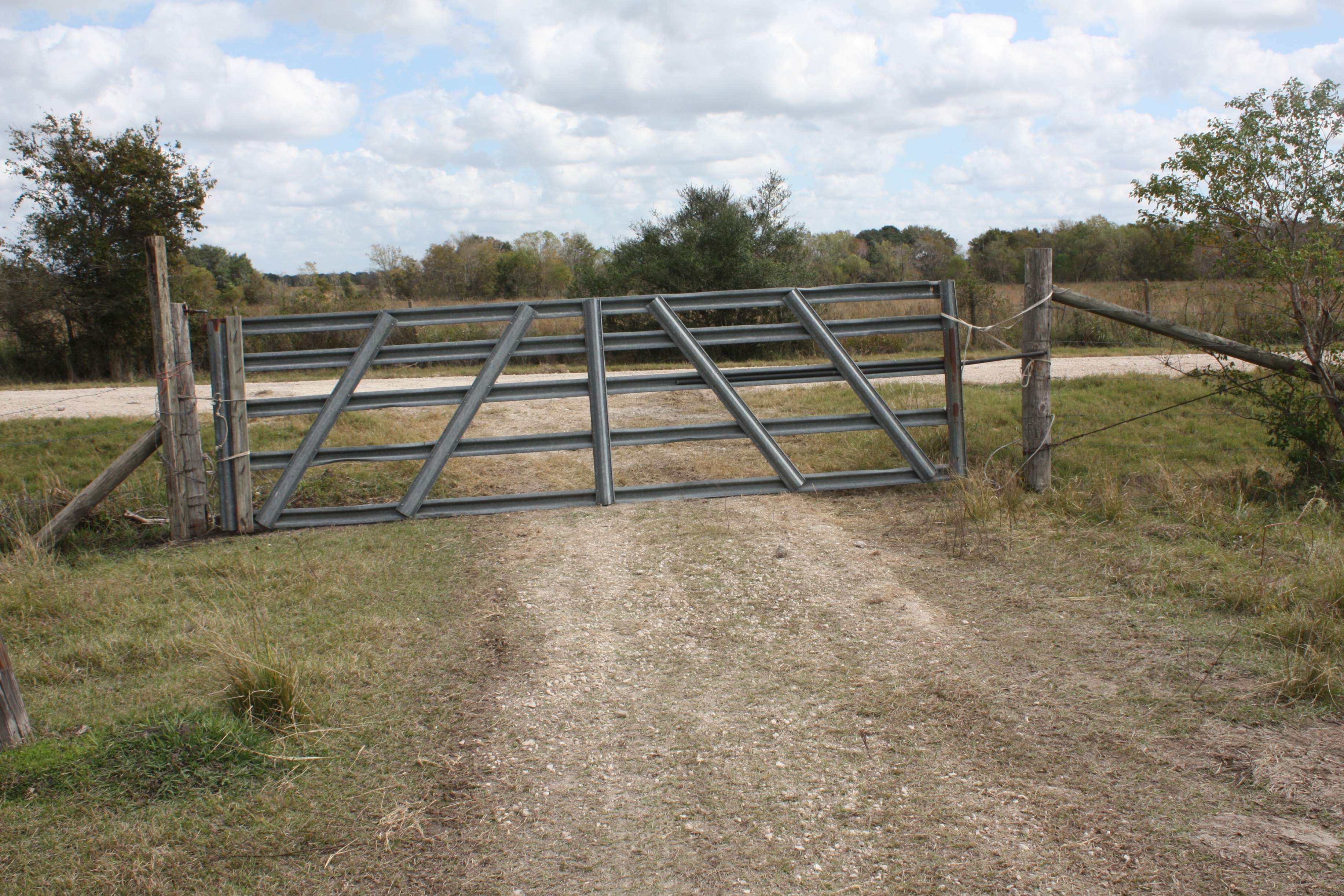

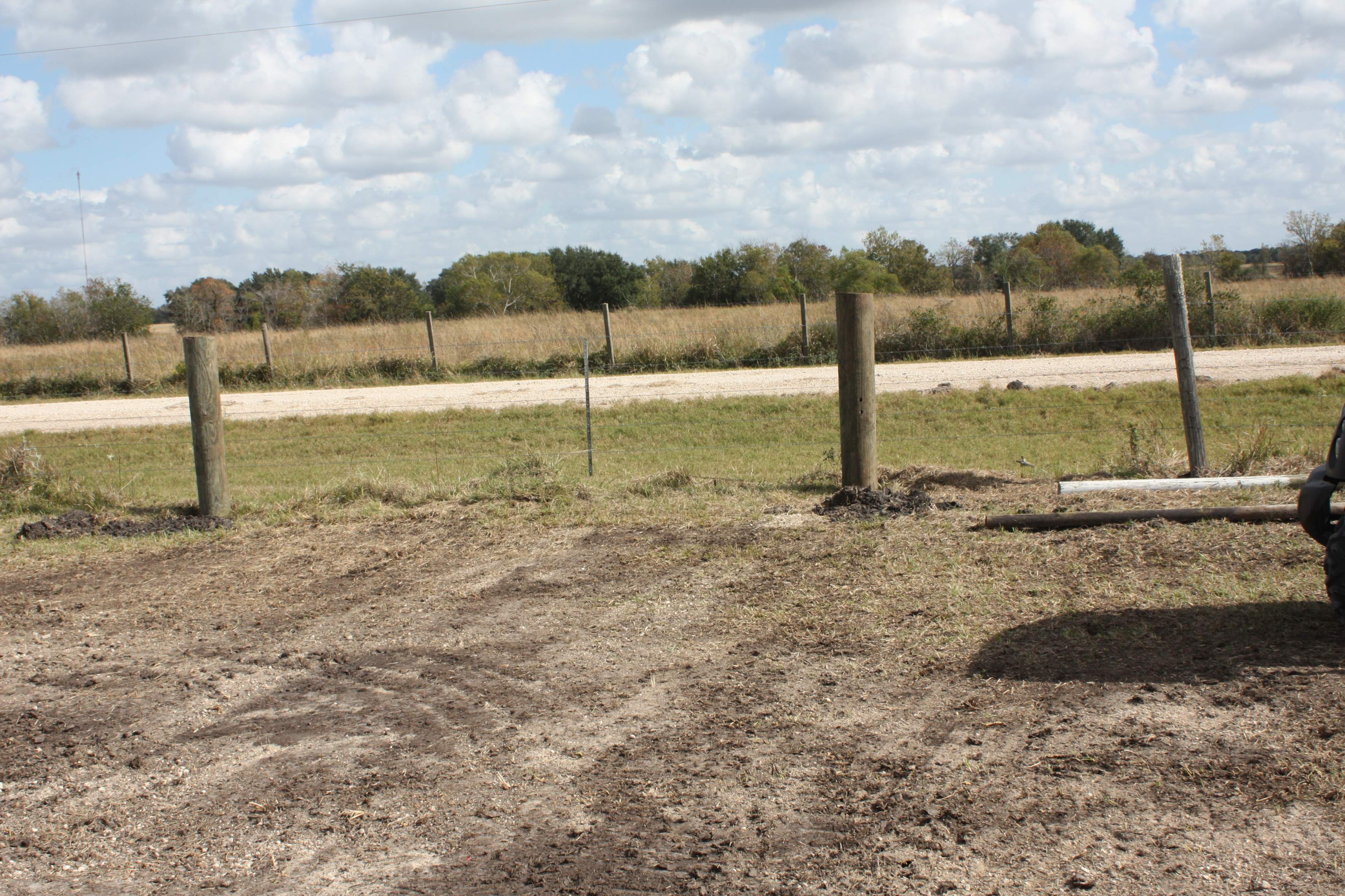

This morning I went down to the Road & Bridge dept - I paid the $150 fee for the culvert permit (includes labor/material/installation - but not the pipe) - they referred me to MDN in Beasley for the pipe - 18"X20' @ $255 plus tax ($100 cheaper than McCoys) - they also told me to go check my main road; luckily I had my camera (they were installing all new gravel this morning). I am very impressed with the people who work for our County.

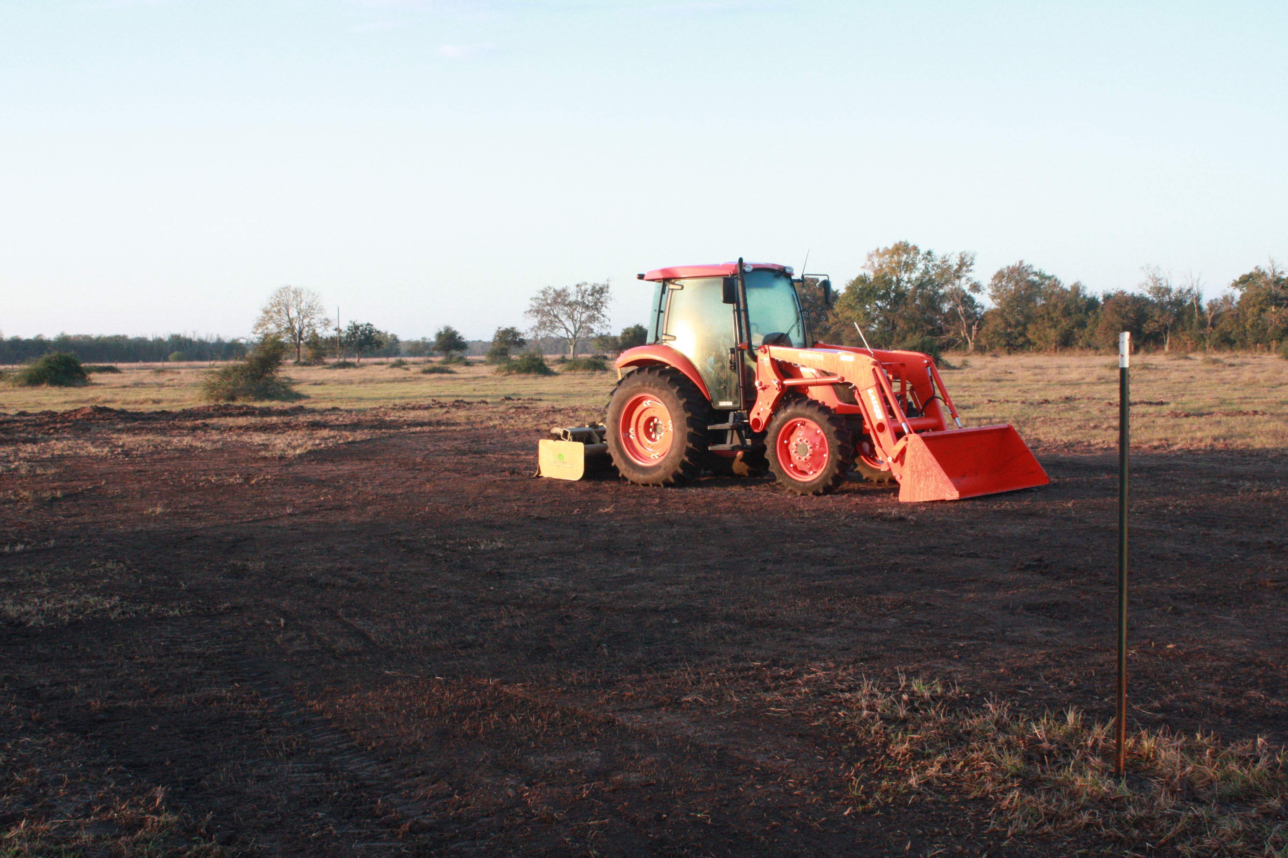

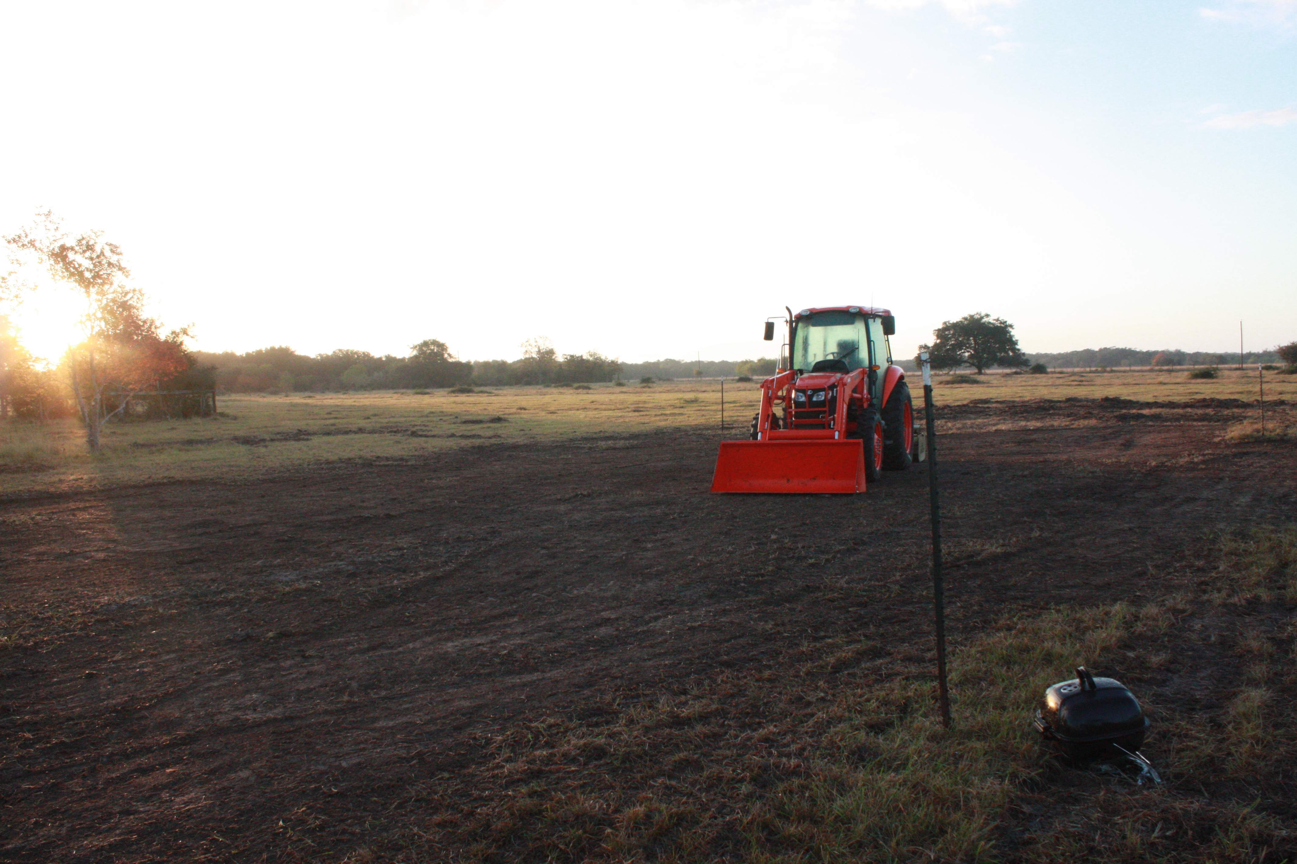

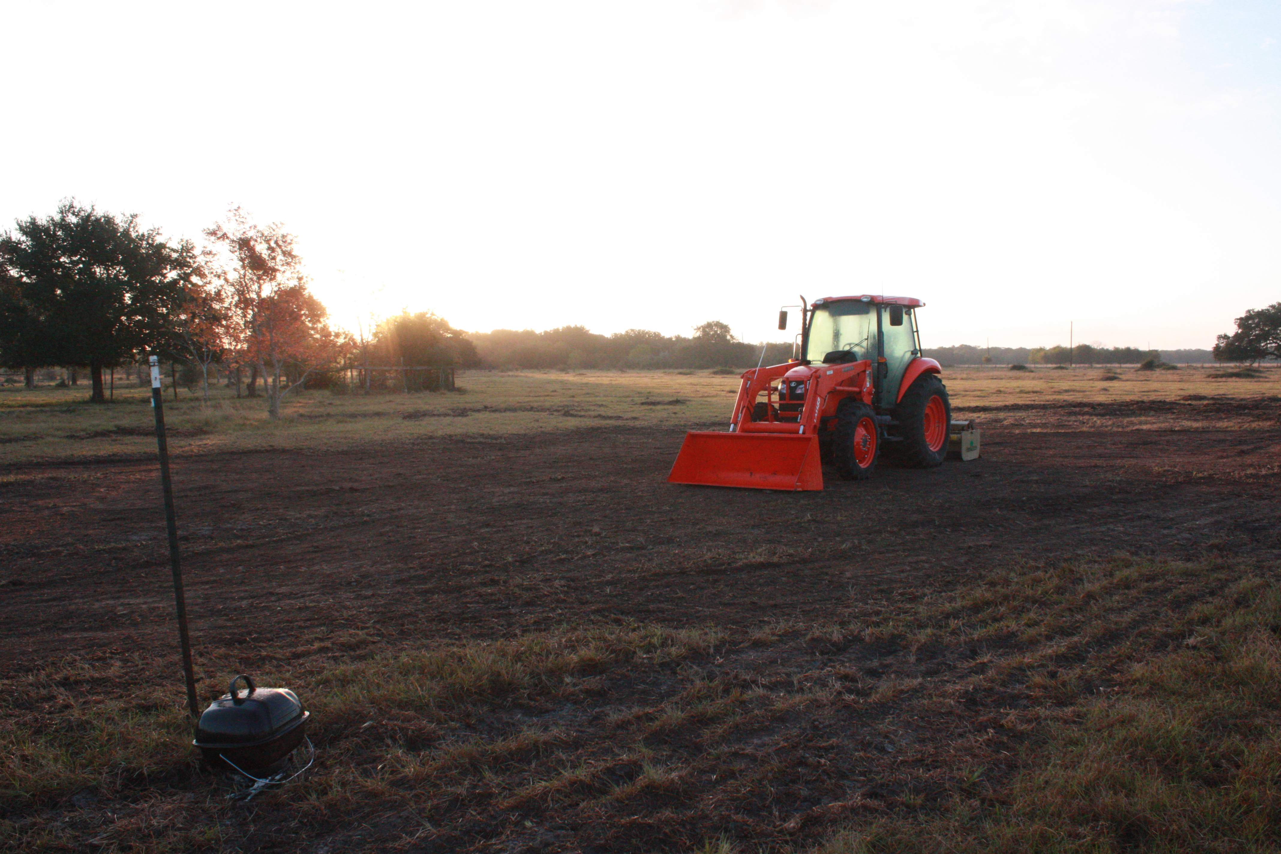

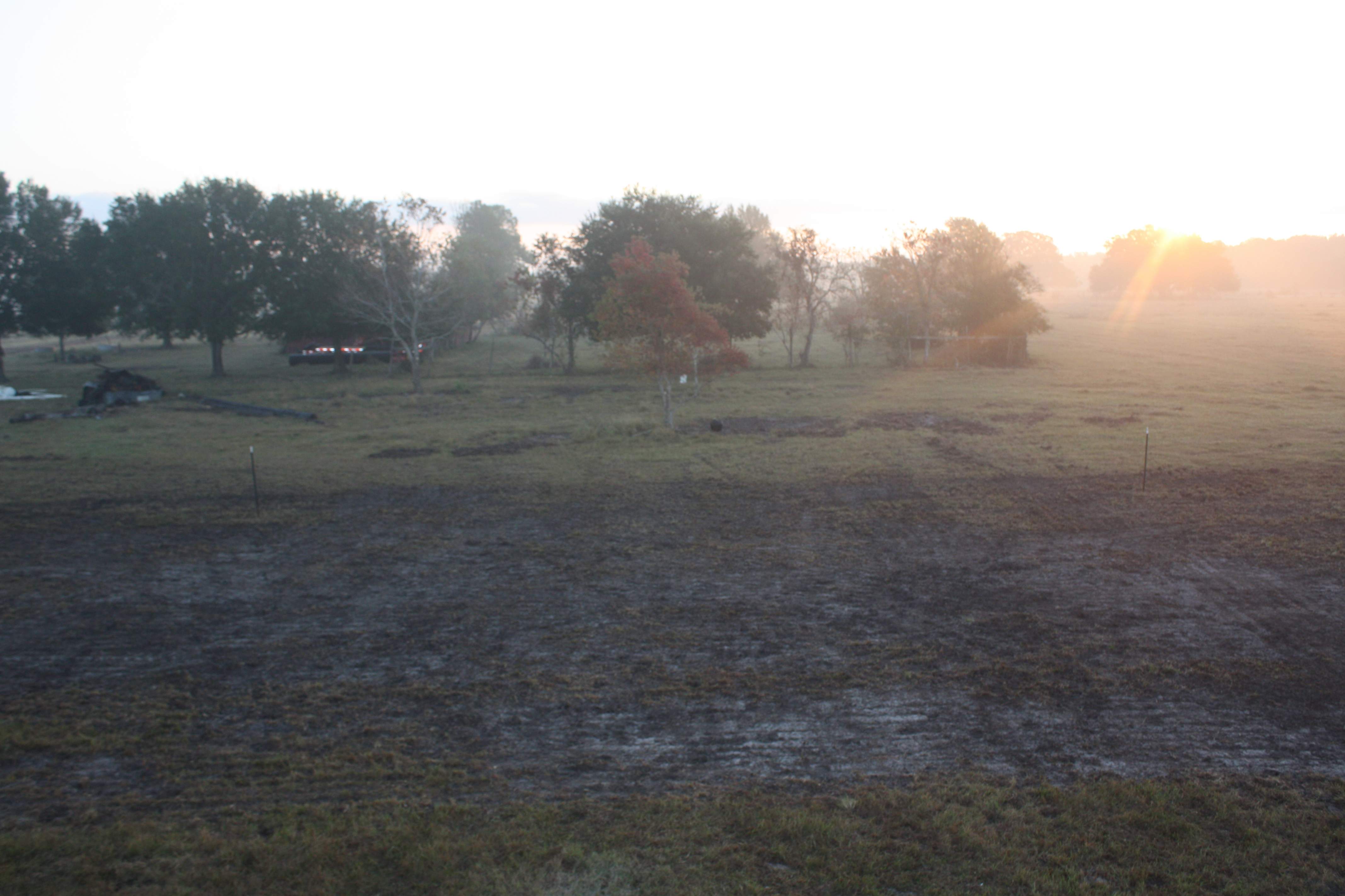

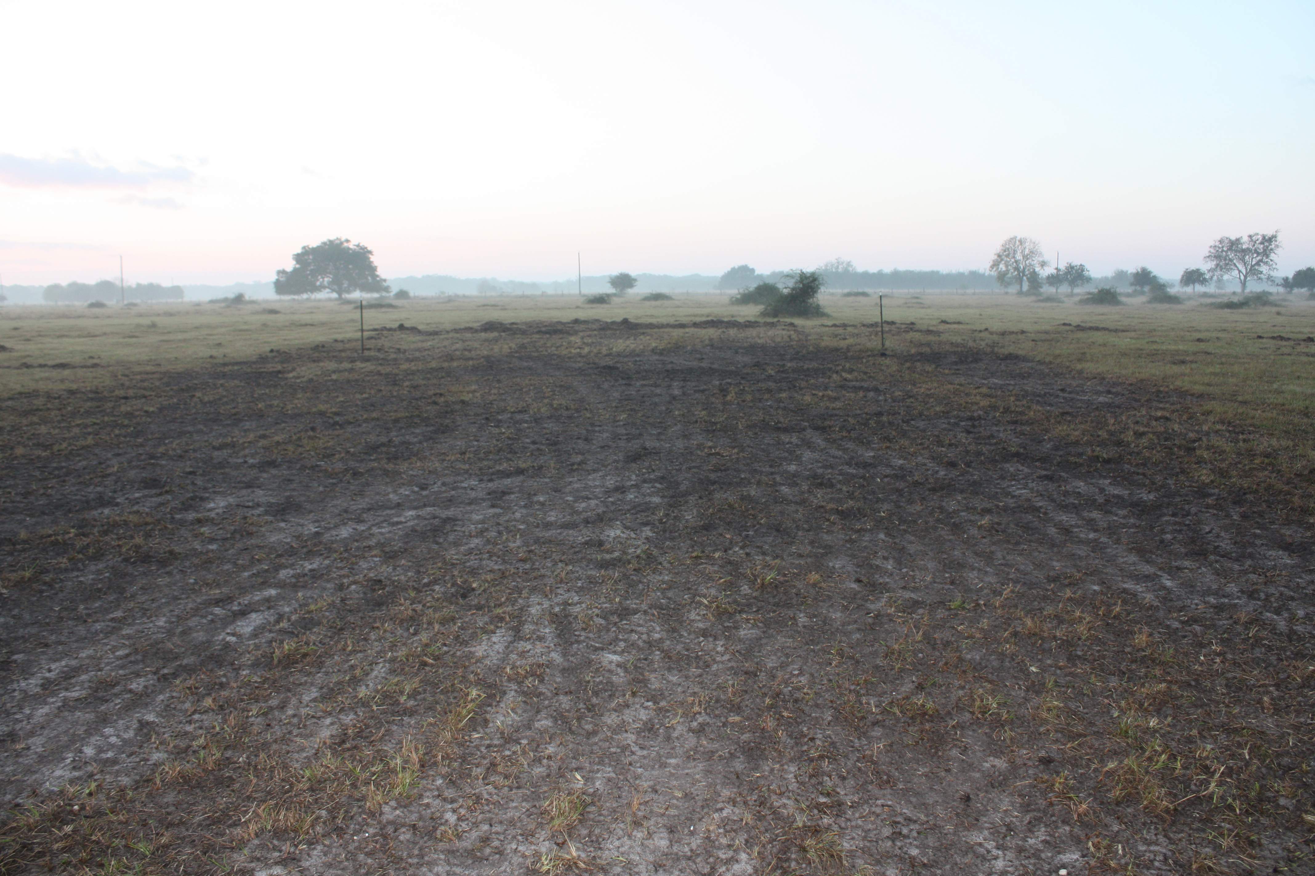

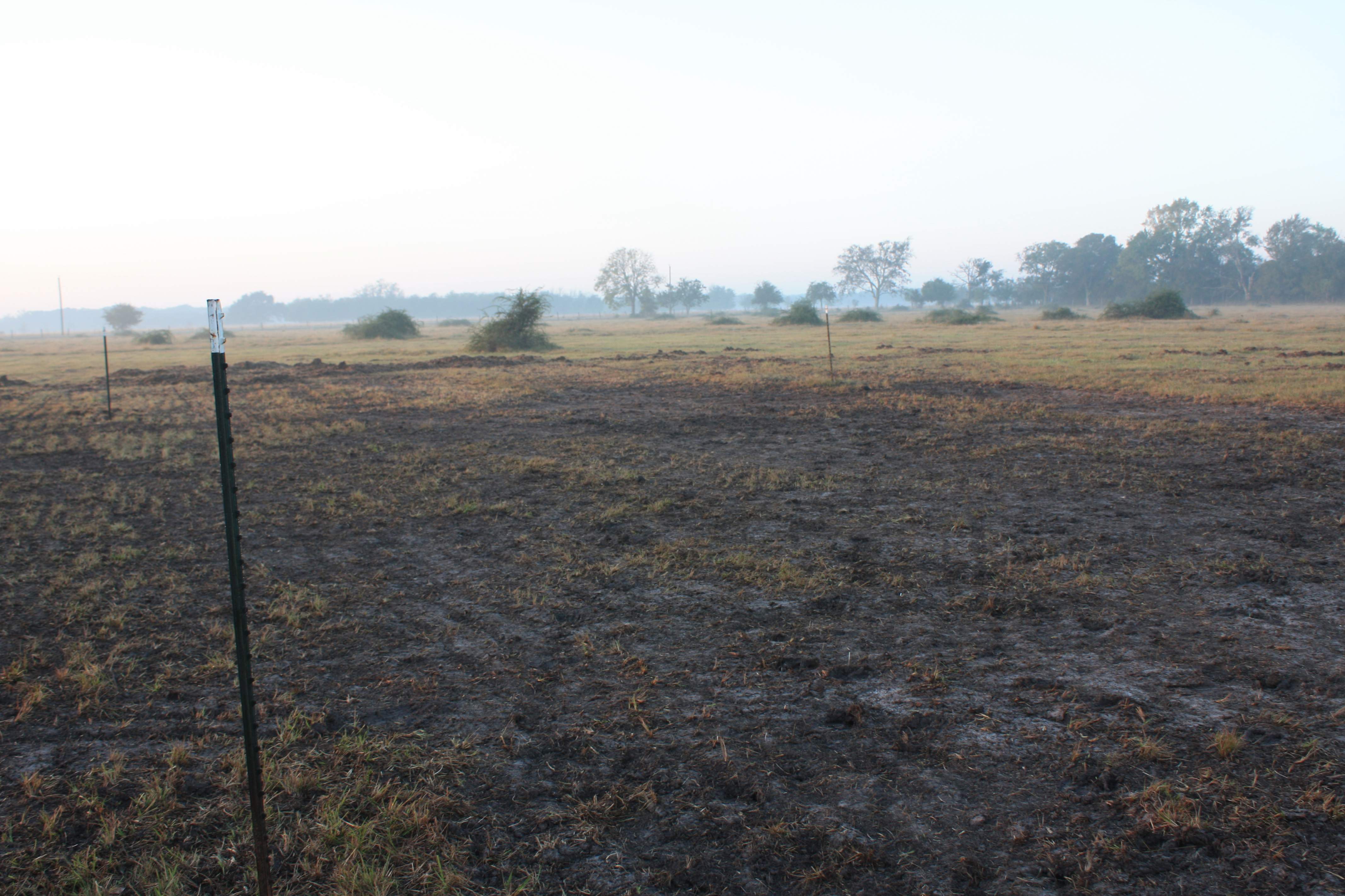

It should be approx 150 yards (assuming worst case). I got there as the sun set and took a couple quick photos. Then I spent 2+ hours (felt like 5+ hours) trying to flatten it. It isn't easy; I kinda wish I knew what I was doing. Anyway, I'll give it another try tomorrow night - then I might have to hire someone to finish it up.
You need something heavy to spread and pack that fill. Like a full size backhoe or dozier. Then it needs to rain on it and it settle before erecting your building on it. That way it won't settle when you pour concrete and your concrete crack.
