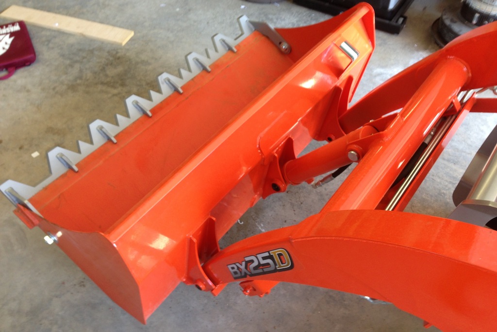

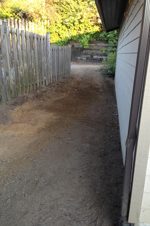

All I can say is wow! Came UPS this morning. Installed it with a couple of 3/4in bolts (have to drill two holes, one on each side of bucket). Quick work and wow does it dig! This was awesome in lowering my grade around my garage. Cuts in rocky hard soil. Scooped loose dirt, 3/4in gravel, so much better than the straight edge. If anyone is wondering... definitely worth it! Here is a pic finish graded. Used to be home to several fir trees, ivy, misc concrete fence post bottoms, etc. Now smooth and level. :thumbsup:

I agree. Deere dealer told me not to install one it would be hard on the loader. I went for 2 years with just the bucket doing lots of dirt work and always having trouble holding grade. Now it cuts so smoothly and the transmission feels like its working about half as hard. I wouldn't hesitate to buy another one. I think it reduces stress on the loader frame.

Very happy with mine. best accessory I have purchased so far. Loader is far more capable with it.

I have both on my B3200 and can change them out in under 5 minutes. Neither is a replacement for the other. The Piranha stays on the loader over 95% of the time and if I could only have on it would be the Piranha.
Used mine quite a bit in rocky Arkansas soil. If and when it wears down in 10 years I would happily buy another. Both styles of tooth bar have there good and bad points. For mostly dirt work, sapling/brush clearing and grading work I think the Piranha is better. If digging a bunch in larger rocks the larger longer replaceable teeth would be better.
We totally agree!
And so as not to hijack DragonEggs' thread I have to say this (and I only ever say it once per person) "TOLD YOU SO!!!"
I'm really glad you had the same experience with it that we did.
My install was a little harder due to having already bowed the cutting edge of our bucket into a mild smiley face while using it to dig and move large rocks (obviously pre-PTB).
The PTB actually brought our cutting edge back to straight, AND now protects it. The shape our bucket was in demonstrates how we hard use it.
We have really used our PTB strenuously, and have barely worn the paint off, much less worn the teeth down. Plus the toothbar profile on the PTB spreads the wear vs. individual teeth that can catch and break off.
As Mr. ParkGT said, if in 10 years we have worn the teeth down, A) I'll be very surprised, and B) I'll gladly send off for a new one.
