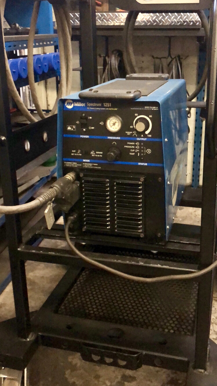

Case in point. I’m still in the process of setting up this Miller 1251.
1 1/4” @ 10 inch per minute. We shall see,but I highly doubt it!
/ Plasma cutter question? #12
Oh wow Terry!!!! I'd like to hear how that works!!!! Start a thread or something. That thing is a beast!!!! :)

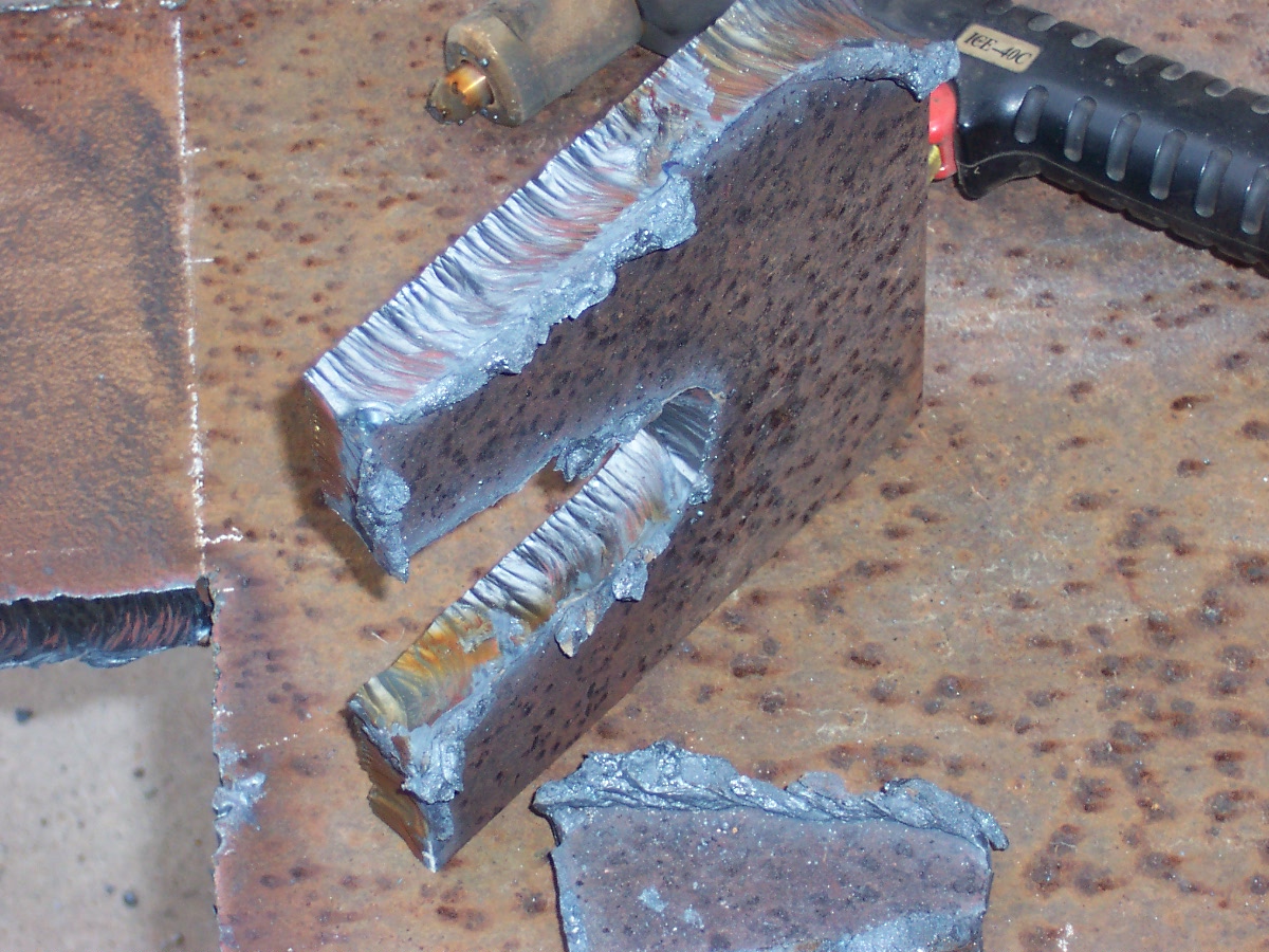

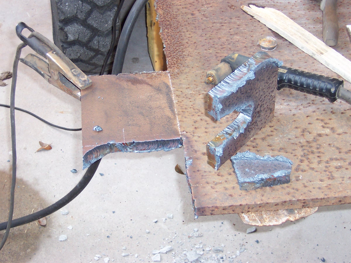

I've had my Miller 625 for over 10 years and still love it!
Pics were cutting 3/4" , it was over it's rating and very slow but it cut it.
My O/A torch is for heating only now.
