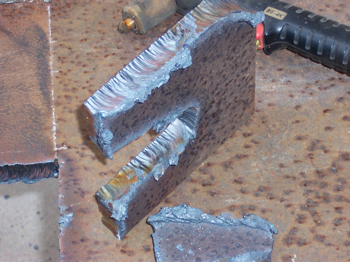

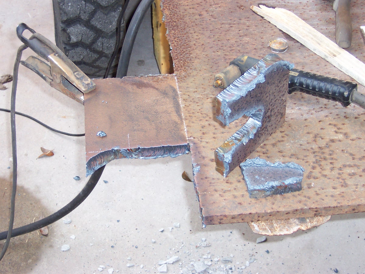

I've had my Miller 625 for over 10 years and still love it!
Pics were cutting 3/4" , it was over it's rating and very slow but it cut it.
My O/A torch is for heating only now.
I know your pain. I’ve given up trying to cut 3/4” with my Miller 625 Extreme. Anything over 5/8” I use oxy-acetylene. Much quicker.
