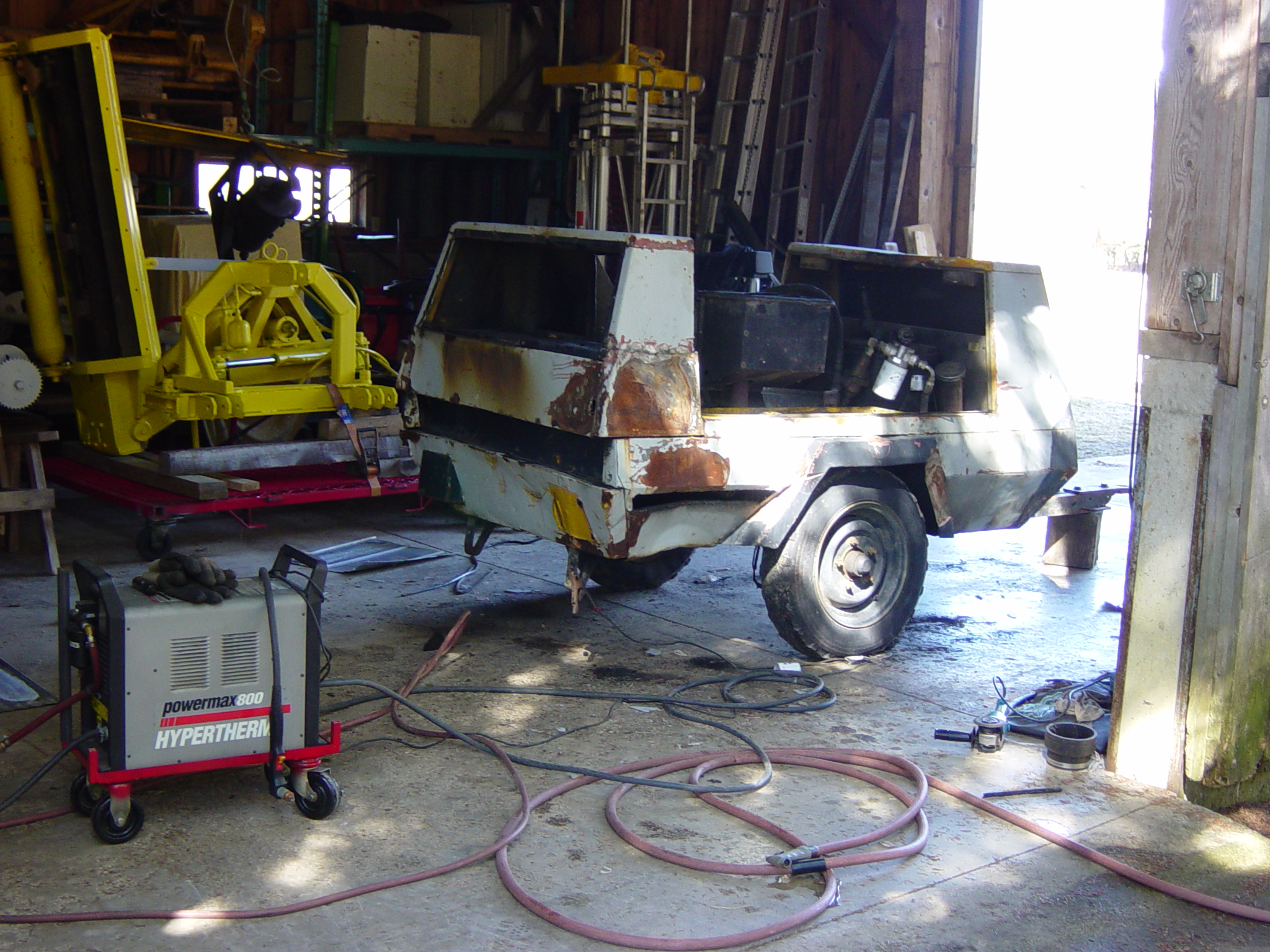

In truth, wrecking something like this is about the only thing where I have ever been totally satisfied with the plasma. Sure beats setting fire to the barn with a torch. I just noticed water hose in picture for safety.

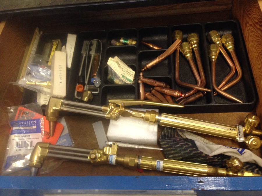

I miss the precise control and fluid movements afforded by a conventional oxy-fuel torch.
Hypertherm makes them out to 3'. I think they have 3 lengths plus a 180 degree. People use the long reach torches for cutting up the skelotons on the plas tables. New in the last few years. I always tried to get Victor to make a long one but it never happened. Once they were thrown in with ESAB the whole company went to Hel. and many of us bailed out.They came out with the new 60i that has a 2 piece torch so you can trade back and forth for automation which was a good idea that didn't work and the 60i became a flop. Now they re-released the old Cutmaster 52 calling it a a 58 in effort to control the bleeding but under ESAB rule, Doom is in the air.
