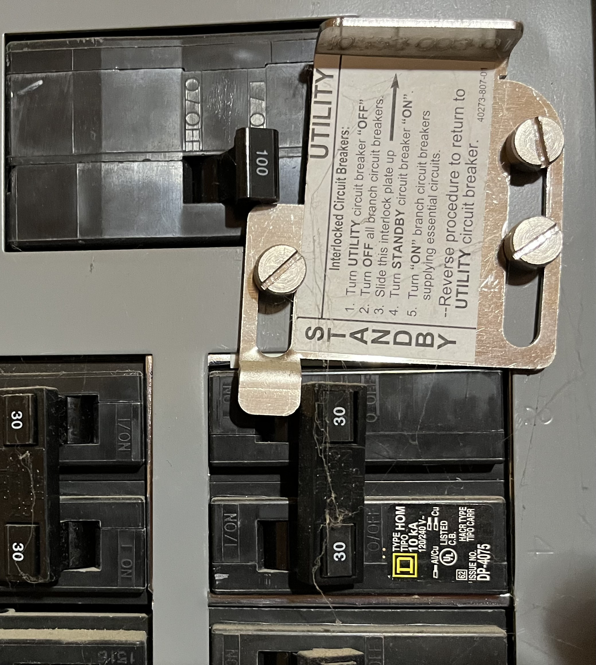

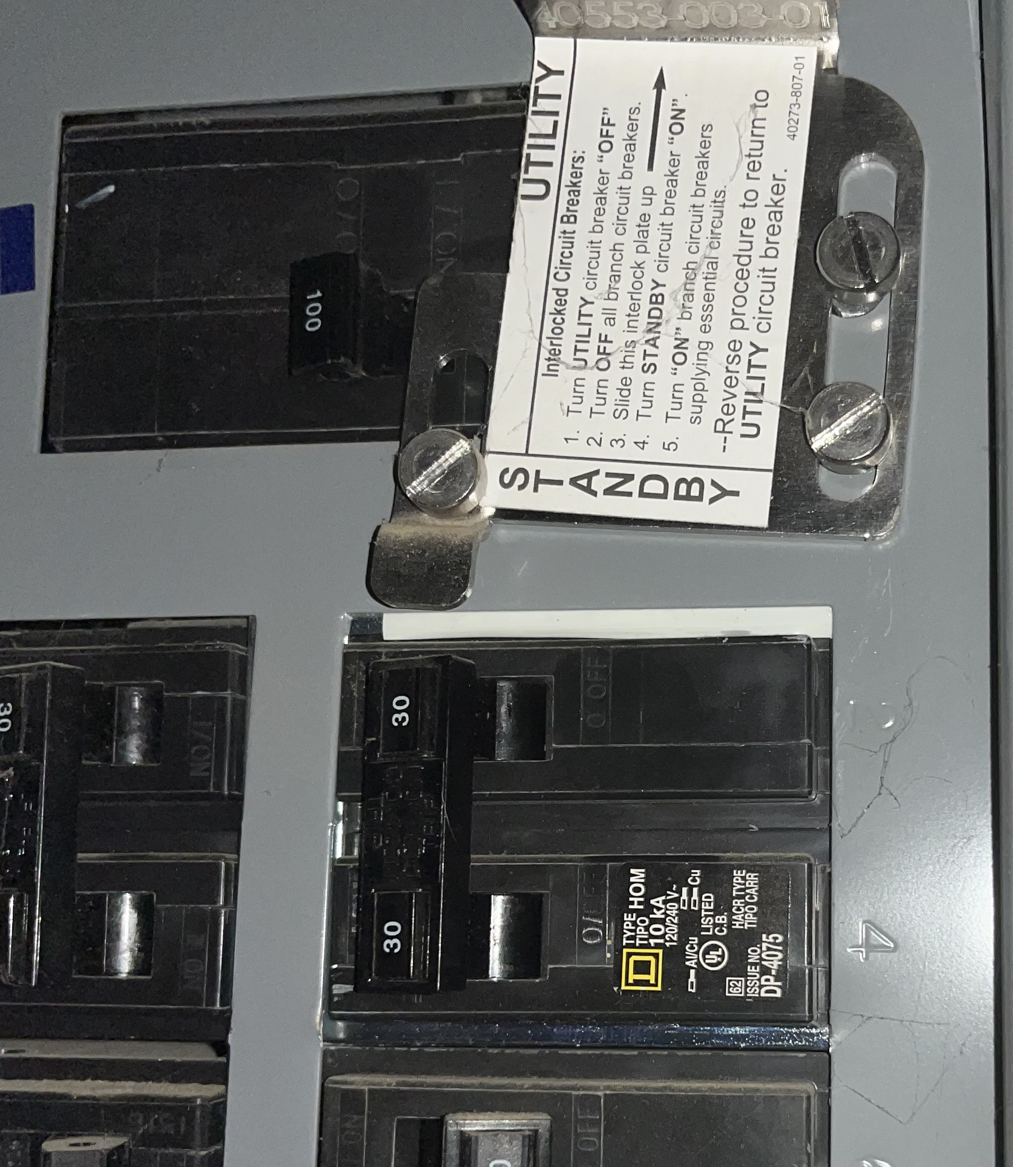

   / Plugging in generator to your house dangerous? #38
How do you stop someone from flipping the emergency breaker ON, when the main in ON?
Like this. Left side has the main breaker locked. Right side has generator side locked and main open.

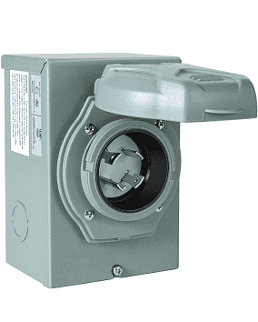

This is what you want on the house......they come in different amperages....this is a 30 amp.
