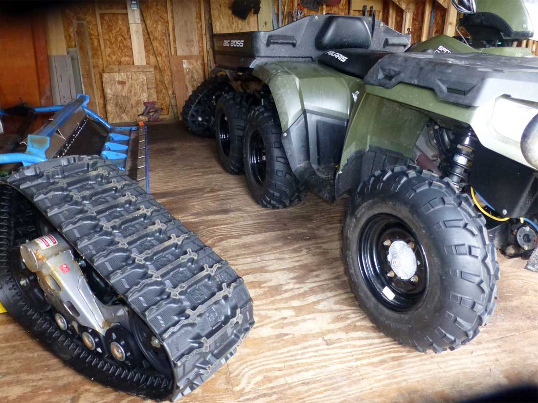

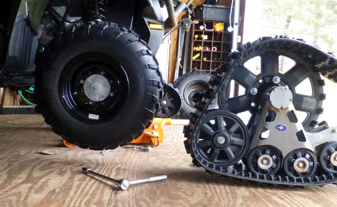

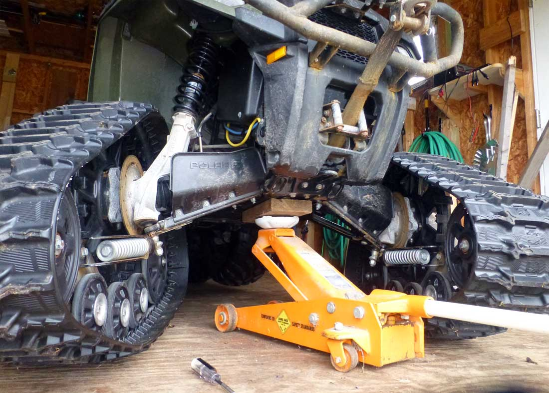

With the snow melting down here, the pods came off the boss and wheels put back on this week. The following photos sorta shows the process which should take me less than an hour to do. :unsure: Only takes three different wrenches to do. These pods are made by Soucy and are easier to get off and on, than other manufacturers I've worked with. Let me add, we would not own a UTV or ATV that does not have pods for operating in snow. I've been using machines with them for about 15 years so I'm not new to this job.
Pods are the complete unit with all the parts, whereas the tracks are the rubber part with lugs.

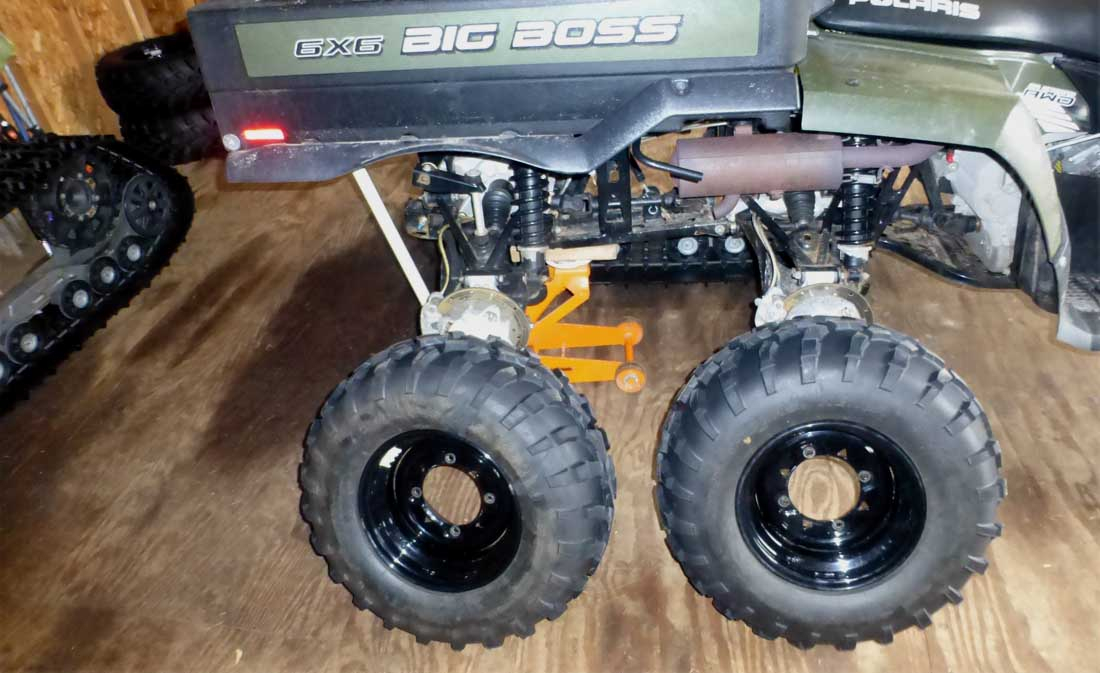

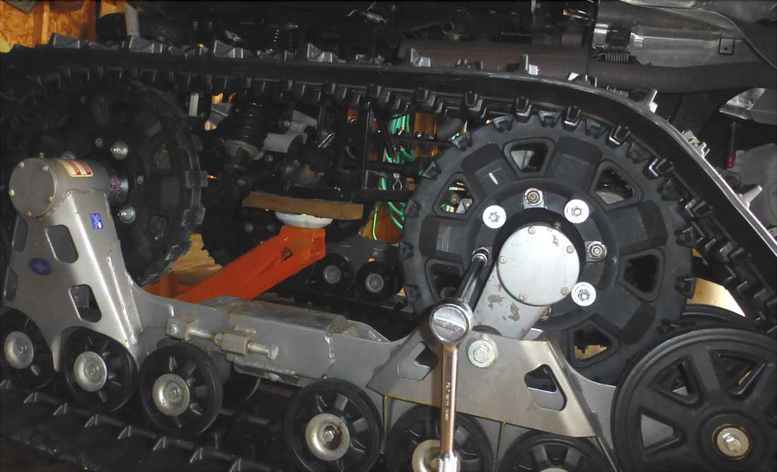

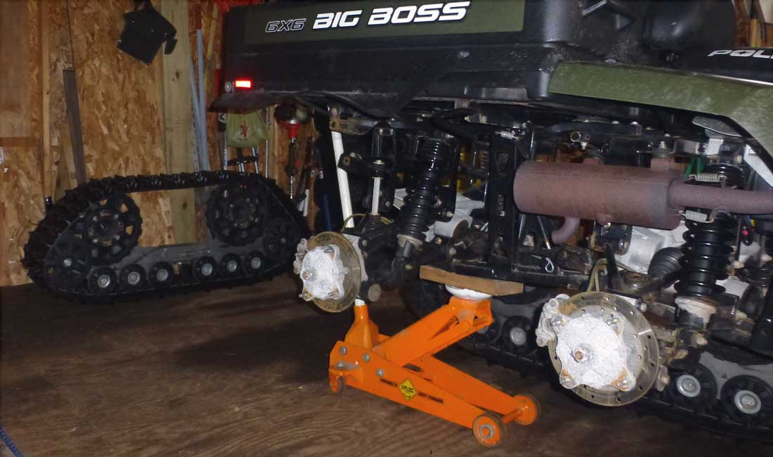

Rears coming off first and the rear pods is just barely raised off the floor. They will need to be rotated slightly to get to the last lug nut.
Pod off and rolled to the back. Just 8 lug bolts to get it off. These rear pods weight over 100lbs each.
I'll post the fronts removel next which is very much the same as most atv's and utv's pods switch would go. Let me know if you like this thread or ask any questions you might have...

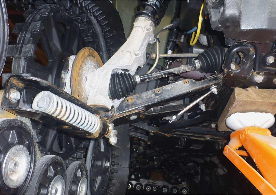

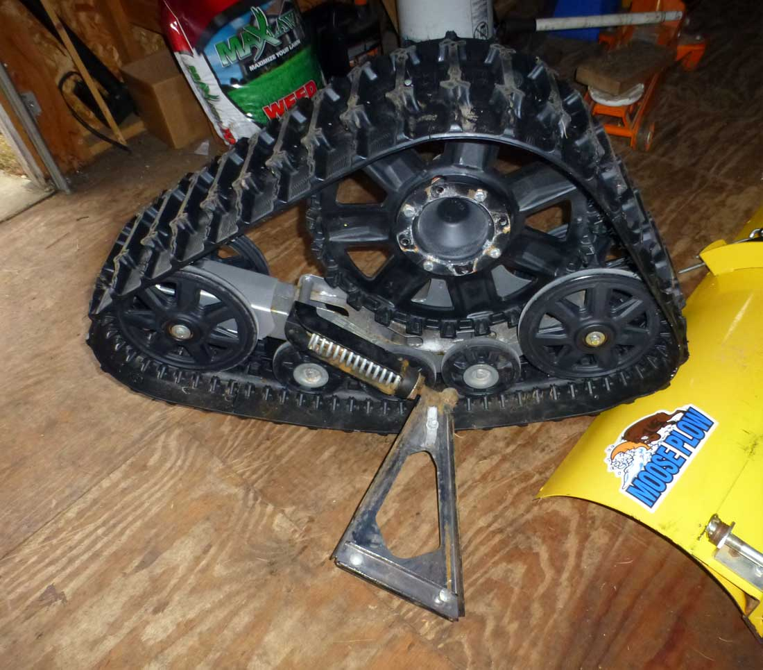

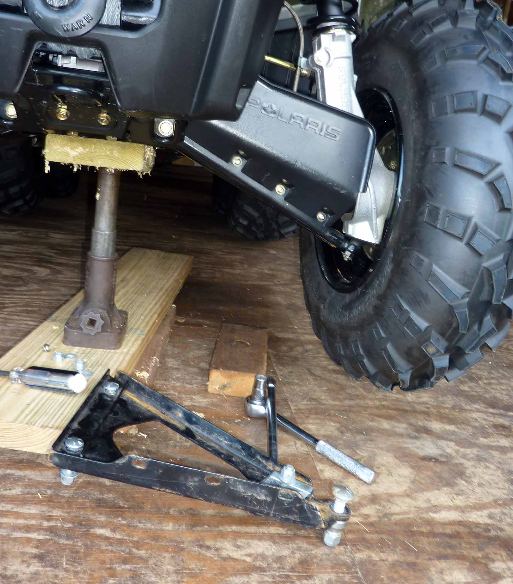

Now the fronts. Let me add that most atv's and utv's with have anti-rotation mounts like you'll see here but our 6x6 doesn't have them in the rear.
In top photo you can see anti-rotation brackets attached to the springs. Some manufacturers use rubber bushings instead of springs. These keep the pods from going to high or low.
Again the pod track is just barly off the floor.
This shows the anti-rotation bracket being unbolted from the boss's A frame.
Front pod off! You can see the difference in the height, they'll make your machine.
Done! After CV boot covers are replaced and lug nuts torqued.
/ pod removal from atv. "tracks"
Here is a better view of a anti-rotation bracket! This anchors the arm with the rotation limiters on it and has three bolts holding it on, two need to come off while the third you just losen.
Here is a little better photo of the anti-rotation bracket and the limiters that are on them. In these photos, you can see the drive sprocket is smaller diameter than the tires are, typically about 70% of them. Since spinning these pods takes HP, this slows your machine down but gives you the torque to run them in snow. Any questions???

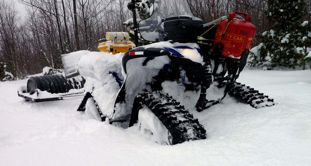

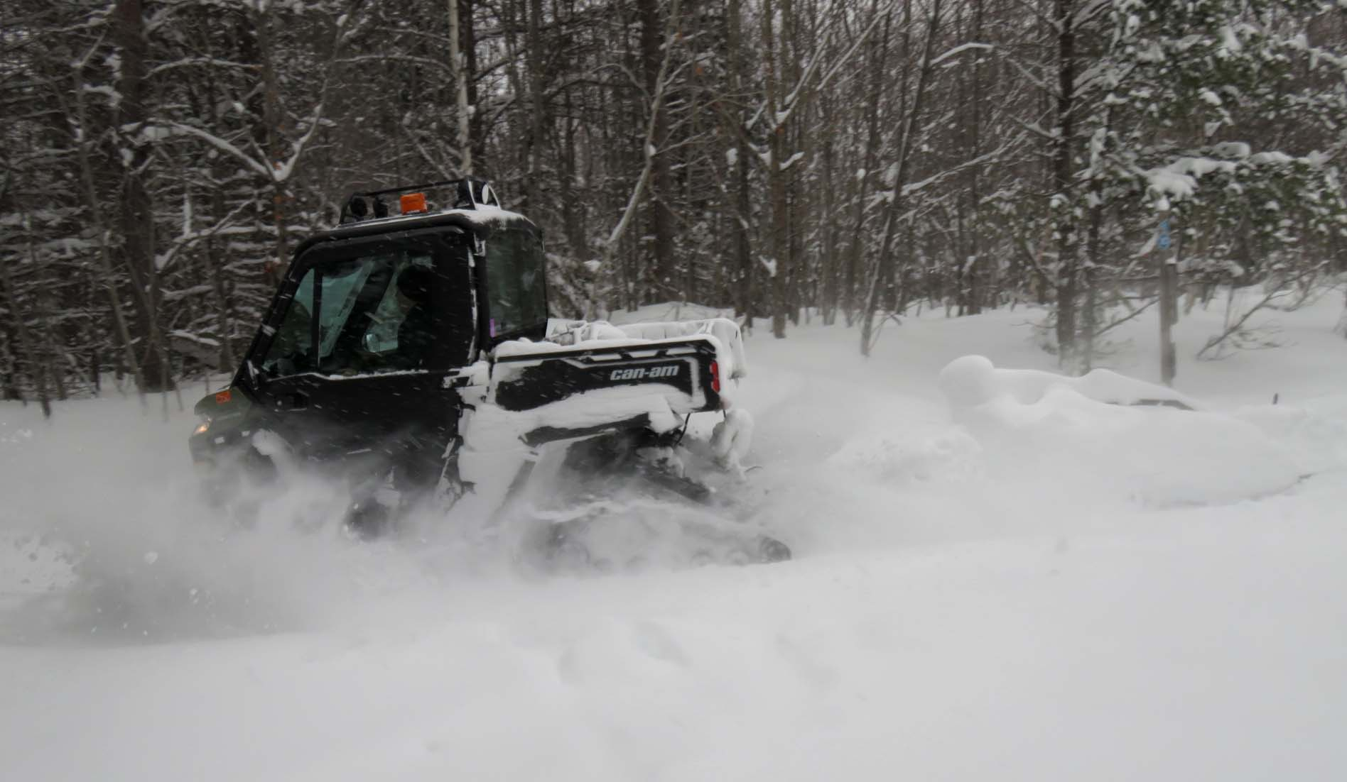

We normally operating on snow that's been knocked down by previous machines. (ak ski trails) But on rare occasions, there was so much new snow, moving on it with snowshoes would be difficult to impossible. We do receive snow here on the south shore of the big lake. :LOL: Here is a deep snow shot. There was so much that day it was forced up into the radiator and overheated this machine.
