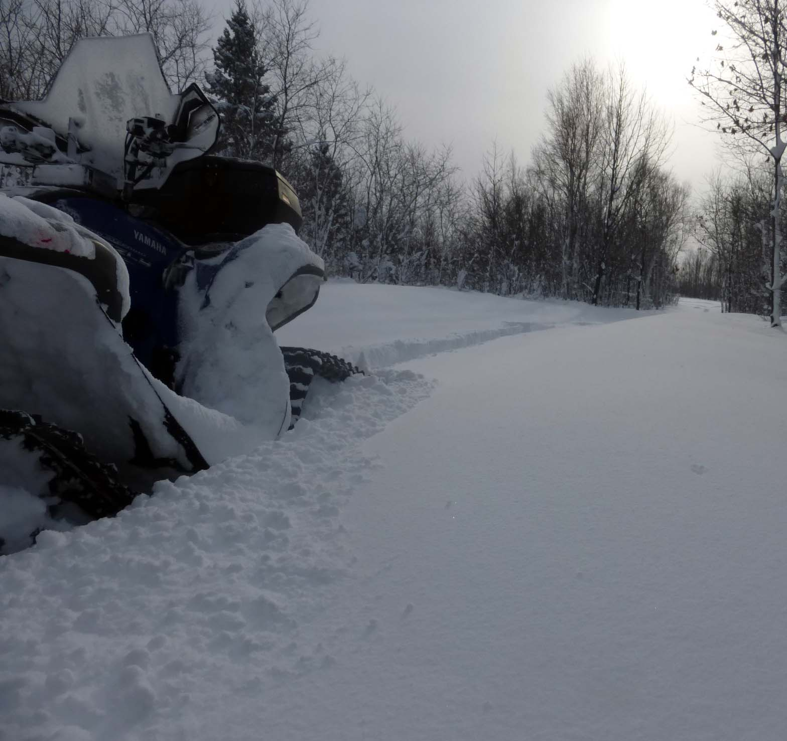

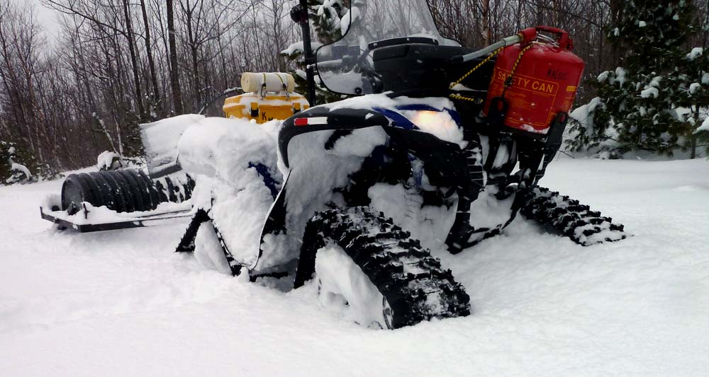

We normally operating on snow that's been knocked down by previous machines. (ak ski trails) But on rare occasions, there was so much new snow, moving on it with snowshoes would be difficult to impossible. We do receive snow here on the south shore of the big lake. :LOL: Here is a deep snow shot. There was so much that day it was forced up into the radiator and overheated this machine.
