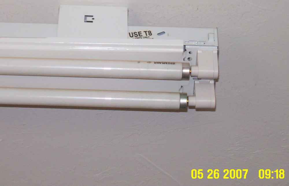

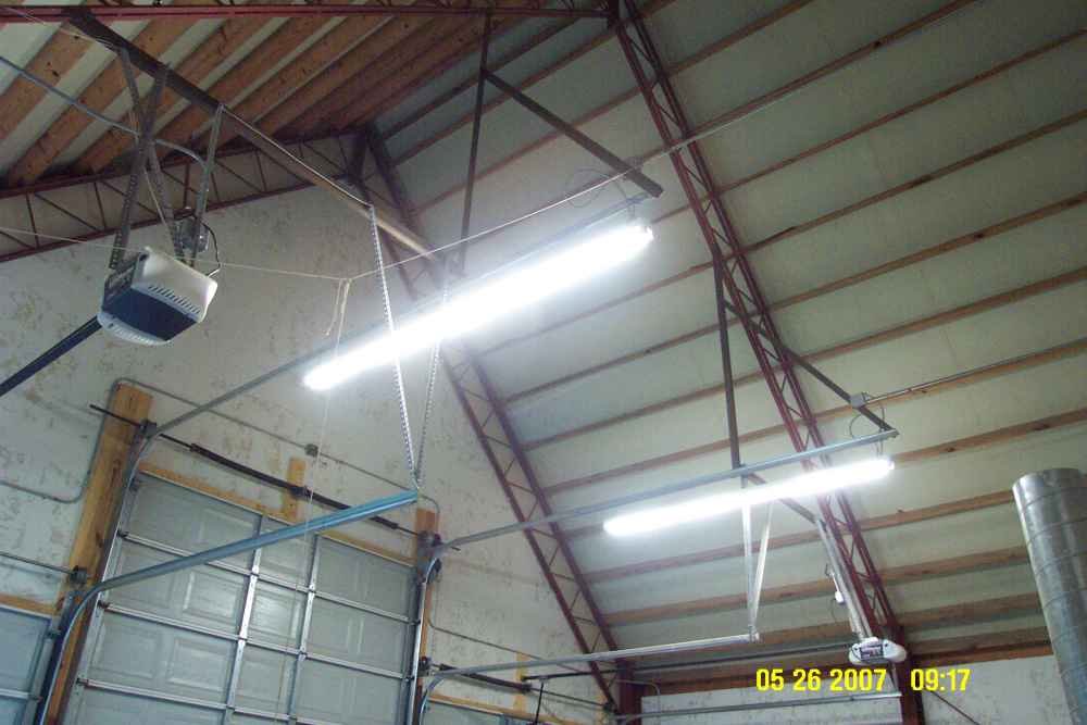

Thanks Patrick g for the input.I was thinking about 8 ft tubes as well.What HO bulbs are they?.T8 or T 12?.
OOPS, What can I say?????? Sorry, I got it wrong. I have so darned many lights and apparently such a poor memory...
The light fixtures in the garage/shop/tractor shed are all TWIN (side by side) 8 footers. They are all T-8. The garage is 24x36 (3 each 12 ft bays) there are two of the twin fixtures (one each) mounted above the "border" between adjacent bays. This does not light up like an operating theater but it is more than adequate. IN the picture yo can see the top of the center garage door which is 14 ft tall. This gives a good estimate of fixture height.

The garage lights are up about 14-15 ft mounted horizontal(peak of ceiling is at 30 ft), the shed lights run from about 10 ft to 12 ft (3:12 slope), and the shop lights are currently on the 10ft ceiling but will be dropped 8-12 inches to be below dust collection ducts when installed.
