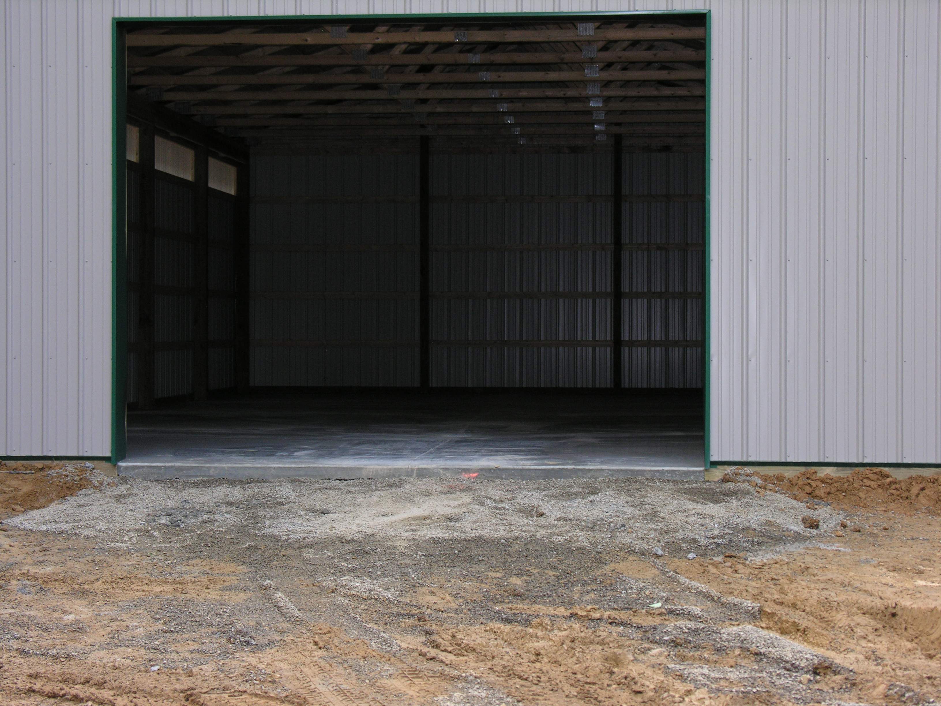

The floor has been poured. Now I just need the overhead door installed and then the rest is up to me. Up first is electrical, apron and finish grading.
