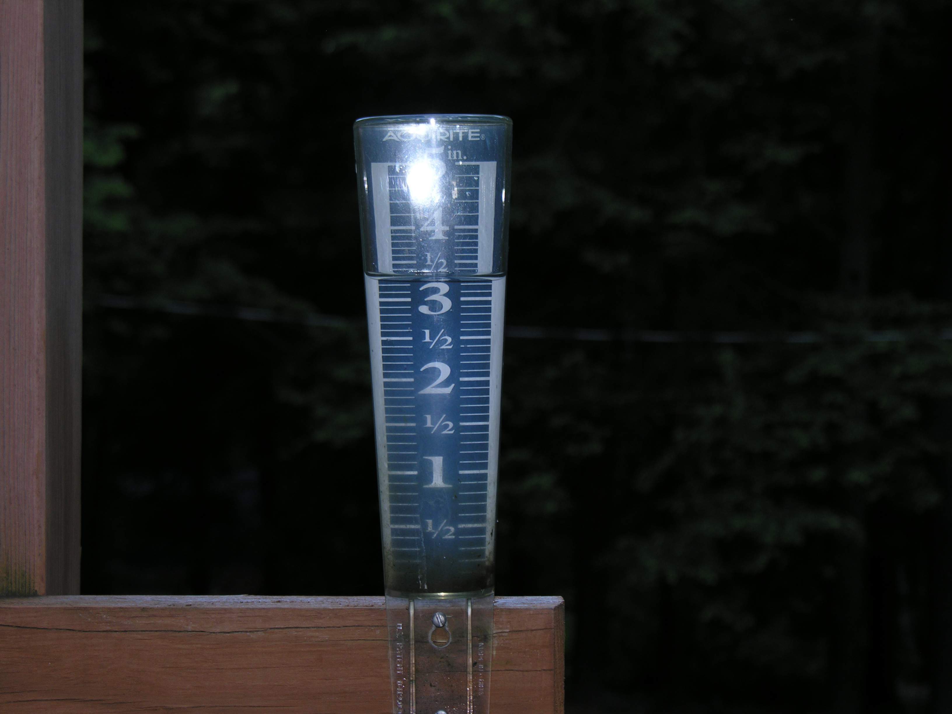

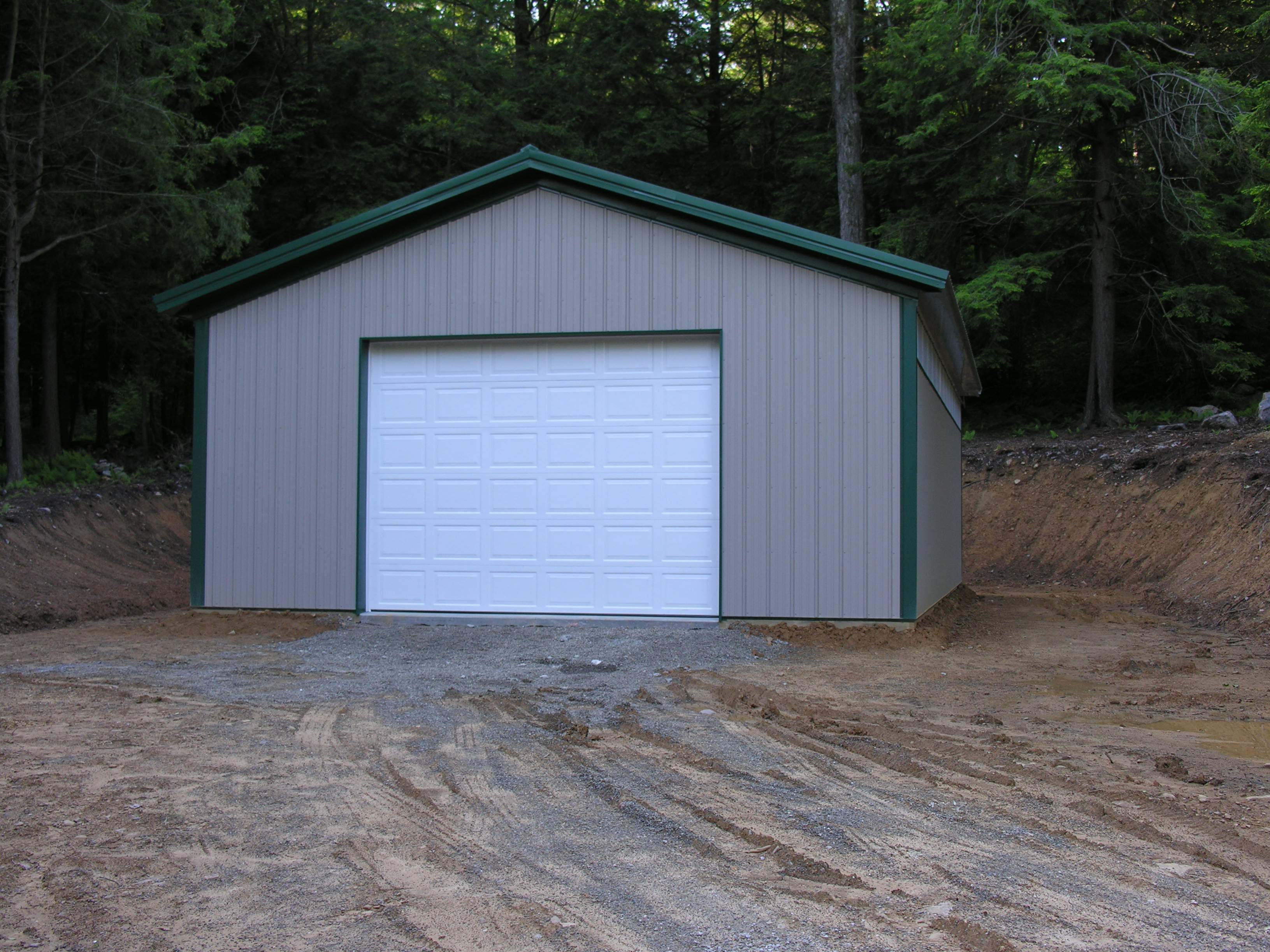

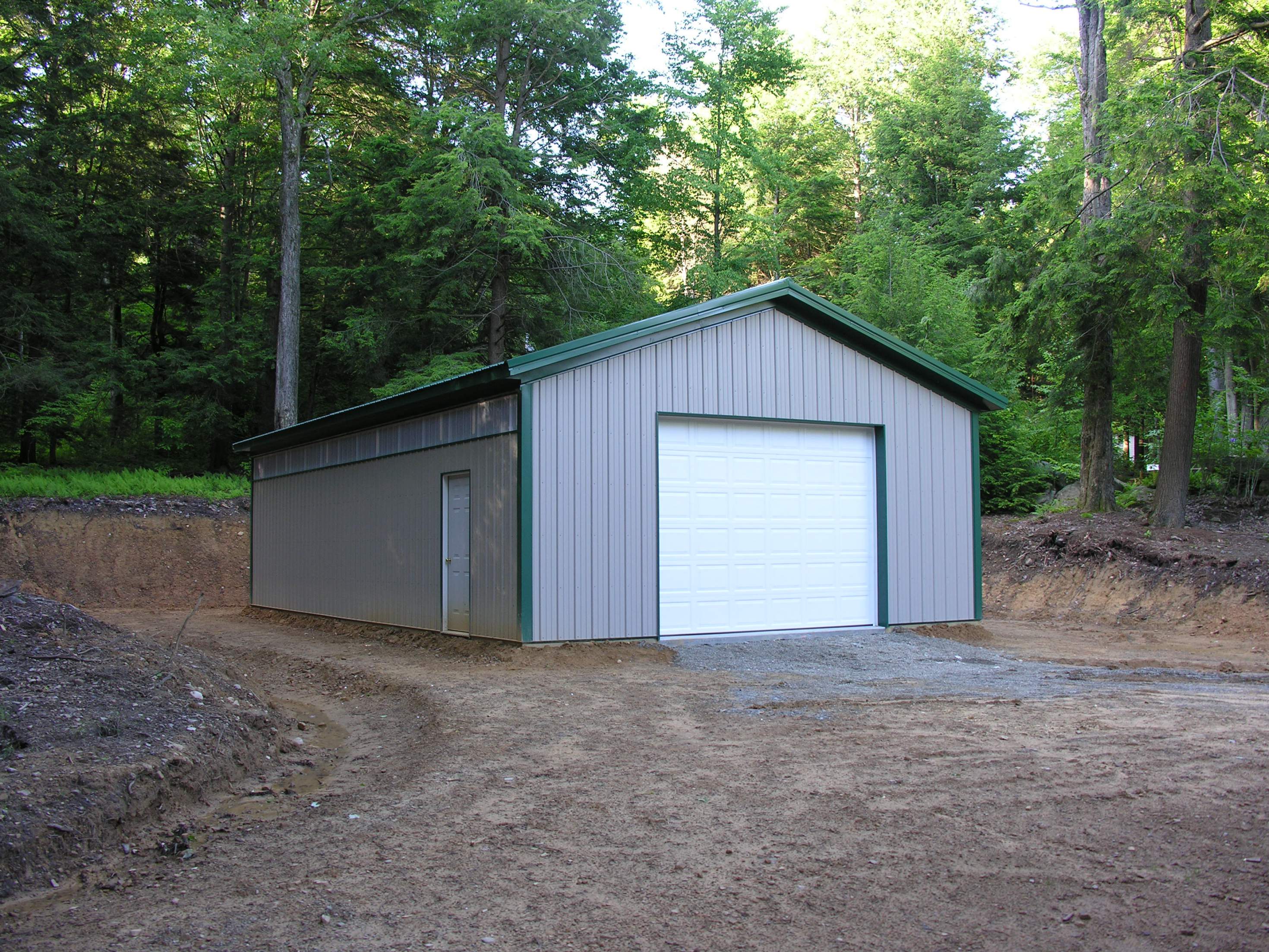

Well the overhead door has been installed so the rest is up to me. First up, digging the ditch for the electrical. Included a shot of my rain gauge after this weeks storm, just over 3-1/4". It has been a very wet spring around here, over 6" in April and over 4" in June so far. Actually all the rain has been helping settle all the dirt that was moved for the barn site.

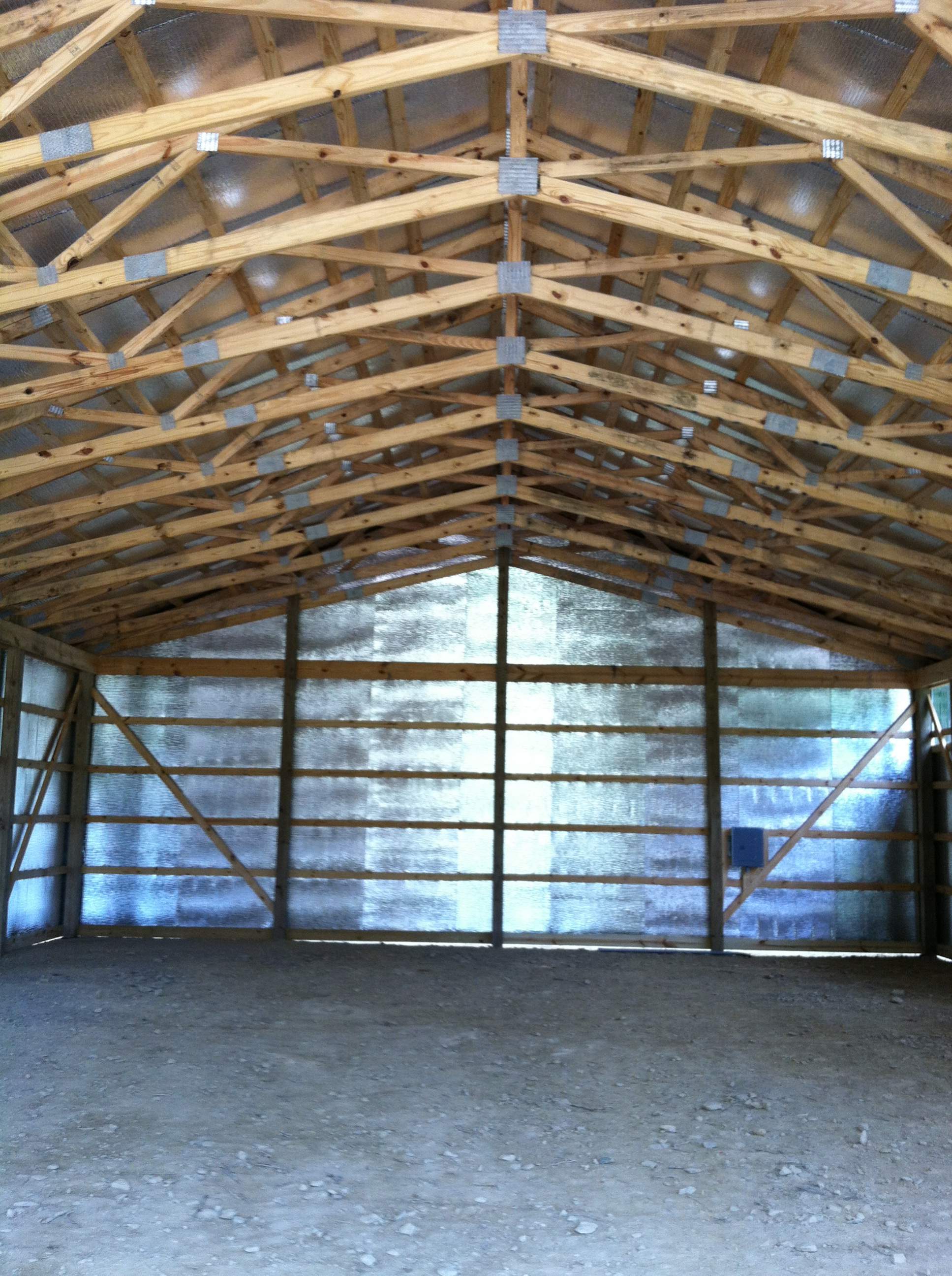

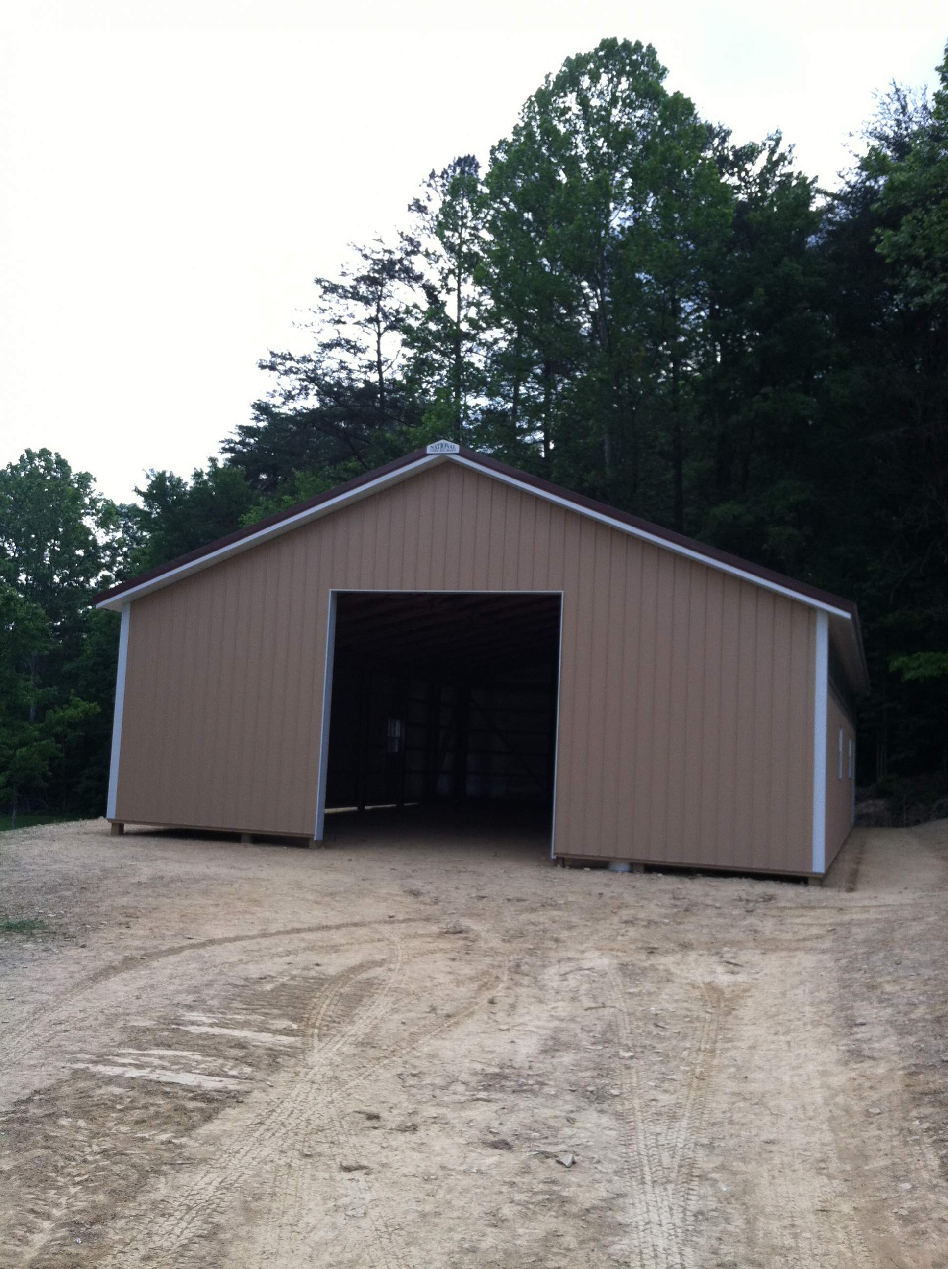

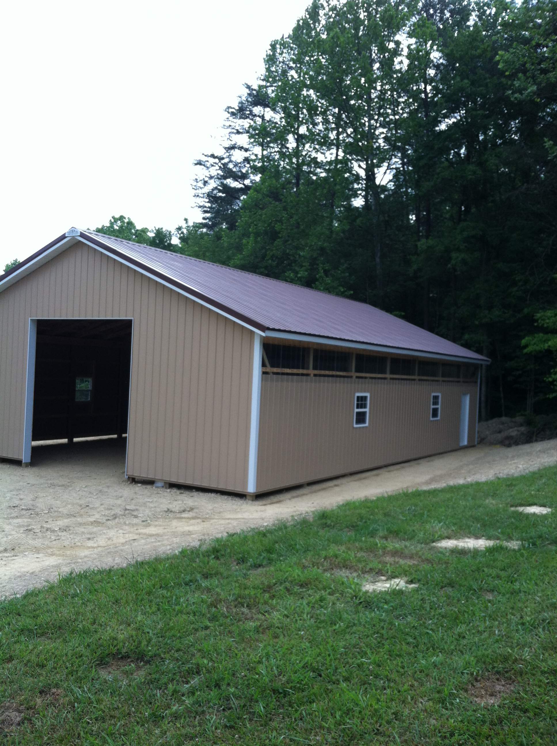

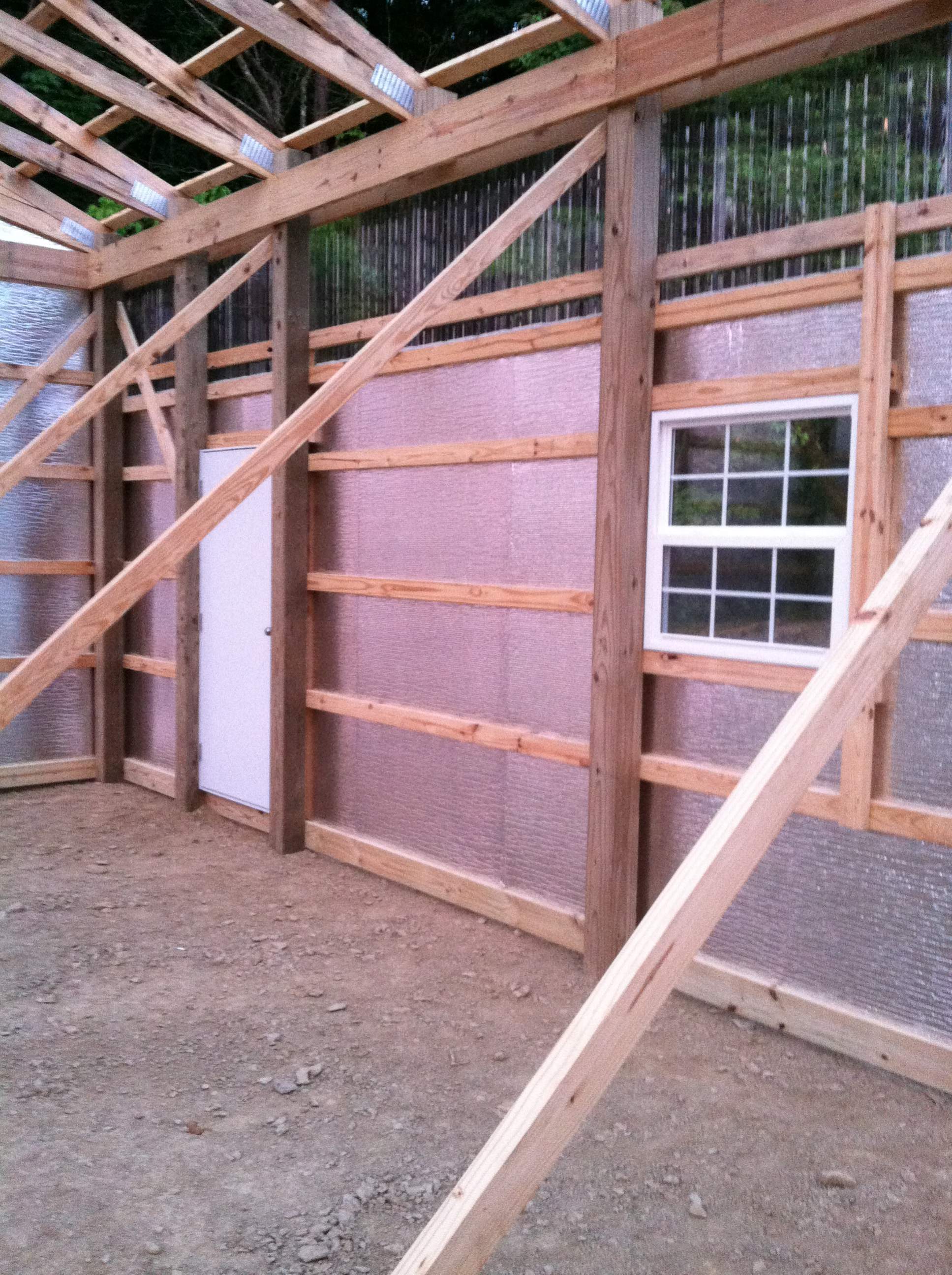

Barn is constructed, now all I have left is put up a new 12x12 OHDoor, rough in the electrical, dirt and gravel pour a slab. National barn Co. did a superb job. they completed it in 5 working days.Picture 031.jpgPicture 032.jpgPicture 033.jpgPicture 034.jpg

Barn is constructed, now all I have left is put up a new 12x12 OHDoor, rough in the electrical, dirt and gravel pour a slab. National barn Co. did a superb job. they completed it in 5 working days.View attachment 322843View attachment 322844View attachment 322845View attachment 322846
In looking at your completed photos, I can tell you ALL of the roof truss bracing has been left out of the building. At a very minimum, there should be 2x4 lateral bracing every 10 feet across the truss bottom chords. If you want to Email me a copy of the engineer sealed truss drawings, I would be happy to review them for free and advise as to what the requirements are. This is a serious situation and could result in a failure under wind or snow loads.
   / Pole Barn Project #47
That's a good point. I don't have scissor trusses but they did put in 2x4 bracing in numerous directions on my trusses.
   / Pole Barn Project #48
I don't think the scissor truss needs the amount of bracing you're suggesting. Even still, when looking at the picture, I can spot the 2x4 lateral ties that connect the truss' together. (marked in red):
   / Pole Barn Project #49
Yes they are there, four of them as TSO said marked in red.
