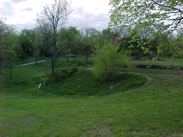

Well, Dooleysm, looks like you have a solution and don't recognize it. Rebuild the dam where it is, let the tree roots cause a leak and wash away the stuff your neighbor has that you do not want to see.
Now on a more serious note. What we have done in the past with a similar problem is to move the dam up hill a little. Dig out the pond to get some depth. You can use the dirt from the old dam to help with building a new one, just be careful not to kill the trees. If you go 15 or 20 feet from the old dam, that will probably be sufficient.
   / Pond digging question #17
Ok, so I'm in trouble here too?
The darker green area is the front side of the dam. Sorry the pic is so dark, it was later that evening than I realized. I've been wondering why my pond goes down so quickly, but I'm not seeing any wet areas on the dam face...........
   / Pond digging question #18
</font><font color="blue" class="small">( Ok, so I'm in trouble here too?
The darker green area is the front side of the dam. Sorry the pic is so dark, it was later that evening than I realized. I've been wondering why my pond goes down so quickly, but I'm not seeing any wet areas on the dam face........... )</font>
I am by no means an expert on ponds, but in my opinion if you don't yet have leaks caused by those roots, it's just a matter of time until you do.
   / Pond digging question #19
So, what's the answer? Chop down the tree? Let it grow till it empties the pond? Let all the water out and build a tennis court or helipad? /forums/images/graemlins/confused.gif
