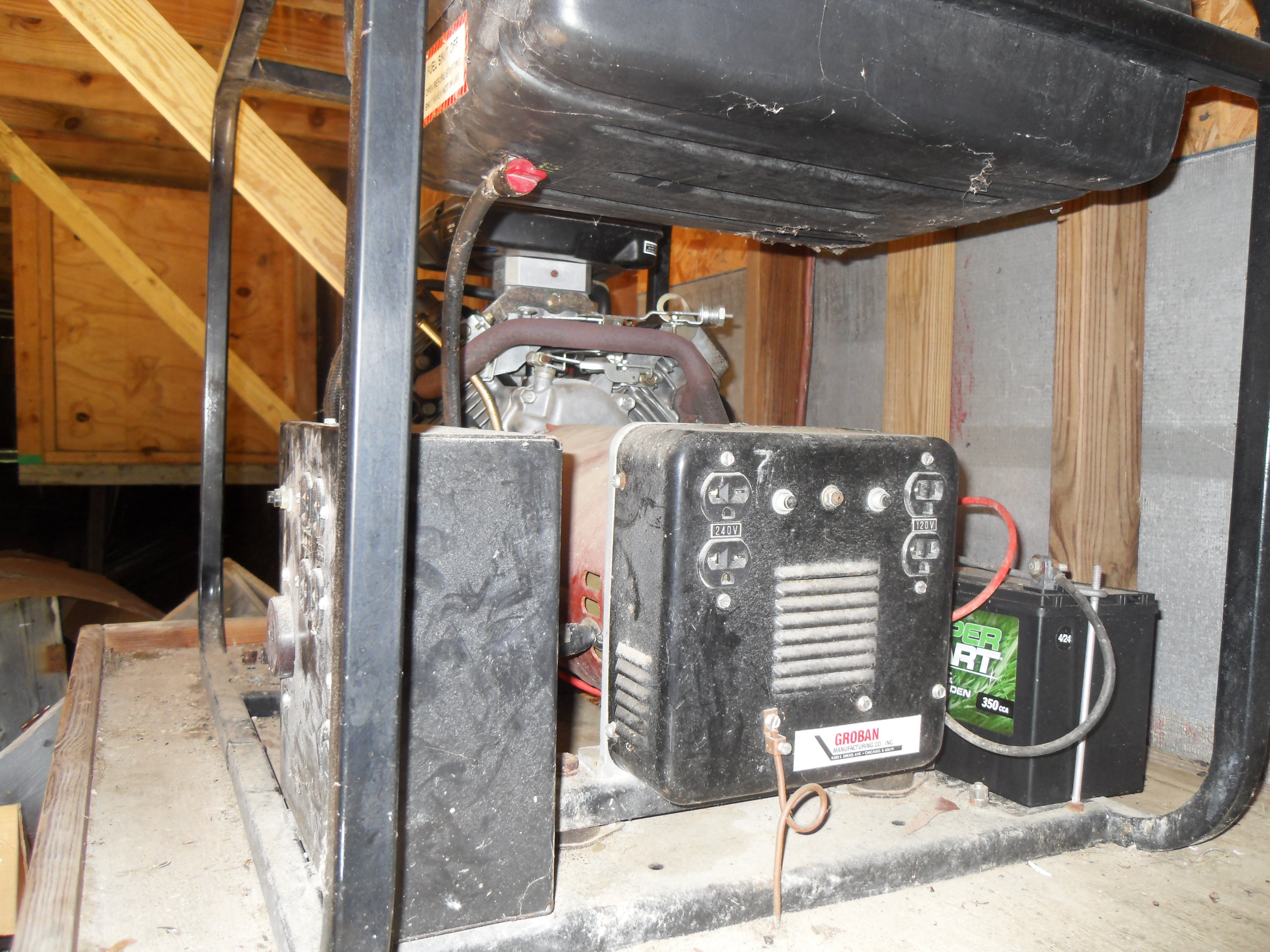

I watched the 'flash" video. I cannot find any circuit breaker on the engine/generator. There should be one, shouldn't there?
   / Portable generators to stay away from? #25
should be near the outlet, maybe a simple push button, post a photo
#26
Photos of generator.

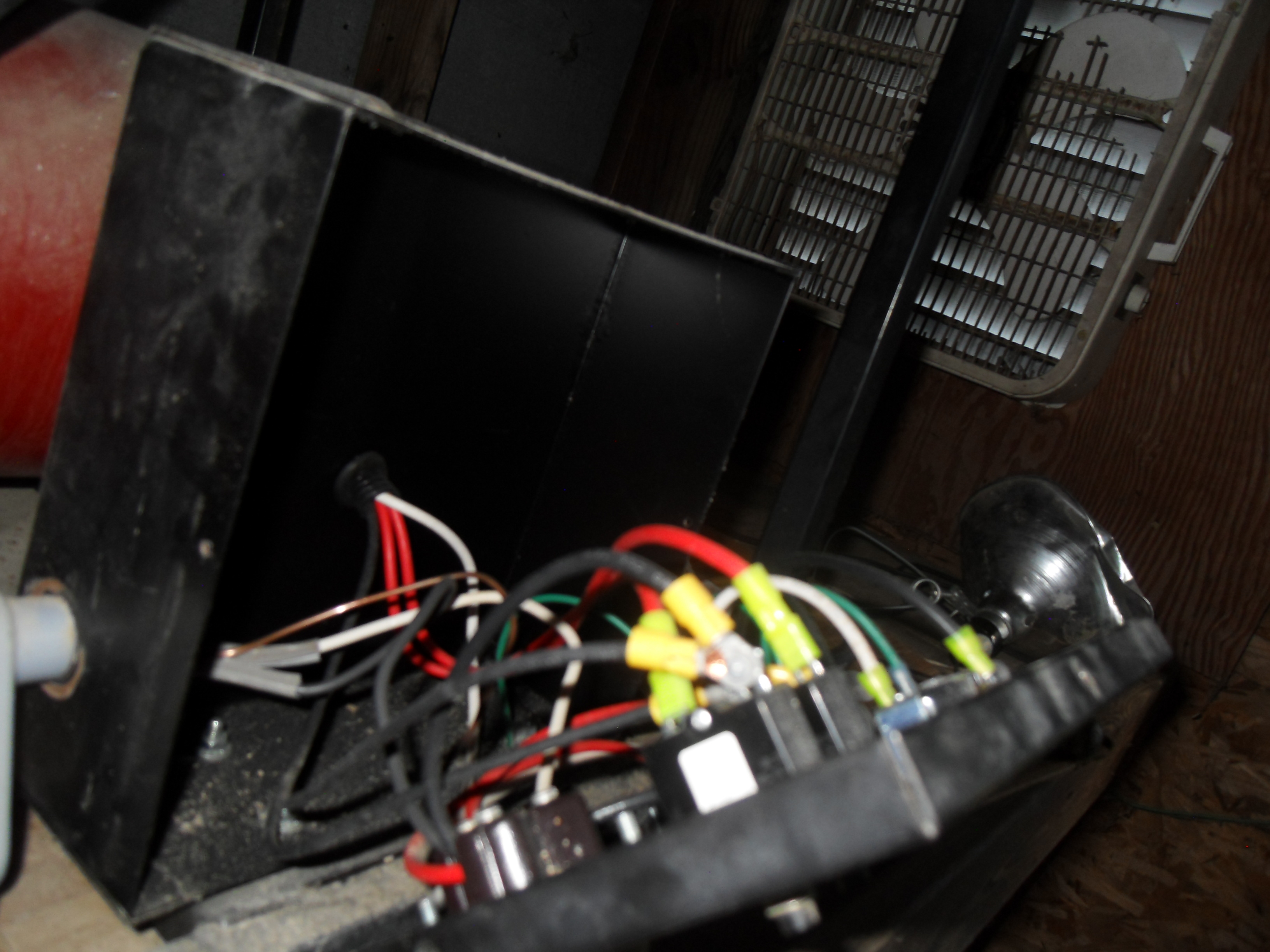

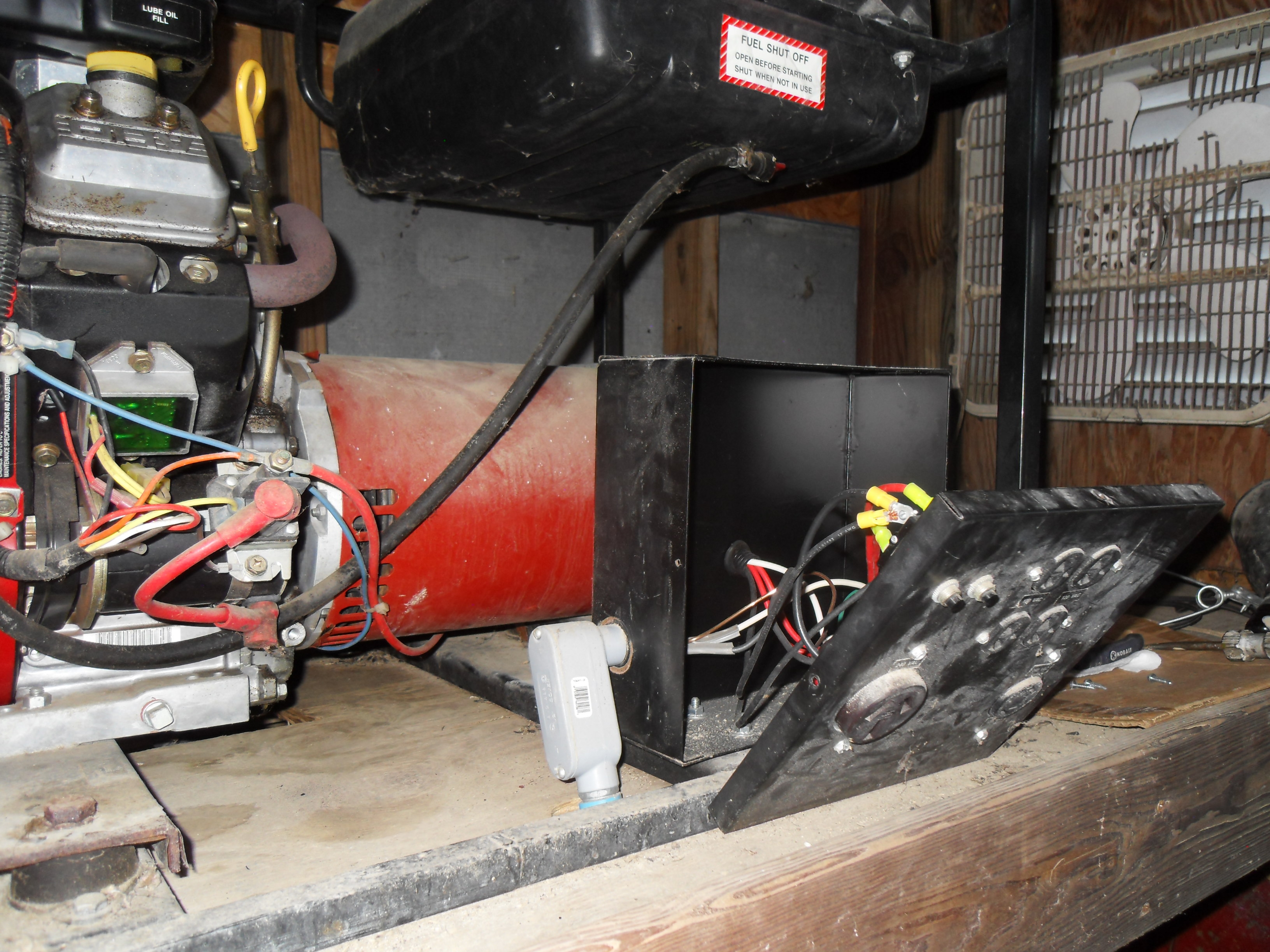

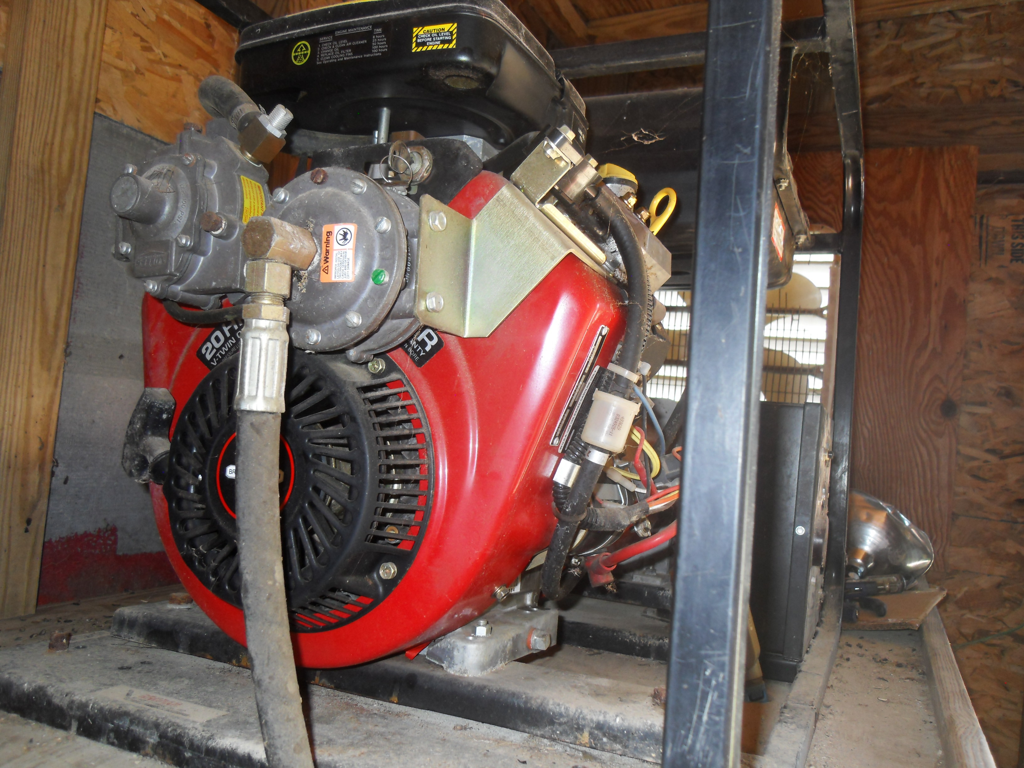

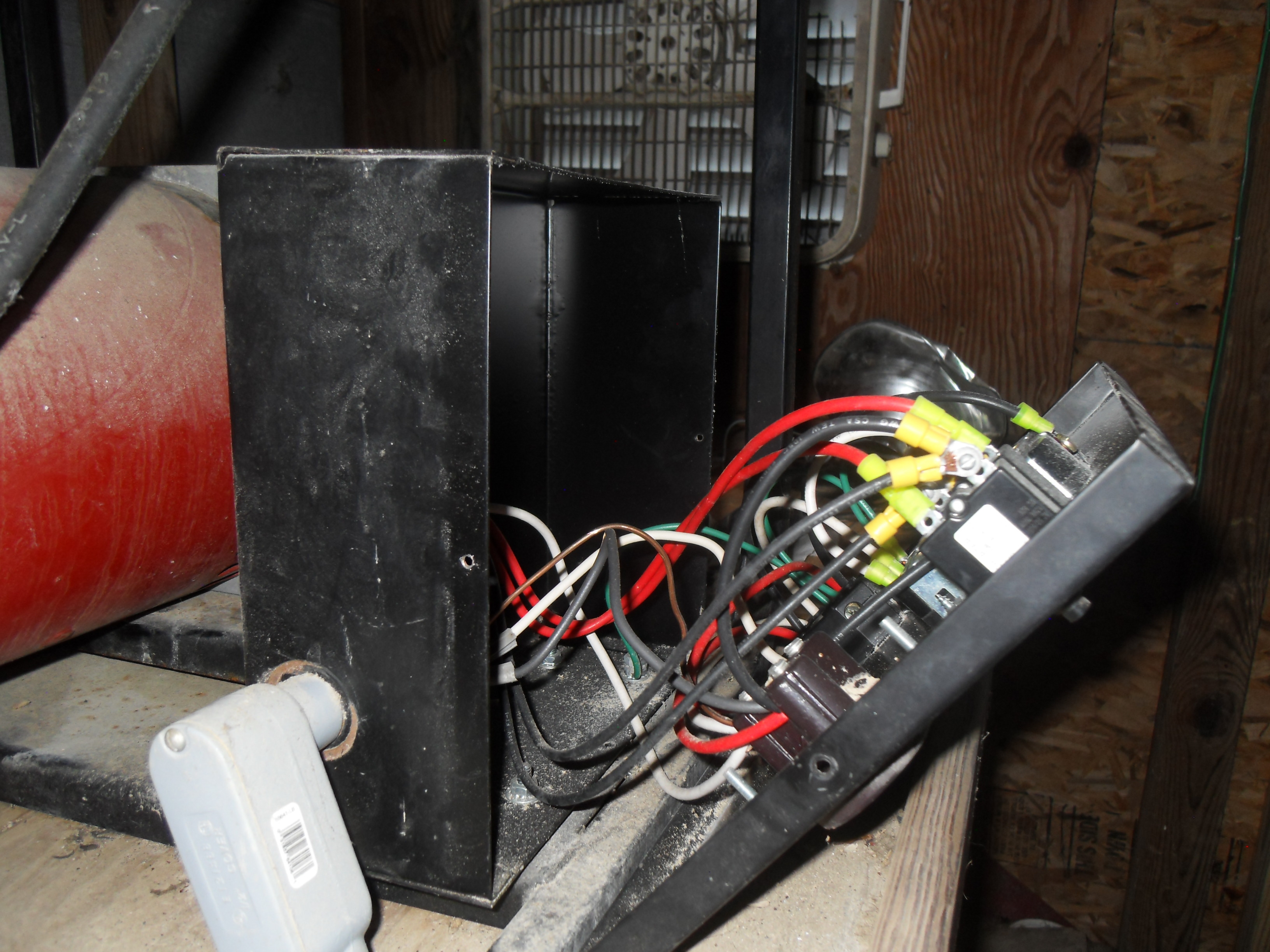

I had seen them previously but when pressed there was no resistance so I discounted them. Just went down again and pressed them and no resistance. Tried to see if I could access them but whatever is holding them in place needs a stronger tool. Is it worth it for me to attempt to take that panel cover off? Or am I in over my head? I feel comfortable doing that and have the tools, probably. If so, should I disconnect the battery?
   / Portable generators to stay away from? #33
they are not tripped. you should be good to flash the field.
#34
"should be good to flash the field". I am brave, not sure if I am that brave.
   / Portable generators to stay away from? #35
#36
The second panel appears to be receptacles that have never been used. Attached photos.
