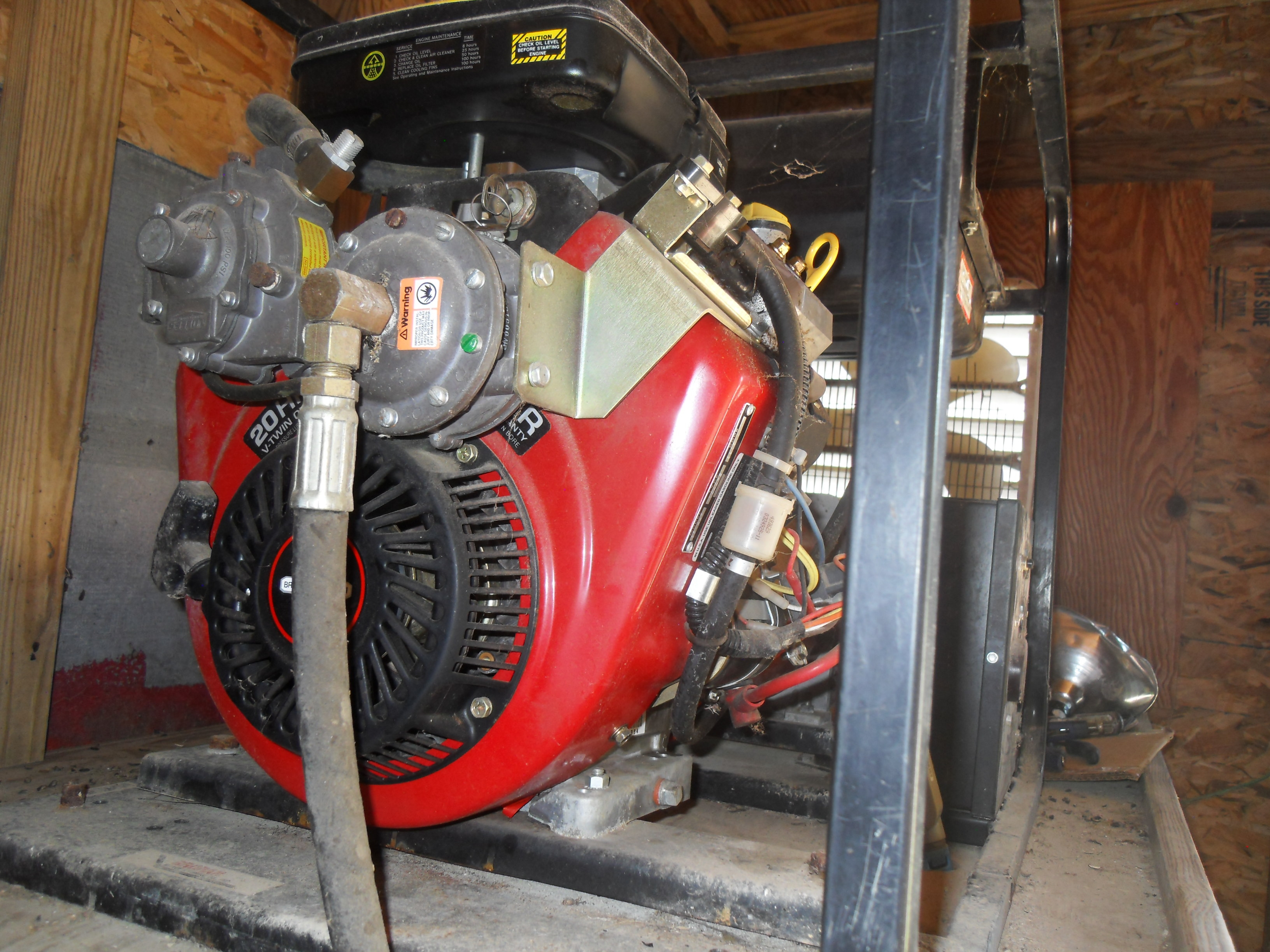

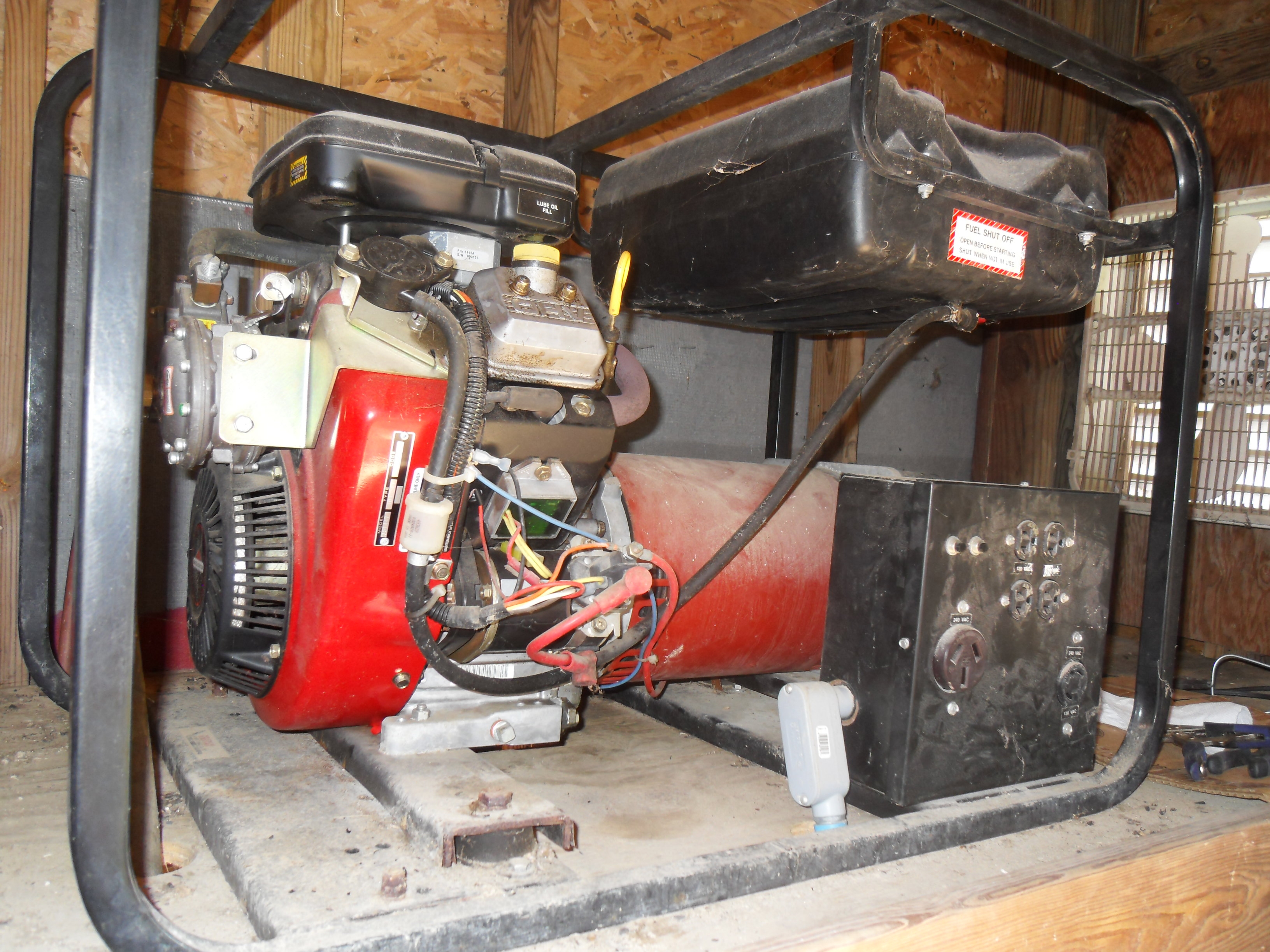

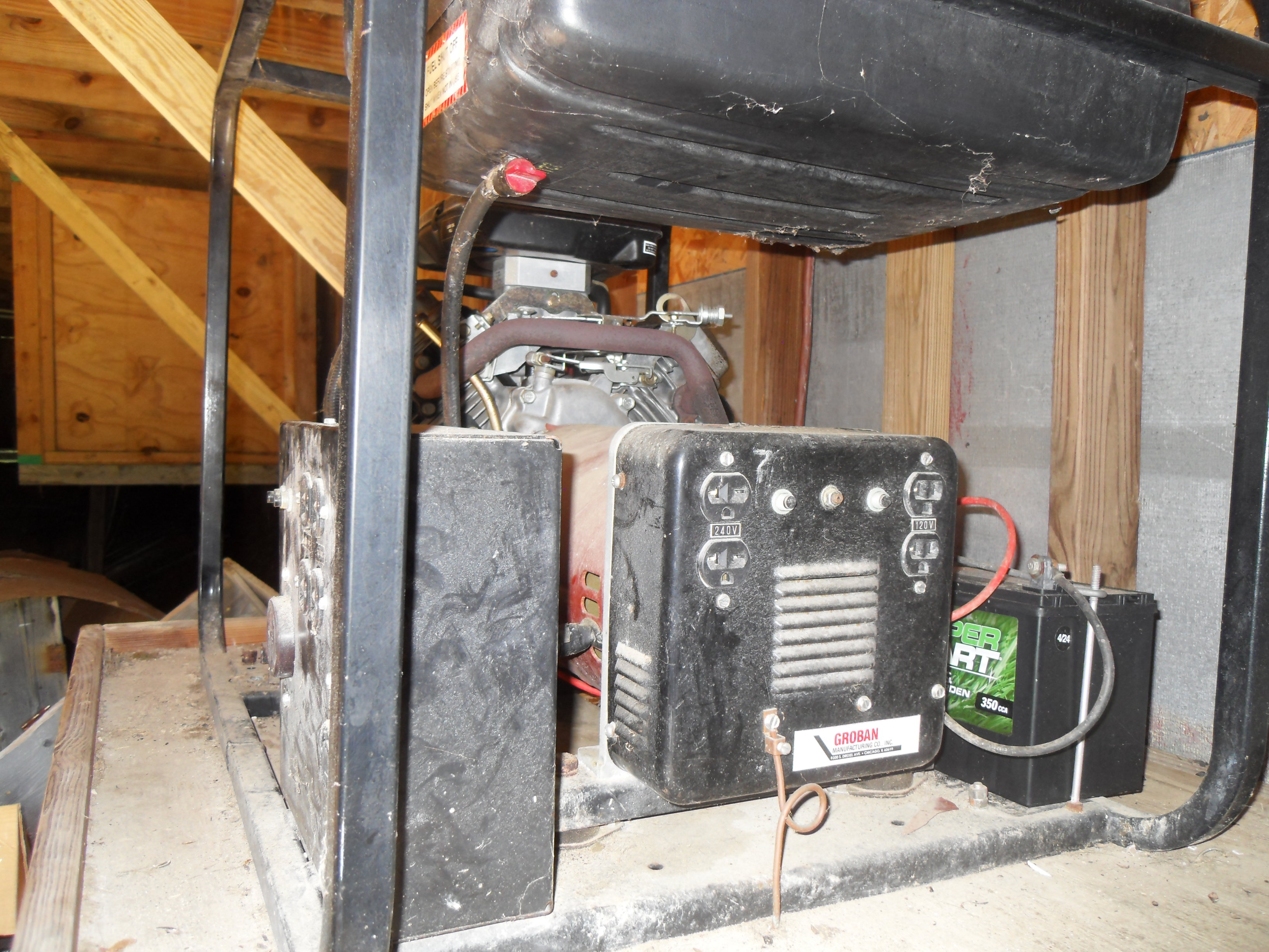

I watched the 'flash" video. I cannot find any circuit breaker on the engine/generator. There should be one, shouldn't there?
   / Portable generators to stay away from? #25
should be near the outlet, maybe a simple push button, post a photo
#26
Photos of generator.

Just curious. The generator ran for an hour and powered the refrigerator, some battery backups, tv. Then four hours later it ran fine but would not generate electricity. Is there such a thing as generating too much electricity and not using it, in other words, under using the generator?
