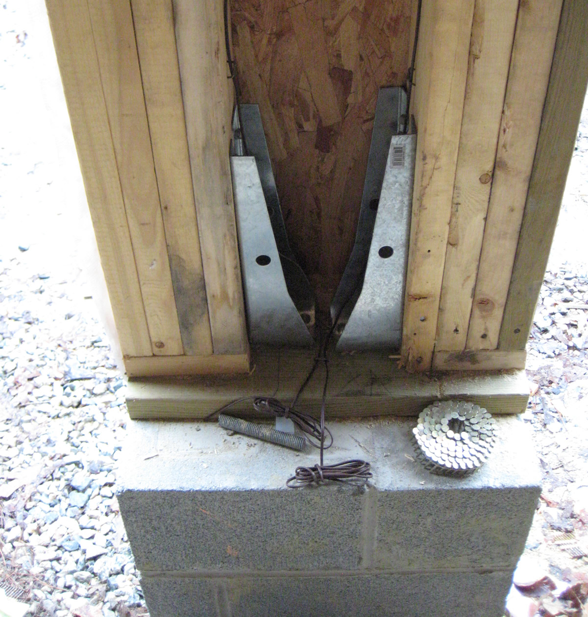

I don't think there is a real benefit to putting posts on top of a block wall -- you'd still need a ton of bracing and/or sheathing to get any shear strength, and I can't think of reliable ways to attach posts to block walls (reinforced solid concrete walls, yes, but not block walls).

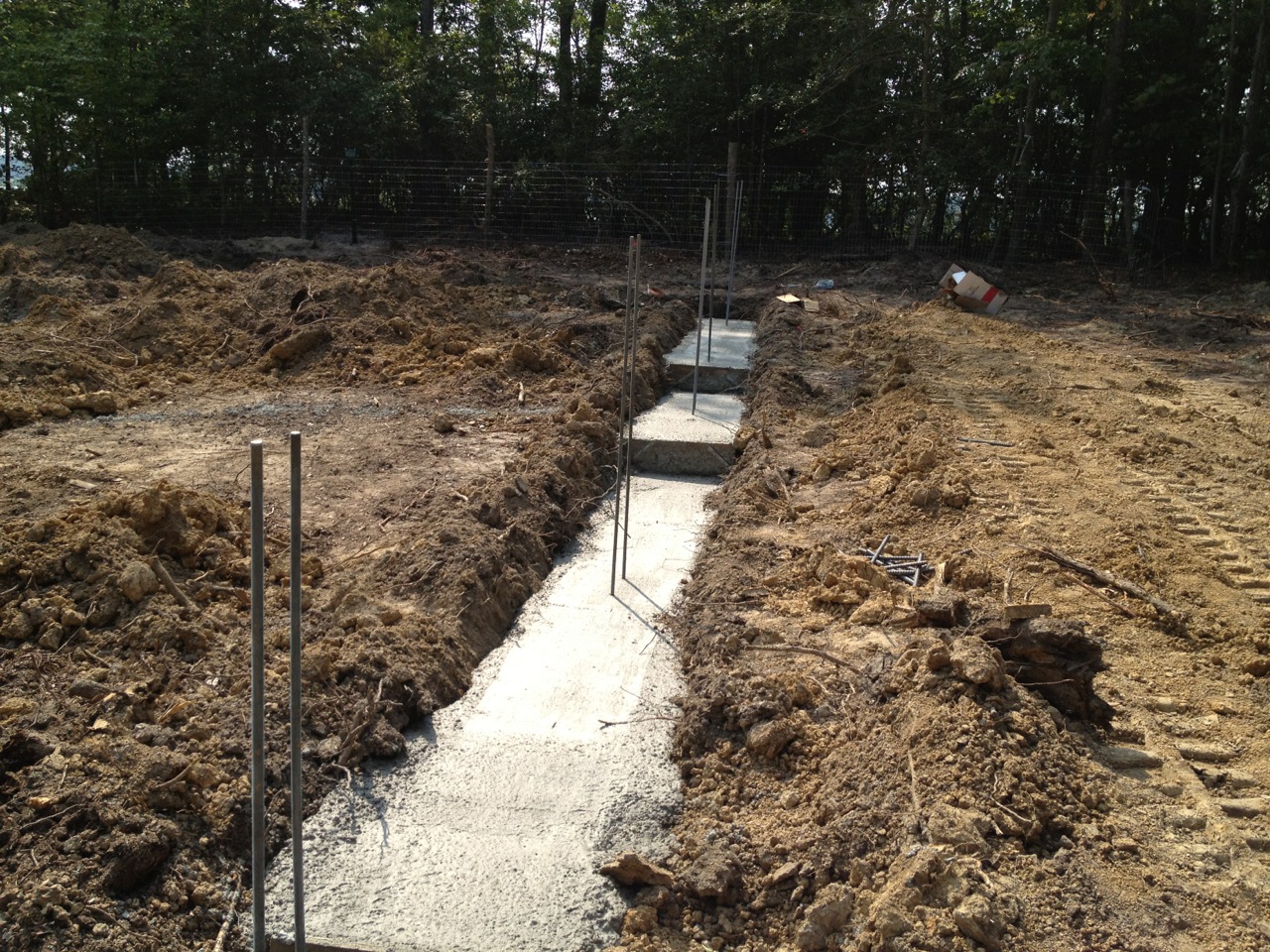

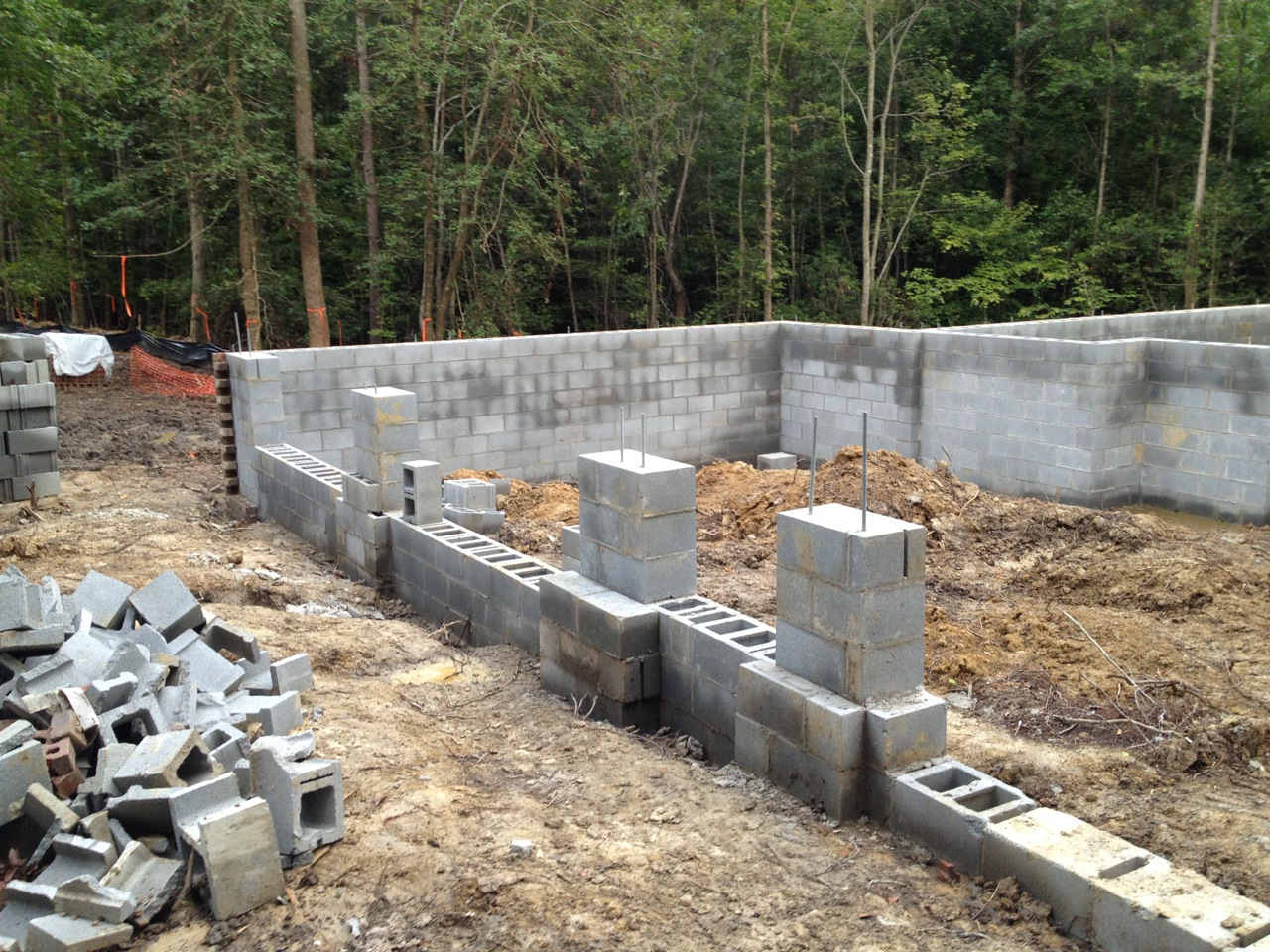

So for the time being, Here is what I am planning:
2' wide 6" thick footer with rebar
6 course 8" block wall
treated 2x8 GC rated sill plate. Properly anchored to filled cores in the block. (need to check into how many/how far apart these need to be.
Then I will pour the concrete floor to have a nice place to work
Pre-built wall sections with 2x6's stood up and anchored to the foundation
7/16 OSB sheathing all the way around
4' OC trusses w/2x4 purlins laid flat
Metal roofing and siding
Then will work on interior insulation, OSB walls, surface mounted wiring in conduit, lighting, etc
Now just waiting on the weather to break in a few months so I can dig a footer.

Sounds like a good plan to me, especially if you are comfortable laying block -- that is a big advantage being able to do your own masonry. As much as I appreciate the simplicity and fast progress of pole barn construction, and despite having used it on my barn, having a full on block foundation is preferable to me. If I had to do it again, I would have made my stick-on-block workshop bigger and detached from our home, and not built a separate pole barn.
