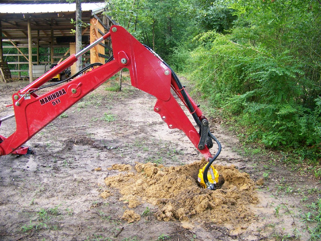

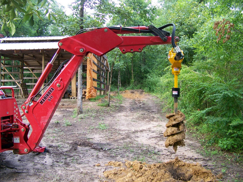

I also built my own pole barn. :) I rented a 3PH PHD for my tractor. The digger's teeth were wore out and just spun on my hard clay. Soaking helped, but I also had to use my manual post hole digger. Also, all the pole barn plans I looked at called for poles be sunk down 4 feet. Attached is a photo of my new hydraulic PHD on my backhoe. Yes, reverse is great also. I will never use a 3PH PHD again. :cool:
hugs, Brandi
