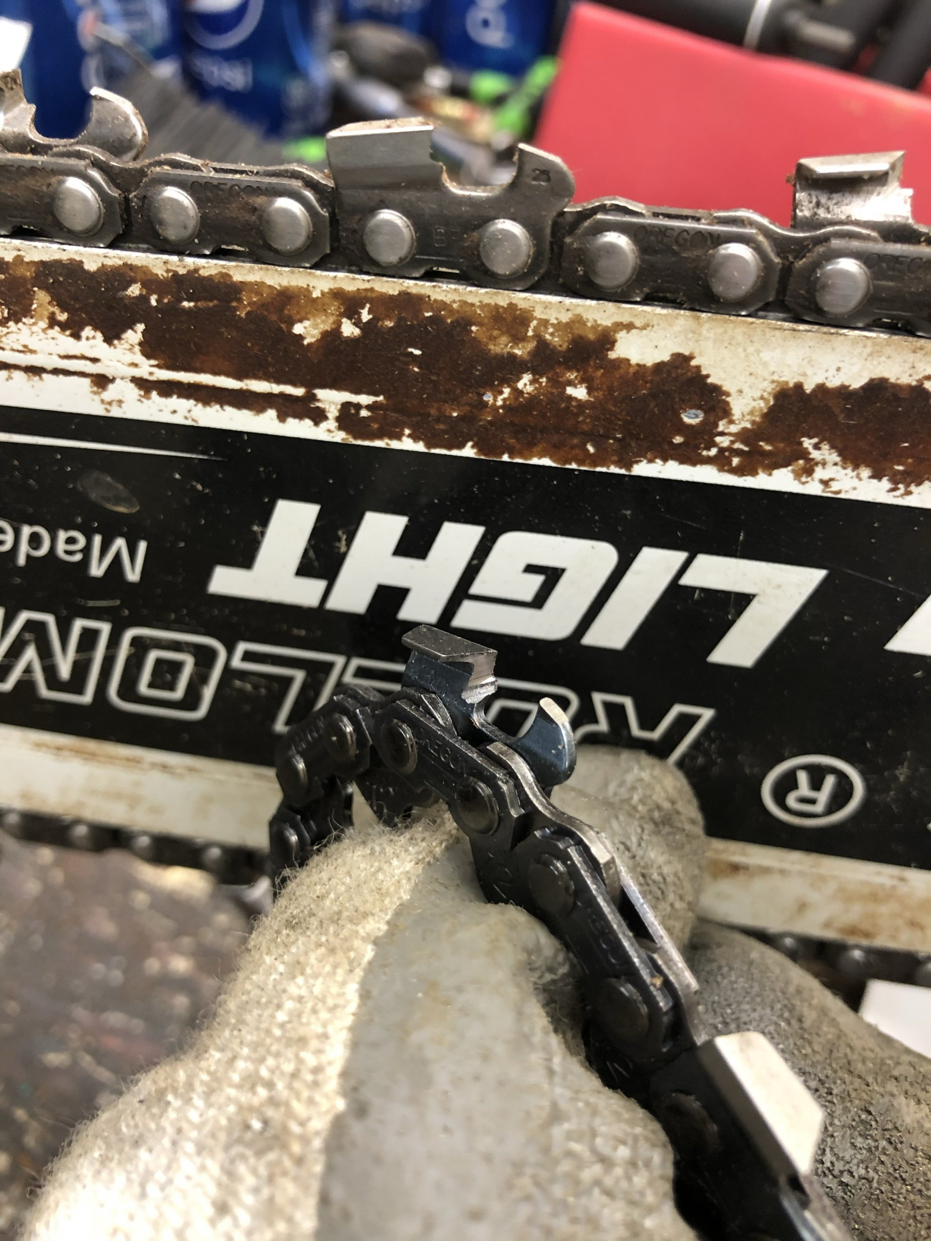

It’d come down to the profile of the cutter or the hardness of the chrome on the cutters. As far as sharpening files are fine for round cutting firewood but for square and production falling square is hard to bet. Stihl makes a good chain but I’ve never cared for itself I can’t get the cutters shaped the way I want in most applications I’m cutting.
Yes a brand new chain needs sharpened at the very least the rakers need dropped to even cut right.

Really? A brand new chain won’t cut right until you sharpen it first?
   / Problem sharpening a new chain #24
Yes when production cutting a brand new chain cuts like garbage, I’m wanting something that’s aggressive, fast cutting, and will pull on its own without me pushing on the saw.

This is why I say a new chain needs sharpened.

It’s the correct size file. I think Eric’s theories make sense.
Eric's theory is correct.
Noticed on virtually evey new chain I purchased. The factory sharpening does not match the file. Usually, it would file easier after the initial (difficult) filing.
   / Problem sharpening a new chain #29
New factory chain tends to have a gullet burr left over from the factory grind. That burr will snag a file on the first sharpening resulting in file chatter.

I got some highly touted Chinese chain on Amazon recently. The gullets have a noticeably larger radius than the file does. So the first filing will be a lot of work before I even get to making it sharper. Maybe I'll use the grinder first to get closer.
It'll be a while though as the chain does not work in my new bar... the drive links are a little too wide. It fits in the slot but there's too much friction. When the chain's tightened it doesn't turn. I measured and they're a couple thou wider on average than the other new and worn chains I had handy.
