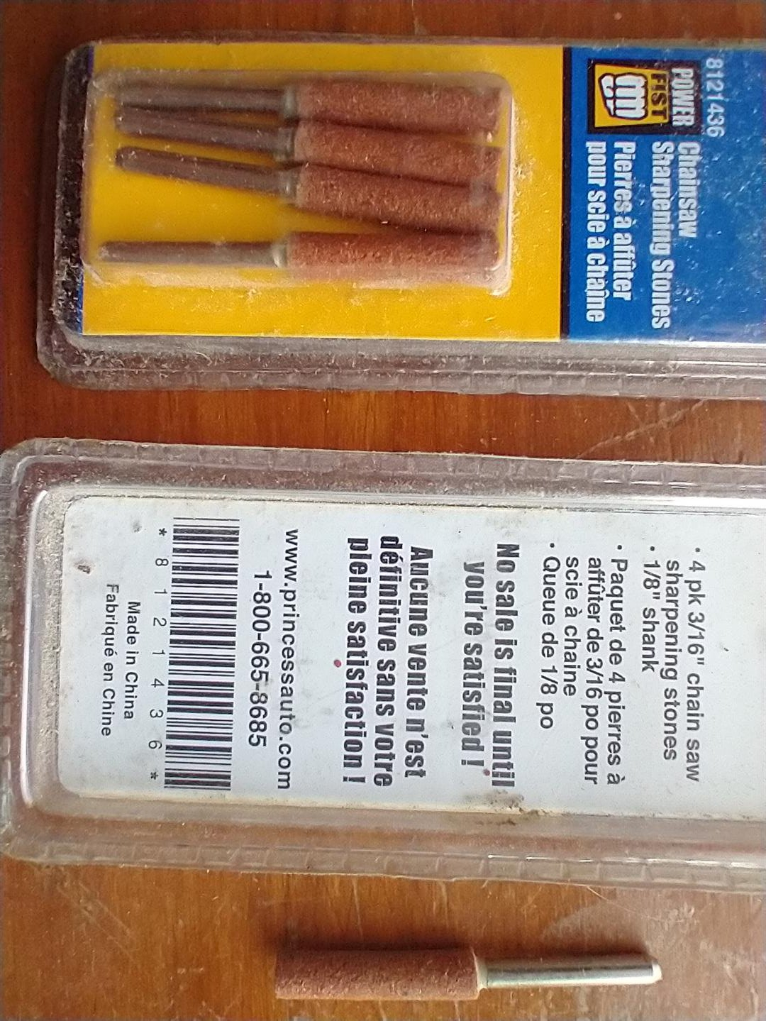

I bought a similar unit a while back, mine ran on 110V, not battery. I think I was halfway thru when the grinding stone broke. It only came with one of each size, so I finished it off with my old clamp on sharpening guide.
Any suggestions for bits for the dremel-style sharpeners that stand up a little better? Reviews were all over the place on any I looked at on Amazon.
As far as the file occasionally catching on a tooth, that happens to me sometimes too. Usually if I'm trying to go too fast or pressing a bit too hard.
Hi Oaktree,
I also had trouble finding good grindstones for the Oregon sharpener. The 3 stones Oregon supplied with their sharpener (3 sizes) worked great, but the Oregon stones purchased later turned shiny on first use because they had no grit, but they would never break. They were too hard.
Then I found great gritty stones at Princess Auto here in Canada and bought a lifetime supply. Unfortunately, they stopped selling them because the gritty texture resulted in a weaker stone that would break when not gently applied. It helps to use the outer tip more on a new stone so the inner section of the stone has full strength. A proper gritty stone should sharpen a chain ~60 times.
A rule of thumb is to cut a cord of wood and saw it into 16" firewood- then sharpen. If nothing damaged the chain, about 3-5 quick strokes on each tooth will bring back sharpness. Sharpening both sides of the chain from the right side of the bar (the Dremel turns clockwise) causes a small burr to form that can be felt with the fingernail or seen with young eyes. Then it's crispy sharp and ready for the woods again. It takes about 4 minutes to bring a chain (on a 16" bar) back to the state where sawing wood is fun.
Sorry I can't offer a present source of gritty stones for a Dremel but surely someone offers them? A good stone needs to be gritty but fairly strong. That's a difficult thing to search out with Google. Perhaps your local chainsaw repair shop has a source for good stones. A good stone should scrape the fingernail similar to a good nail file. I attach a photo of the discontinued good stones from Princess Auto that might help. Princess Auto does sell a similar "looking" stone on their website today. It might be worth a try. Search "princess auto chainsaw sharpening stones".
Thanks for the info. I picked up a 3-pack of similar-looking stones last week at HD, we'll see how they work out next time I need to sharpen. Good idea on using the tip first so if it does break/wear you'll still have some stone left.
I'm sure I need to work on my technique with the dremel too, always used a file before.
