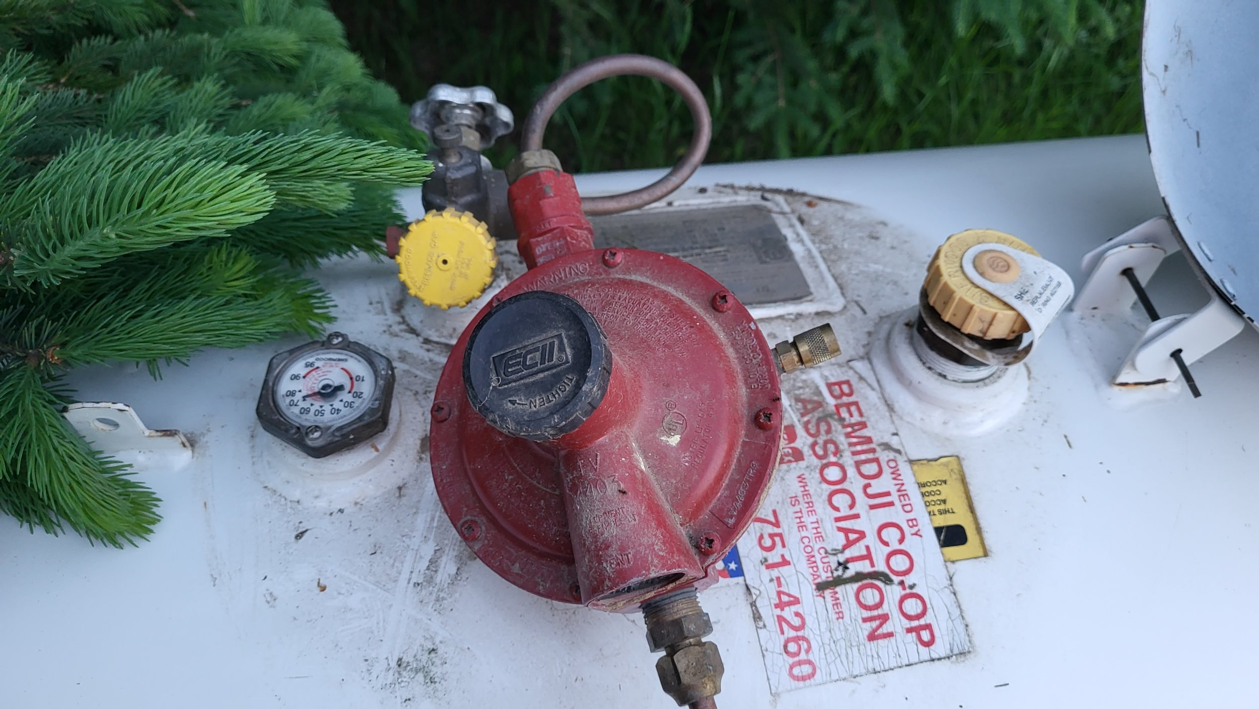

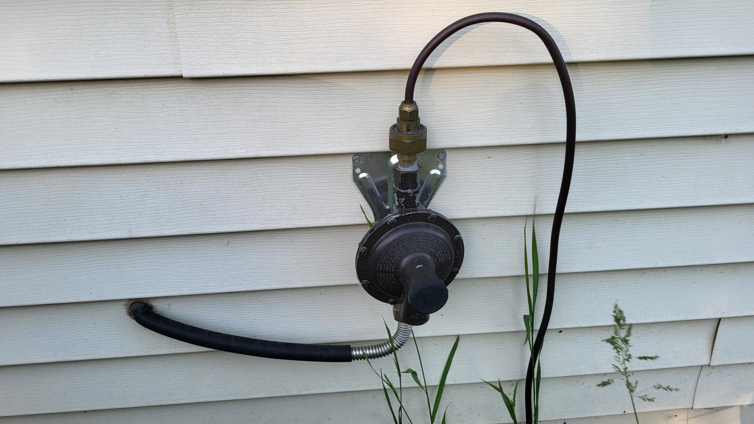

/ Propane questions #24
the red regulator at the tank is likely delivering 5 psi to the house regulator. The house regulator in turn reduces the 5 psi to 11' W.C. propane appliances operate @ 11 ''W.C.
So if you're connecting that generator to your home line. You need to connect to the outlet of that second regulator at your house.
It takes approx 27'' W.C. to equal 1# of pressure
Of course, I would check gas pressures before connecting

There are also distances from "an ignition source" and house windows and doors when installing a regulator vent. Again, it all depends on geometry and distances. You'll probably find they will want to tap into the line between the 2 regulators - again depending on how your site is set up.

I'd like to thank everyone for their contribution. I'm sorry if my post caused issues between members.
Thanks to all of your comments, I now feel confident I can discuss my needs with my local co-op and be able to engage in a meaningful conversation.
Some additional info:
1. My existing tank is about 50' from the house.
2. The location of the existing regulator mounted on the house is less than 15' from the power entry panel where my generator power cord is attached. As such, I could place the generator anywhere in the near vacinity of the existing propane installation as the gen's power cable is 20' long.
3. A complete and dedicated regulator comes with the conversion kit for the generator. Yes, there are other parts included in the kit other than the regulator so that the propane can be introduced into the carb correctly.
4. We have, thankfully, very reliable power from my electric co-op. We may have as much as 1 outage per year and it rarely lasts more than 30 minutes. However, I live in northern MN and about every 10 to 15 years, we'll have one heck of a windstorm that will lay trees down, etc. While I have buried utility lines, issues many miles away can easily disrupt the feed to my part of the county. It's been 10 yrs since the last big blow and I'm thinking it is getting to be that time again.
5. Because of the info in #4, it's not likely I will get a dedicated tank for the generator. As it is now, I fill my 200 gallon tank about once every 3 years. Yes, I did say I had a propane furnace but I didn't say I used it. ;)
6. Given the cost of the propane conversion kit and labor to install a safe and reliable feed for it....well, I'll have to weigh that decision a bit more.

It should be a pretty easy install for the LP company. Install a tee with a shut off pointing towards the regulator and install a quick dis-connect after the second stage regulator before it goes into the house. You have CSST going into your house so there is flexibility Make sure the quick disconnect does not have an excess flow or if it does it should be rated at 25% great than the generator BTU load at full fire ( when it starts up ). What size LP tank did you say you had ?
