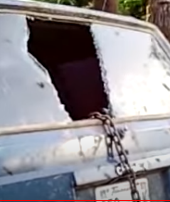

I've not experienced a chain whipping, it pretty much just drops. Now wire rope, that would be a different story.
A chain can definitely "fly", but I doubt it'll gain aerodynamic properties like a flying cable can... but it can go rapidly from the break point which can result in upward motion
Here's a worse example - screenshot from (
Note in both of these cases, they "jerked" the chain hard.
I suspect in most cases of a properly used chain (no jerking) that the chain will just drop flat, but it's definitely worthwhile to blanket or otherwise limit the ability of a broken puller (chain, strap, cable, rope) from flying.
