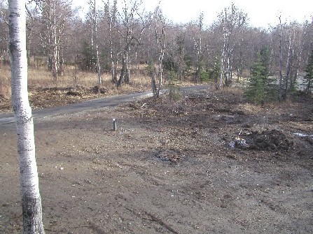

PK, just wondering what a "removable tooth bar" does. Like you were, I am now just about sold on the BX22 for clearing and maintaning my 5 acres. Will that implement help get rid of all the scrub birch I have on my property. The moose keep them from getting tall but they are really hard to get up. I also am concerned about clearance so have attached a photo of what my front looks like. The back is thicker, what do you guys think.

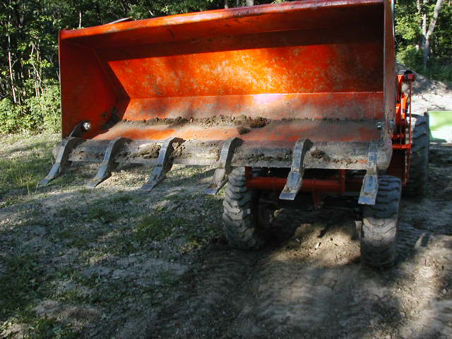

remvable tooth bar is very handy for clearing brush, goes on and off in 2 minuets. attached is a pic of toothbar on my 2400
