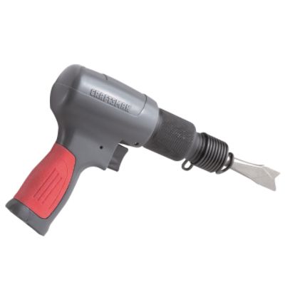

You could buy them from Tractor Supply. I bought 250 last year and over half of them fell off before I got them in the ground. I had to tack weld them back on. They are much needed in this area. The best way to get them off is to lay them at a 90 degree angle over a log. Stand on the t-post and use a air hammer to force the plate off. Good luck.
   / Removing PLATE or ears on T posts easily #13
Use one of these air hammers to strip off the plate.
