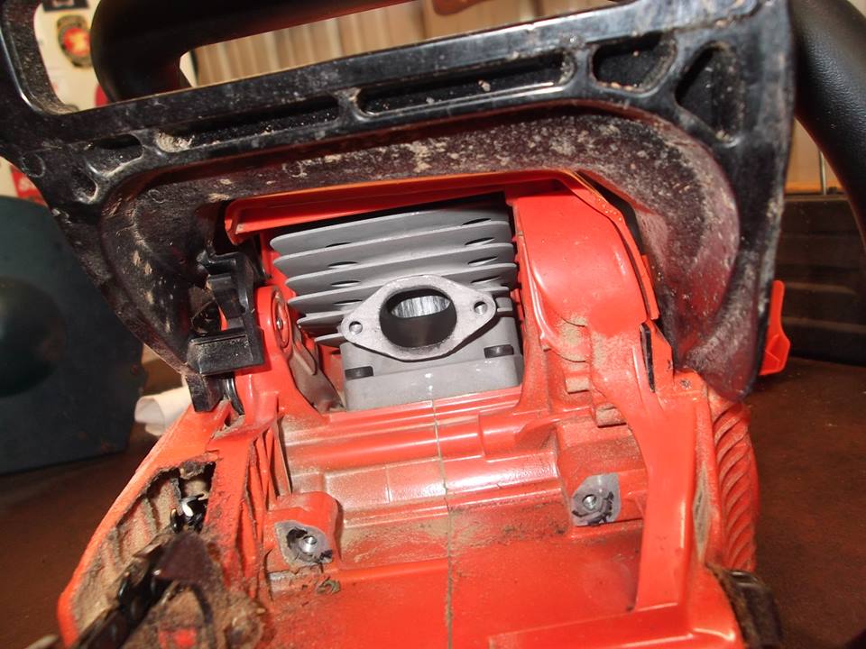

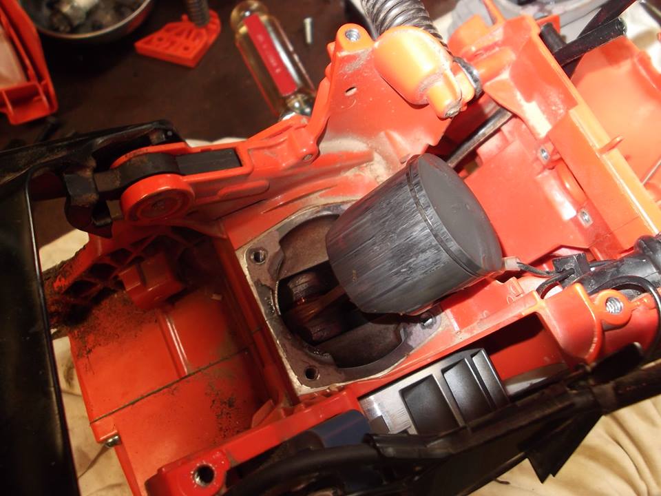

Last few pages about a 590 I got from a guy that bought new. 6 months it was scoring itself from being to lean from factory. http://chainsawrepair.createaforum.com/echo/cs-590-wolf-review-bone-stock/
IMO keep saw and either tune yourself or take to another dealer to be checked for tune. 590 likes it fat, in low 12's to be safe.
Heck start the sucker up make some cuts and see where your tune is even at. You might get lucky and be close and not to lean.
Now the last 400 in the other day that was bought new was pretty close to be right from factory. So you might get lucky.

What to lean from factory will get ya. 6 month old 590 I bought from original owner and wanted to muffler mod it. Only then was it noticed.
In thread I posted above.
   / Return unused Echo and buy from a better dealer? #20
Most folks into chainsaws understands that that lingo just fine. ;)
Fat = on the rich side of settings.
low 12's = 12,000-12,400
View attachment 621164View attachment 621165
