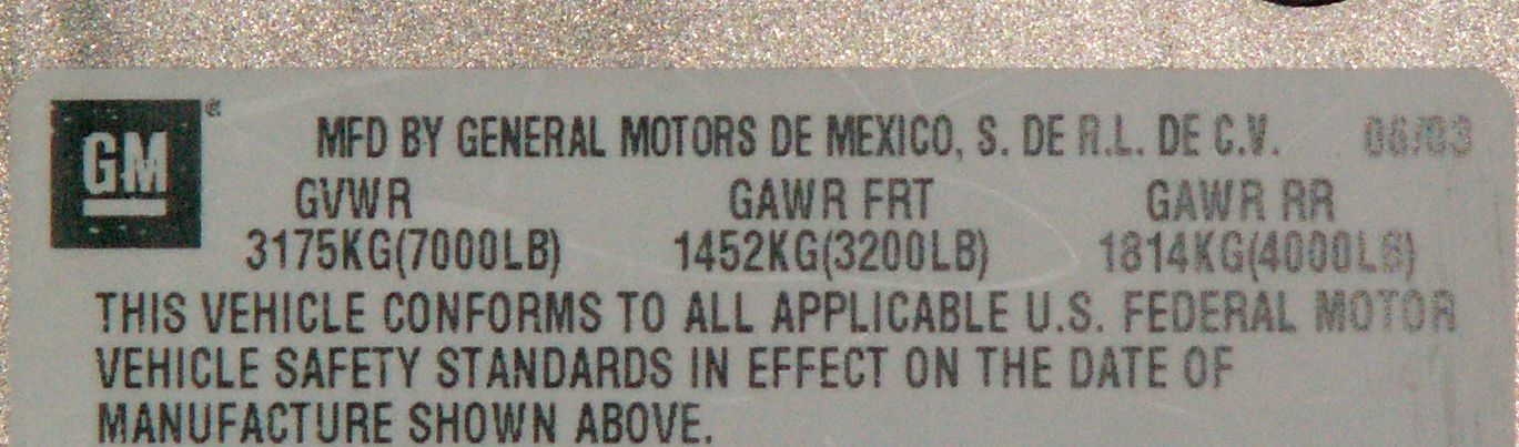

Can someone show me how much I can haul with my suburban. I'm gonna have my nephew build me one a 20 footer bumper pull. Have a pic
The towing rating should be in your owners manual and be careful if 4 doors, 4 WD etc and auto or standard shift, they all make a difference
Called my buddy who has a 2003 Yukon XL, same truck as the Suburban. He looked in his book for me and said if its a 5.3L it has a max of 8,100# if its 4 wheel drive and 8,400# if its 2 wheel drive. These are the max ratings. If you have lots of options it will take away from the tow rating. One thing he is to be careful of is the hitch itself. Make sure you observe the limits of it.
Chris
I remember GM running an ad a few years back aboutnewer Suburbans rated to tow in the 12,000lb range, but I think the newest versions may have been reduced to 9,300.
Specifications: Suburban: SUVs: Chevrolet
I was assuming his truck was the 1500 series with the door sticker info he posted and all that year had the 5.3L I believe.
I believe that high tow rating was in the 2500 series 6.6L and 8.1L 2 wd. I have a friend that has a 6.6L 2500 2 wd and it does ok towing a 10,000# boat but nothing like our current trucks will do. He has been through 2 injector pumps and they sure are expensive but the truck has a 50 gallon tank and does 20mpg so it can be nice on long trips.
