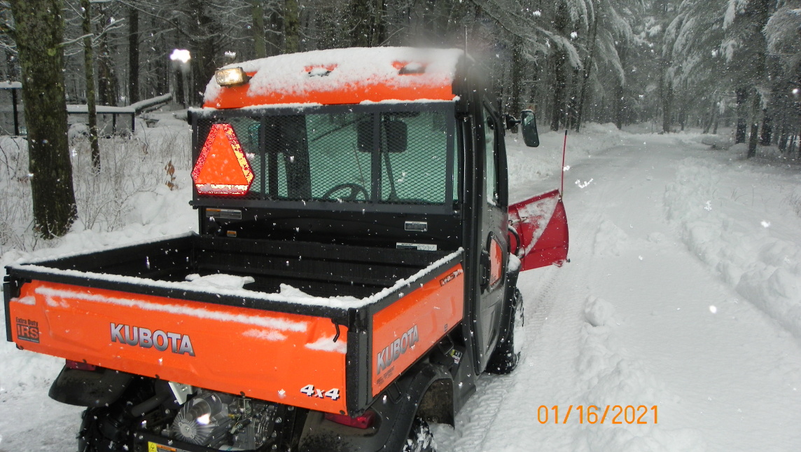

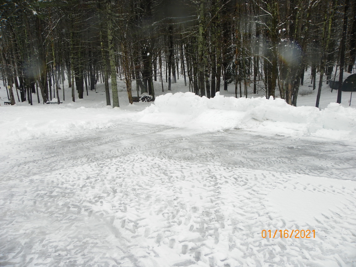

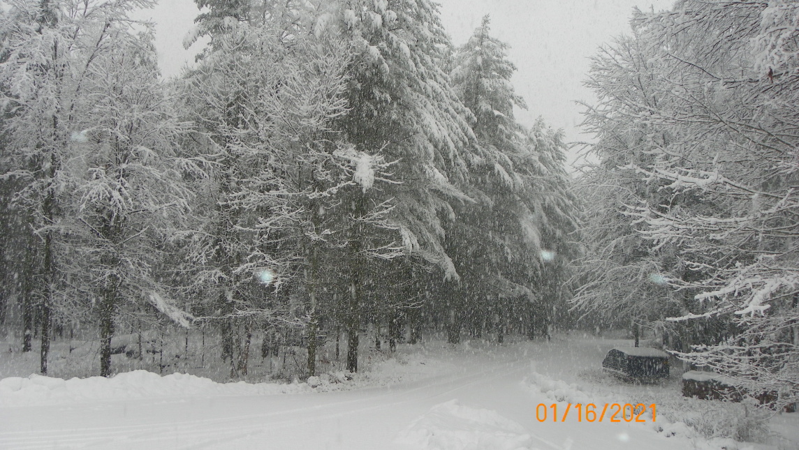

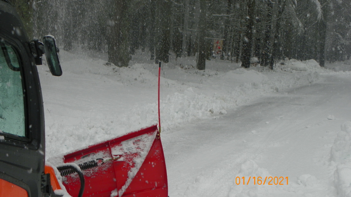

It started raining last night around 7:30 p.m., when I looked outside just after 4:00 a.m. this morning we didn't have any snow so I went back to bed. When I woke up we had some very wet heavy snow with rain underneath.
I had always heard the RTV's can push snow so I started plowing with it in low gear and 4 wheel drive. I have about 240 or 300 pounds in the back and it handled everything. After I was done plowing the driveway, I used the Mahindra 4540 to push the banks back before they freeze solid with the colder weather coming in.

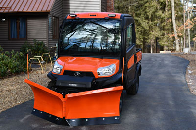

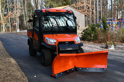

New RTV-X1100C delivered yesterday with the V5293 4PT Hitch / Power Unit and a 78" V5295A V-Blade. Plus some LED light kits, mud guards and a grill guard adapter kit for the summer when I take off the plow and power unit.
Got to use this morning on about 4" of new snow - drives much smoother than my old 2004 RTV-900W with a 72" blade.
Did find the shifter balky to use - hope that gets easier when broken in.
Also installed a cheapo radio from Amazon - it works - but diesel is noisy even with the factory cab so better for talk/news radio than music - maybe the Bluetooth phone will be useful but haven't tried that yet.

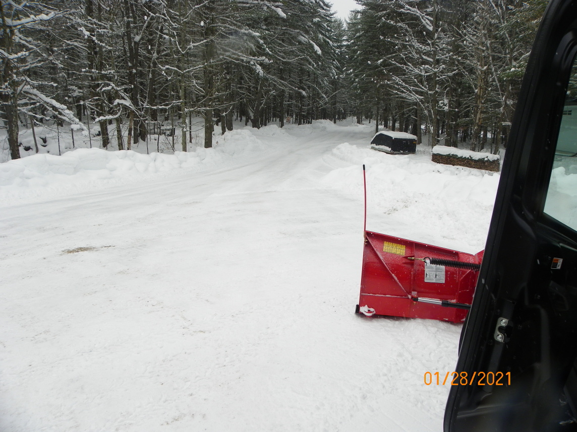

I did some plowing today, first I did the driveway and then a bunch of walking trails around the house.
Picture 1429 is me stopping to grab some CD's from my truck just before heading down to plow the neighbor's driveway,1428 is the lower part of the driveway, 1430 & 31 are some of the trails I plowed and the last two are some deer resting under some white pines.

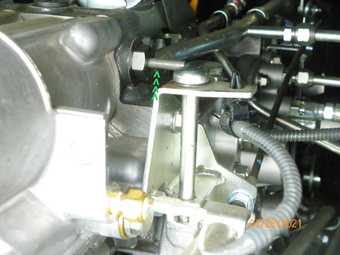

The shifting will get a little better over time, but it's very important that the HST pressure release valve actuates properly when you push on the brake pedal. It releases pressure from the HST to take load off the gears so you can shift. I had to adjust mine once or twice to get it right. The adjustment procedure is given in the owner's manual. At least in the 2015 owner's manual, the instructions were a bit confusing with a few mistakes. But if you look at the mechanism, it will be obvious how it should work.
I sprayed some WD - 40 on a paper towel and wiped down the rod that pushes in when you step on the brake, it shifted better after that.
Do you or can you get a pic of the adjustment you're talking about?

There is a cable that causes that lobe-shaped "cam" in your picture to pivot and push that plunger in when the brake pedal is pressed. You can adjust the cable so that you get the desired amount of motion of the plunger. I had to adjust mine -- I suspect the cable had stretched so it was no longer pushing in the plunger very far. Once adjusted it made a big difference. In the owner's manual they give some dimensions to check the plunger range -- the numbers were out of whack in my owners manual from the fall of 2015 (very obvious typo) and I wonder if they have corrected it by now. I had to work it out by trial and error.
