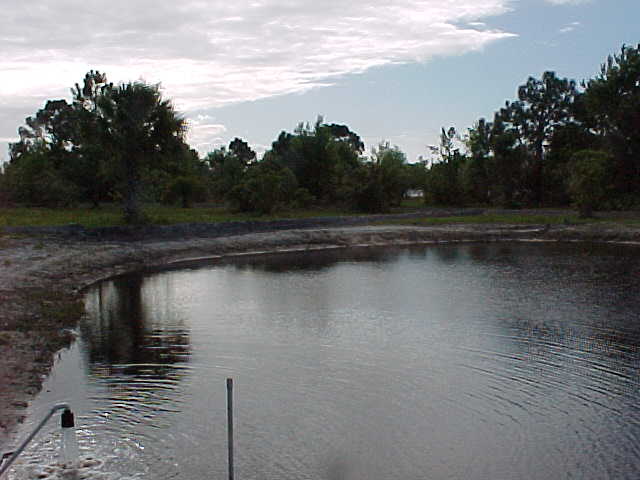

Here's a picture of about half the pond so you can compare the volume. Overall, the pond is probably 12' deep. Once the pond is full, it only takes a couple of hours per day to keep it full in the dry season. During the rainy season, like now, the well water is not needed -- the problem is keeping it from overflowing. I can't imagine that yours would seep out any faster than ours in our sandy soil; I can't imagine having to run it all the time after it gets full.

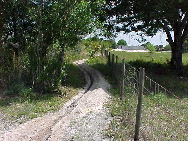

Here is some of the trench I dug; this is near the well; the pond is w-a-a-a-y out and over to the left.
