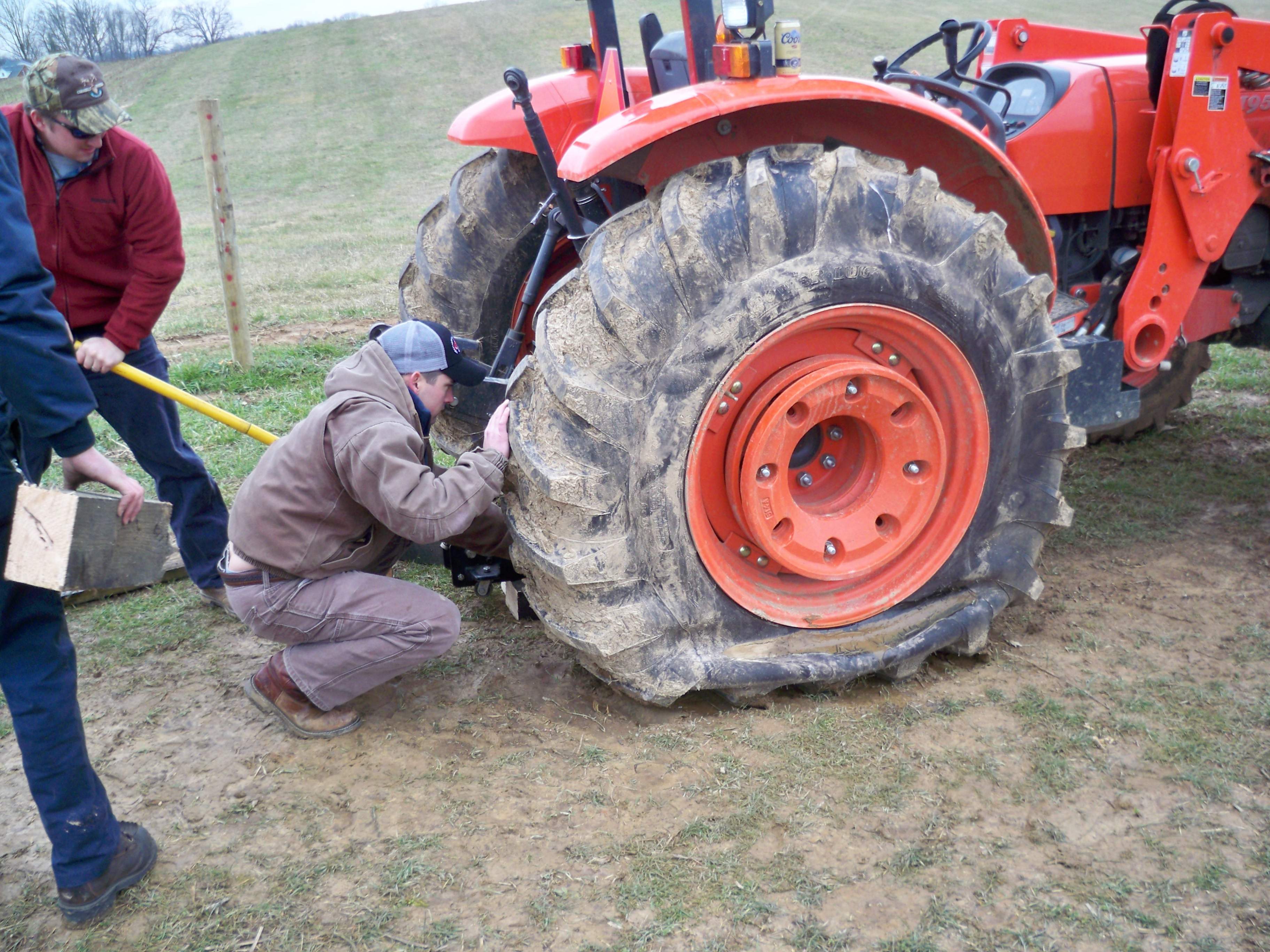

Something terrible happened to me this week. I was driving near a old fence row that I had torn out and I ran over something very sharp with the rear tire. It went flat in less than two minutes and I lost almost all my fluid. The tractor has less than 150 hours on it and I think it is too big to patch from the inside. :( I d@mn near cried.
I'd patch it. Pack the hole full of rubber cement, push the rubber back into the hole from the inside, then stick on a patch. Then, stick on another bigger patch over the first one. Done. Do it yourself too - probably cost less then $10.
If you're sticking with the loaded tire thing, I'd consider putting in a tube.
Those big rears are super easy to work with. Once you get the bead broken (I have a bead breaker, but was able to pop the beads on my rears by just jumping on the sidewall), they come off and go on like buttah.

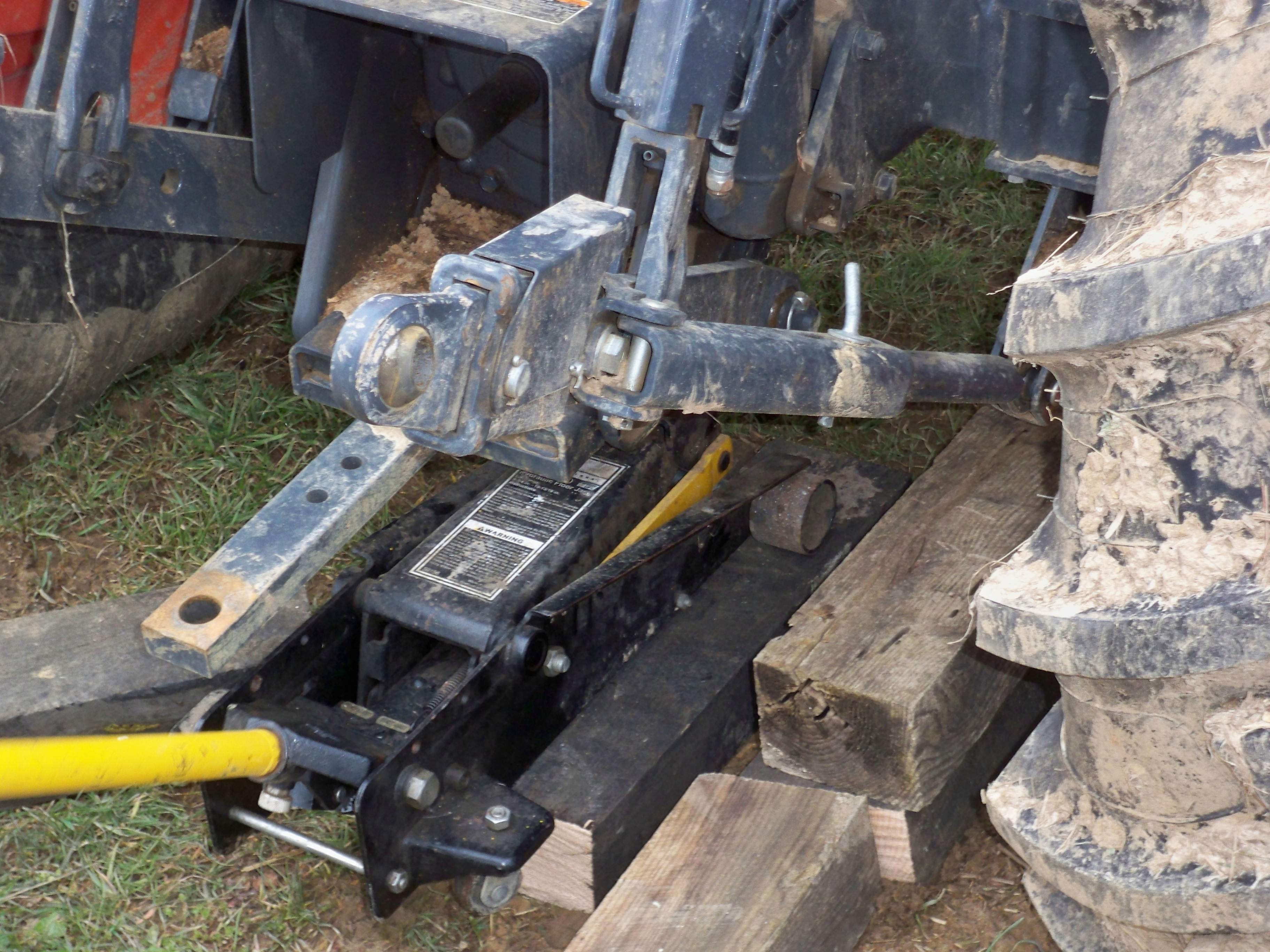

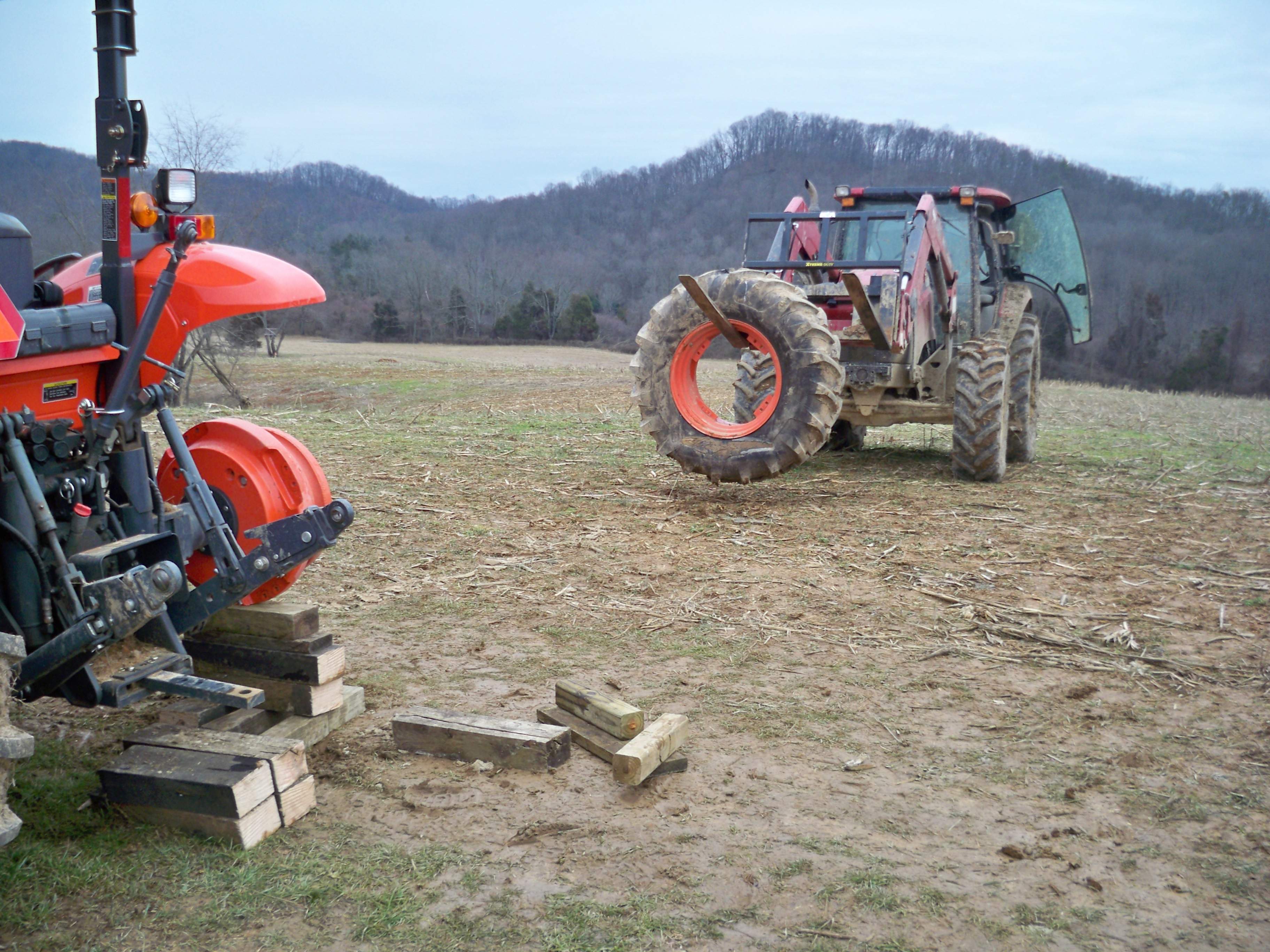

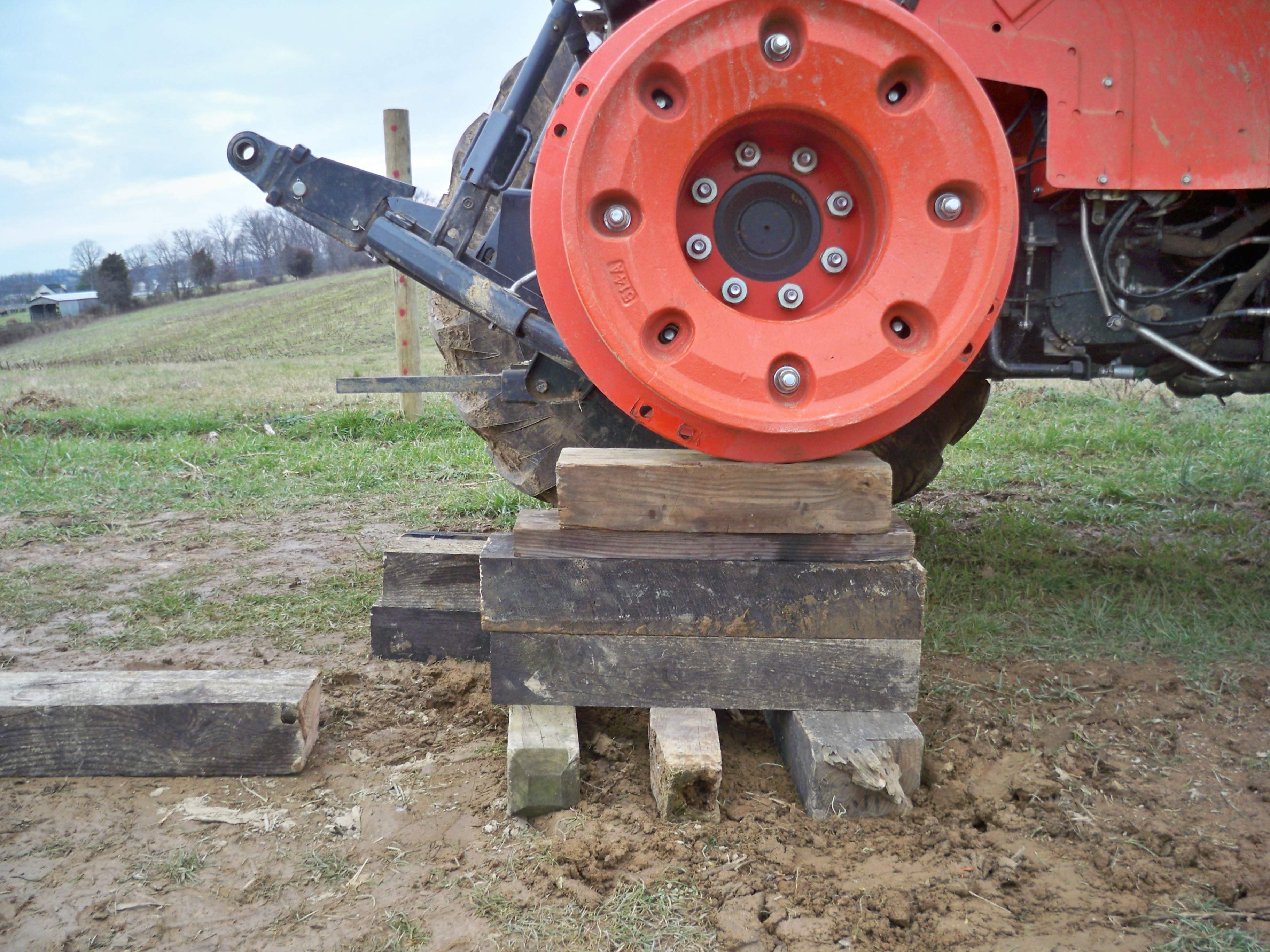

Well we got the tire off Friday. It was not as bad as I thought it would be. I still couldn't have done it with out help from friends though. :thumbsup:
I must say the worst part was crawling under the tractor with a huge ratchet and extension. Oh and finding enough room for the cheater bar. Those nuts were on just as tight as they could be.
After all that was said and done I went to the tire shop. The guy I had been talking to was out for the day. The guys that were there only deal with big trucks so they couldn't tell me what they thought about fixing it. The other man should be in on Monday to tell if it's fixable. Fingers crossed!
