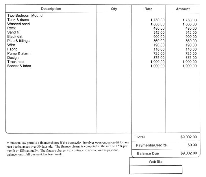

Just had a septic put in last week. 1,500 gallon concrete tank, mound sized for a 2 bedroom home. The county really is not to concerned about septic's; it was the bank that required it for buyer to to get a loan. Total cost $9,002.00.
